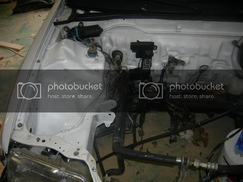

I've finished the drivers side!
I've got a few more wires more wires to run then I can start putting body parts back on.

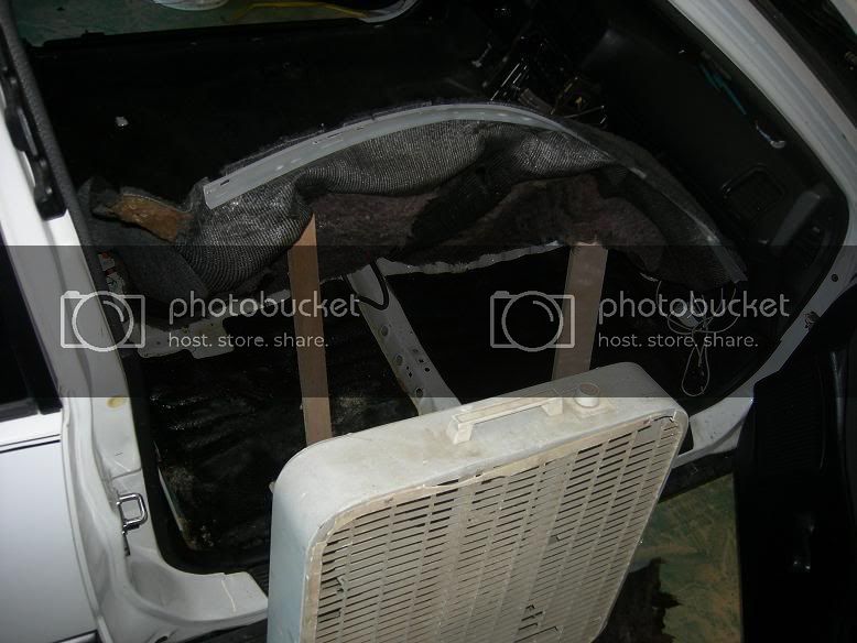

Oh, and this sucks:

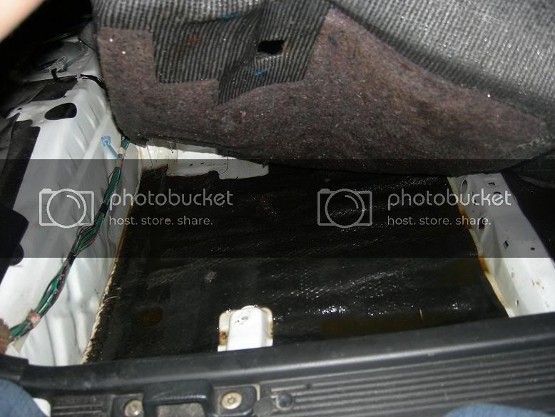

I noticed my carpet in front of my passenger's seat was wet. I inclined the seat forward and found this:

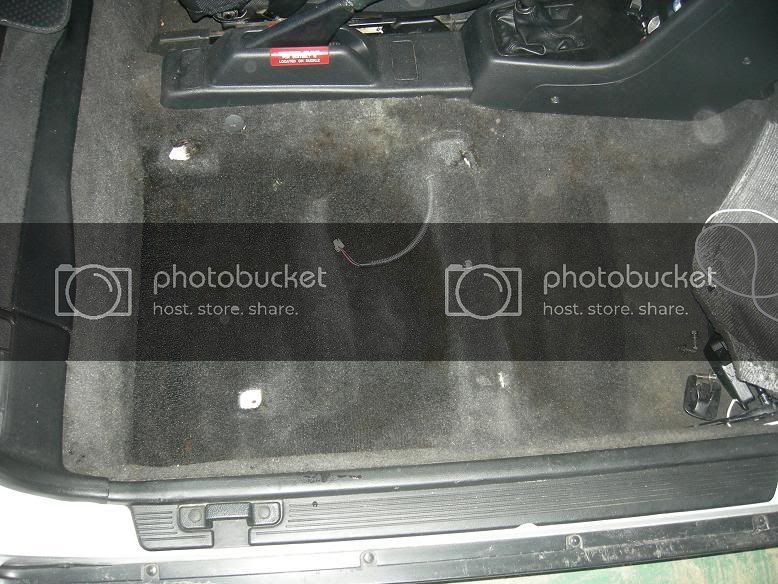

So I ran the vac over it few times:
Then put a fan on it. (I'll leave it on there over night)
I just sure hope it doesnt mold!
I'll do everything I can to prevent having to get new carpet.
Anybody have any suggestions on what to do?
Well first find the cause... On old Hondas 99% of the time its the sunroof channels being clogged, or a leaking window because of rotted moulding.
Nice Flashlight. Ryobi 18v FTMFW!
I'm thinking it's the door moldings.
The sunroof area has no water around it.(none of my headliner in for that fact)
Thats the ONLY wet spot on my car.
And yeah, these flashlights rock!

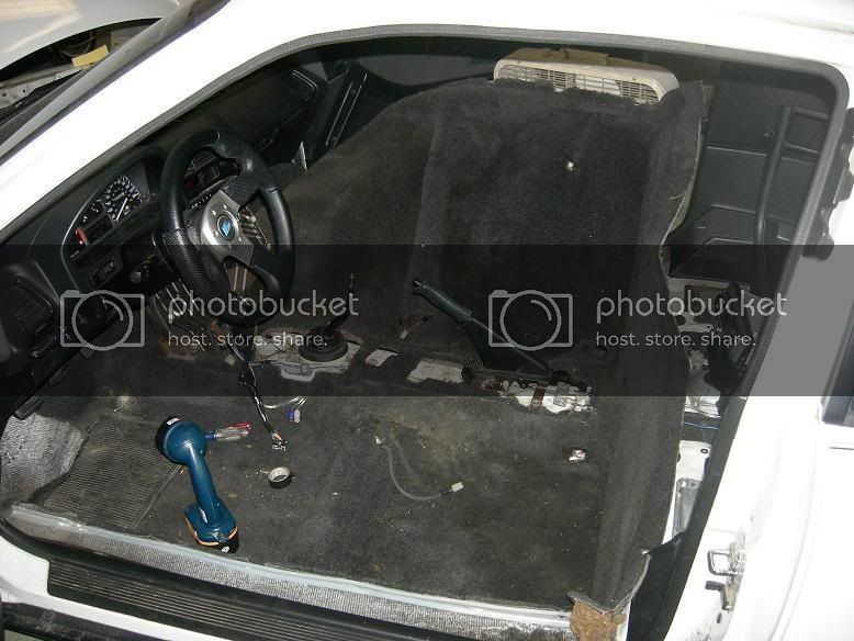

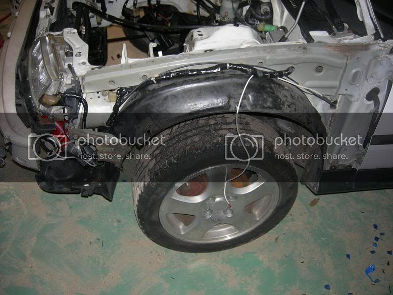

update 9-21

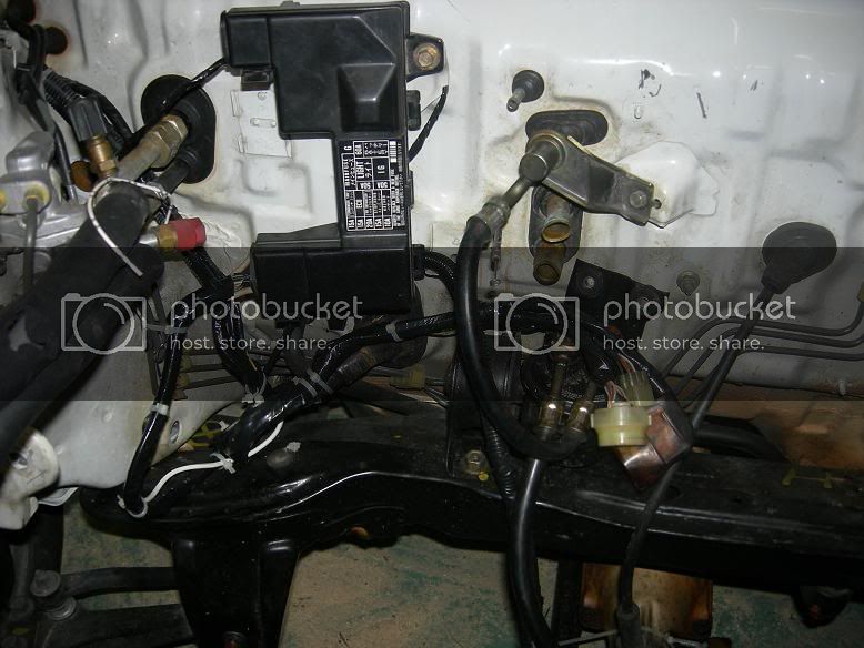

Officially finished the drivers side.
And the fusebox. I know it doesnt look very clean in the pics, but I believe the trans will hide most of it, and it's all very secure.

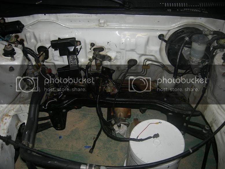

now pain the engine bay white again for a new clean look. That minor rust sticks out pretty bad
Update 9/22
Way ahead of you Abel!

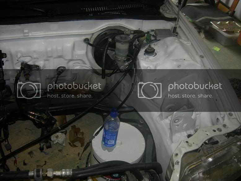

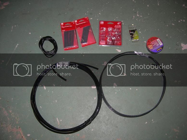

Picked up some equipment to do the battery relocation(and some other needed things)
For refference, I'm useing 4g wire for the main battery wire, and 6g for the fusebox(which I'll just be splicing off the main one in the engine bay.)

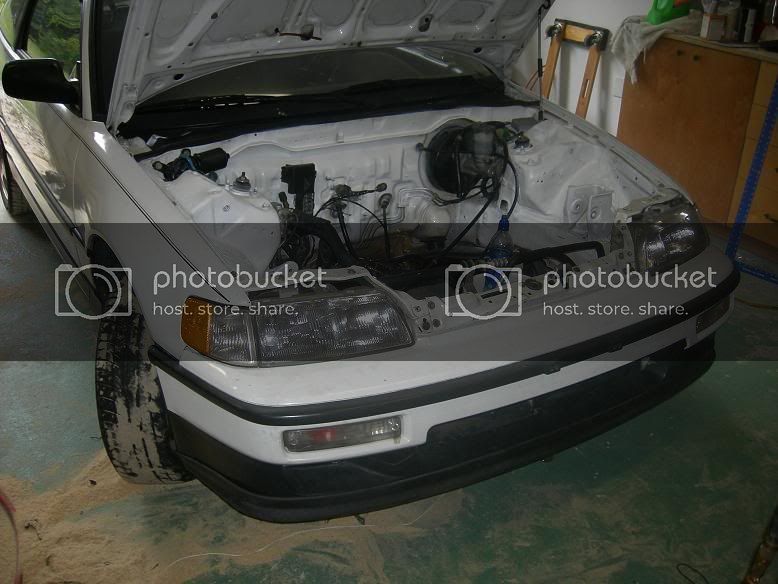

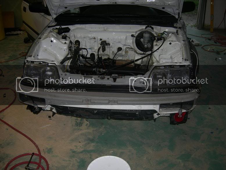

Then I put all the body parts back on:
Then I painted the engine bay(mainly worried/focused on the wheel wells and the top of the firewall, since thats all you really see.
I ran out of paint so I couldn't paint the T-bracket and headlight brackets (was NOT a full can. Just something I had laying around)
well, I think for it being my first tuck, first time ever wiring on a car, and with doing it differently than just about everyone else I've seen, I think I didn't do half bad..

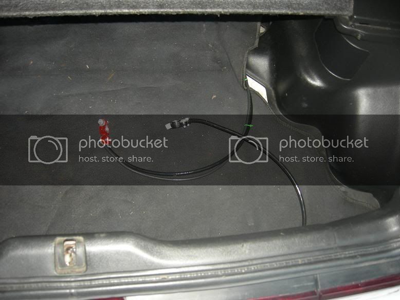

Finished the battery relocation(4g wire for starter and 6g for fusebox, purchased at Lowes(refference)).
And just for fun:
After I installed the battery I turned on the car(accessory) and checked the headlights- THEY WORK!! YAY!!!
That means I didn't screw anything up! woot!
