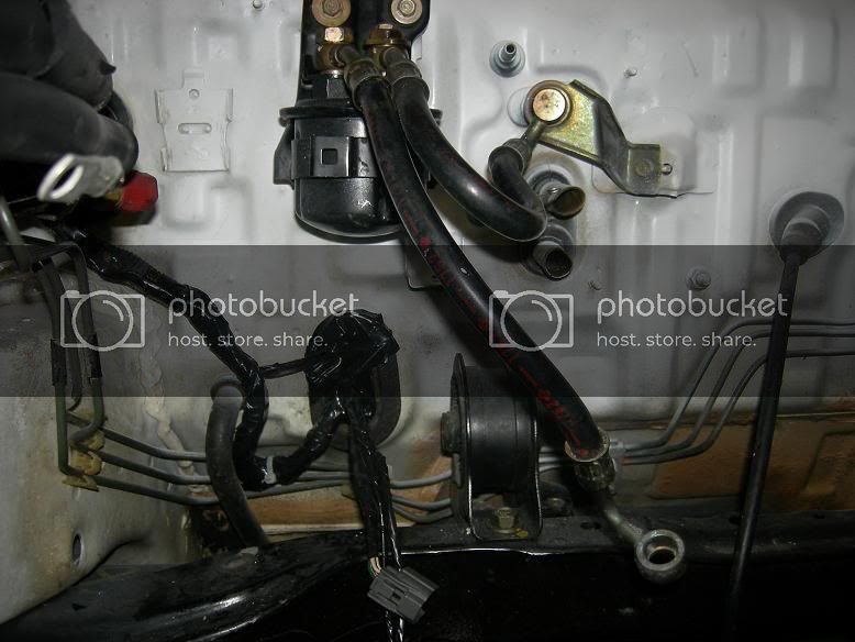

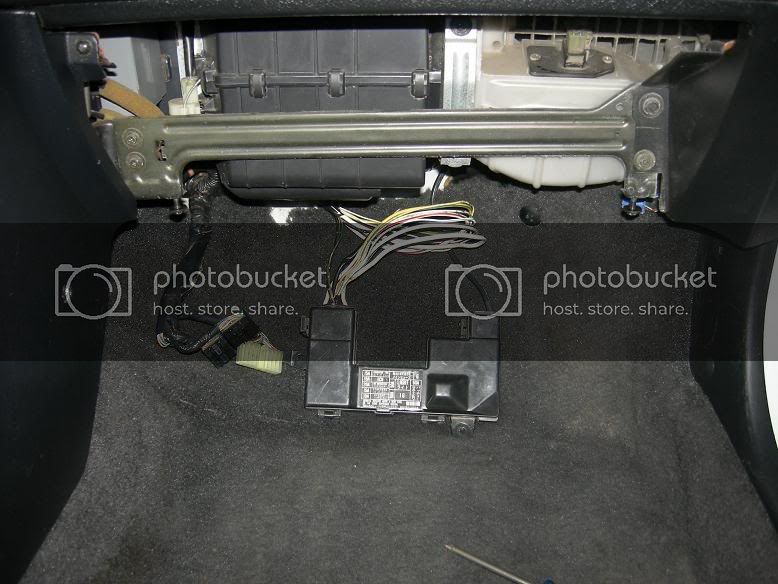

Update 9/27:

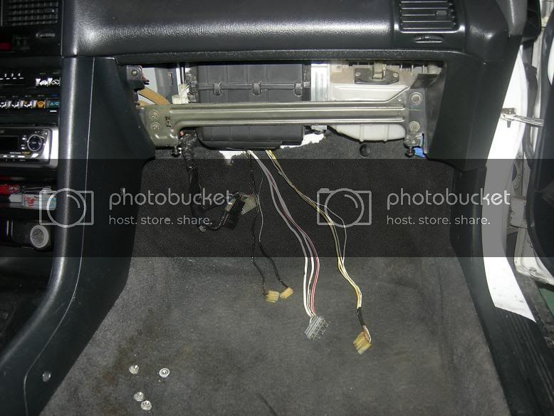

This is how my fusebox was located.

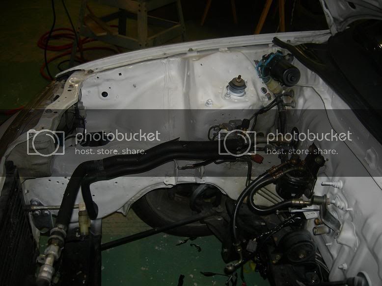

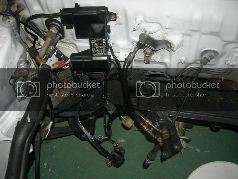

And I decided I didn't really like that location. It didn't really seem to satisfy me as far as the looks of the Tuck. So I did this:

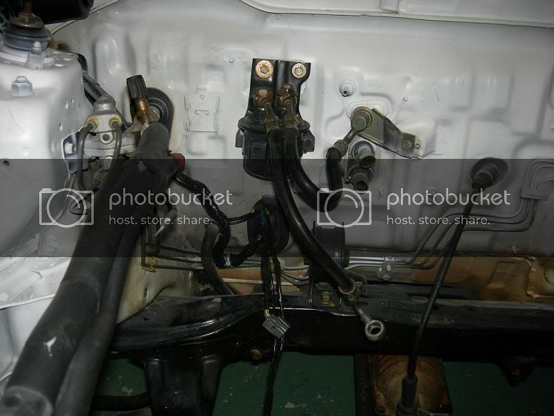

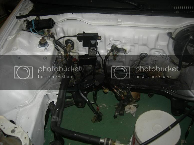

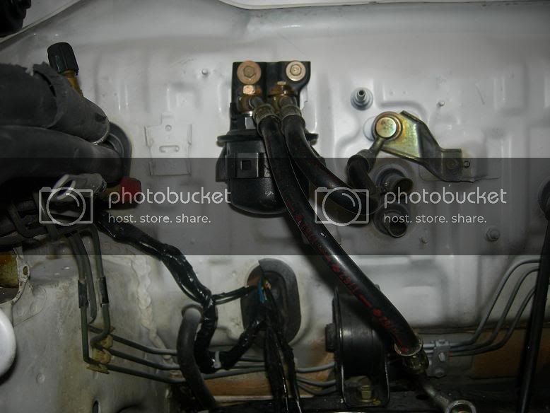

And it yielded this in the Engine bay:
Then closed up the gromet(will have to open it again to install the Engine harness, but o well. thats about 2 weeks away). And it looks better at different angles. it's nice and tight.-

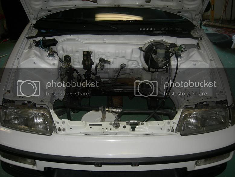

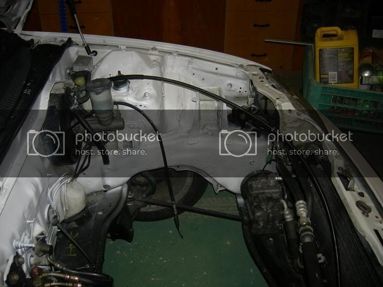

Heres a shot of the Engine bay now.

No comments on my fusebox relocation?

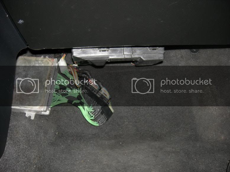

I don't really know what I'm gonna do with my ECU.
I think it'll just sit there for a while.............
Wire tuck looks sweet man. Try mounting the ecu under the passenger seat. Isn't that where they are stock?
No, the ECU is under the carpet in the foot well of the passenger side....
Yea, i wasnt feeling the fuse box location... but glad you moved it.
yeah it looked kinda wierd...
And it wasnt that hard to move it... at all...
I'm really happy with how it turned out. I can't wait to see what it'll look like with the motor in.
wow, nice relocation of that fuse box.

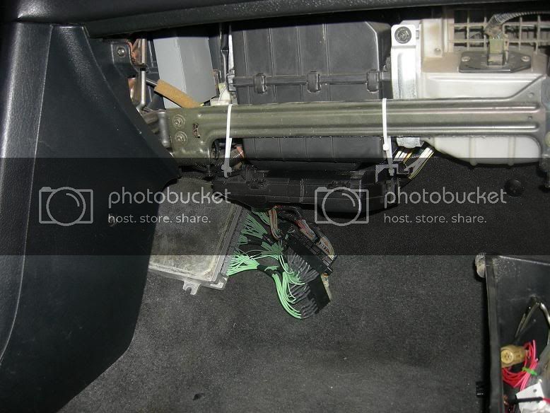

and whats the problem with hiding the ecu? just shove it under the carpet where it was.
Well, because under the kick panel(gold thing), at least for now anyway, I've got the engine harness under there, so my ECU won't fit.
Plus for some reason the P28 doesn't really bolt up to the stock 4 studs on the floor board. only the bottom 2 do. ?
Anyway. I'm sure I'll find a place for it, but thats where it's at for now.
I've got about 2 weeks until my motor arrives, so I've got plenty of time to figure stuff out.
I was referring to the kick panel. I meant that it didn't want to line up with all the studs that are used to hold the ECU down.
Its just sitting there for now. I don't plan on leaving it there...
theres no problem with leaving it unbolted. just have the covers on it and should be fine. my ecu is just laying there. been laying there for all summer, lol. random tuning ftw!
Yeah I might leave it for now.

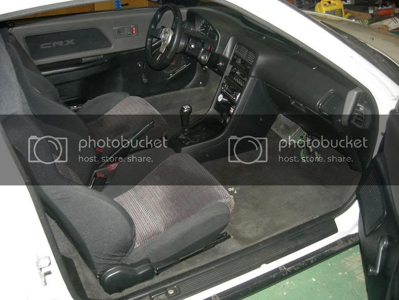

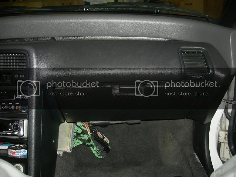

Heres a Quick Update:
Put the glove box and seats back in. I also took a couple more pics of the engine bay.
:thumbsup: looks awesome man.. i'd paint the spot near the headlight, it sticks out like a sore thumb
The headlight brackets?
Yeah, I ran out of paint! lol.. I know that part looks like garbage compared to the repainted stuff..
I'll get some more paint and do the entire bay again.
