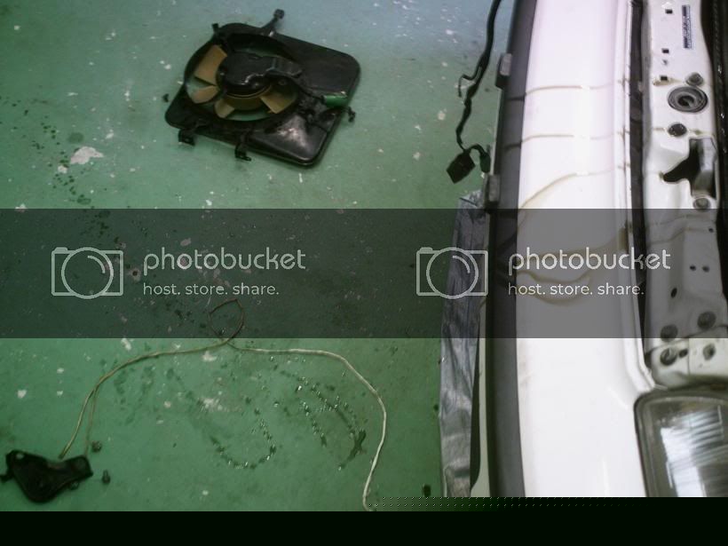

2. Unbolt your header. I had to pull out my A/C fan to get it to clear the studs on the block.
