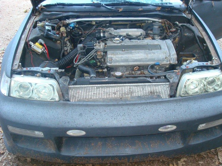

OKay, if you look in the pictures near the upper left of the engine, there is a metallic blue piece and a guage that reads PSI. It reads 0 when the car is off of course, but reads 5-6 when the car is idling. It's not connected to a turbo, so I know its not turbo PSI *plus you dont hear/see turbo lol* And it runs to some small black box and then has an outlet hose from there running to through the car. I have no idea wtf it is. I'll take a close up pic tomorrow and post. But if you have any idea what it might be, that'd be cool to know. Thanks.
aight thanx, I'll do some research to find out what a good fuel pressure is for this engine. Appreciate it admin.
Do u think its a fuel pressure regulator, or just gauge? I'd have to say regulator due to the fact it has an adjustor, hmmm Checking on this...
yesh, regulator, sorry. useless mod really... no need to raise fuel pressure. should be around 42 psi though, not 5.

The fuel pressure guage has 2 different sets of numbers, I was looking at a different one. The fuel pressure is 39 on idle. Thanks on that...;)
