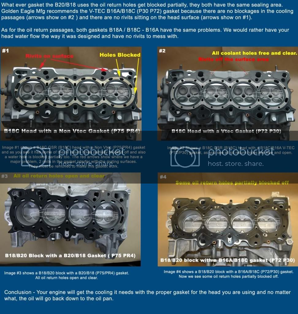

On a LS Vtec you use a LS head gasket. As for bearings I would also go OEM.
you have to pull off a few brass rings or else the head and block will not mate correctly.
you can also run into oil leaks if you do not do this.
Why do u say oem will it take the abuse that's a high rpm
Yep they will no problem. Done a few and seem a few high hp B series running stock bearings. IMO Honda OEM bears are the best and can handle pretty much anything you can throw at them. I have never seem a OEM bearing fail just because it was OEM. As for the OEM head gasket Honda uses a metal 3 layer stock so there is really no need for an aftermarket one like Greddy, HKS or Cometic. Just use a stock head gasket for the block you are using along with ARP head studs and it will hold.
No you dont. The brass rivets that hold the gasket layers together will not hit the head or block, they will hang out over the block and do not get in the way. I have always used LS head gaskets on LS Vtecs. I recently finished my personally LS Vtec used an unmodified B18B1 OEM head gasket with OEM GSR head bolts and I have no leaks of any kind. To confirm lay the LS gasket on the block and look at how it all lines up then lay it on the head and do the same. The brass rivet on the back sider clears the head and block just fine. Here is a pic comparing the 2 I also did this to compare myself, I have a perfectly good B16 head gasket because of it.
I know this pic is saying the opposite of what I am but I am sharing my experience and what has always worked for me. And if you are using a LS Vtec kit no need to drill out the dowel holes in the head and head gasket. If you use a Vtec head gasket you will have a oil leak from the Vtec oil supply hole in the head gasket. I have seen Vtec head gaskets work and I have seen them leak as well, I have never seen a Ls head gasket leak on a LS Vtec.
