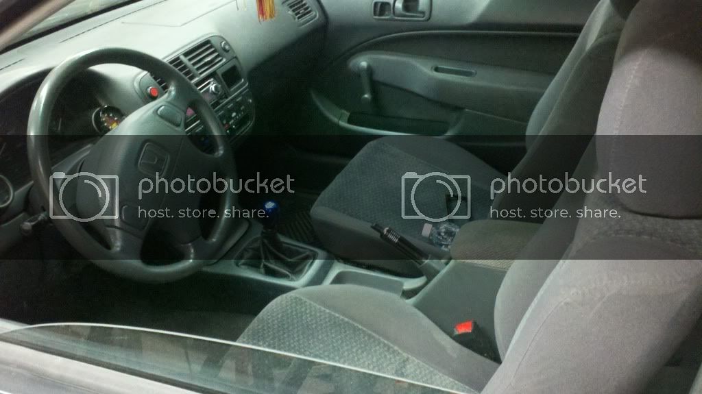

for those of you still watching this thread, progress is still being made
stock seats back in, interior buttoned up and clean.
