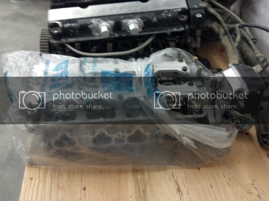

I found a couple of VTEC heads in the area, I am thinking I will pick one of them up over the course of the next week. I have been contemplating going LS-VTEC and I think it'll be a good move in the long run. The head will remain stock.
Picked up a GSR head with ITR springs/retainers, GSR cams, V/C that has -10AN bungs welded in for my breather box, a set of LS-VTEC dowels, and an oil line for the head. It has been freshly milled, only .002" taken off, which really doesn't matter to me because I'm already at a low compression ratio.
I plan to find a used aftermarket intake manifold and a throttle body. I'll re-use my fuel rail and injectors, possibly my TB if I cant come up with anything else. So, my LS head will be up for sale shortly.

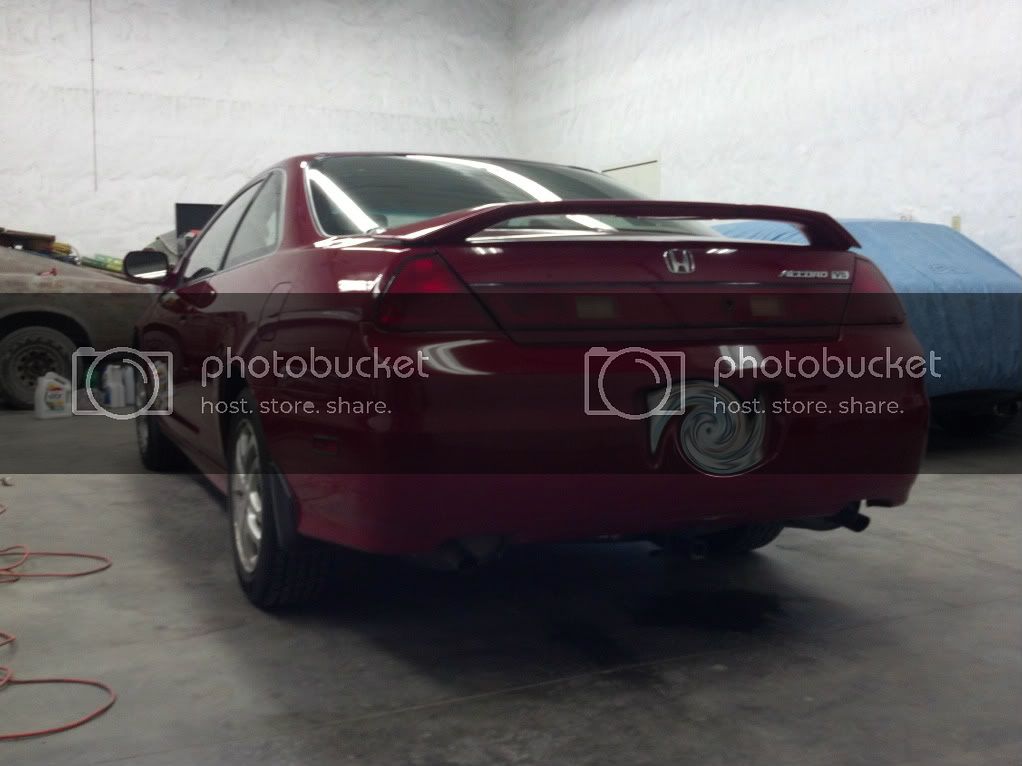

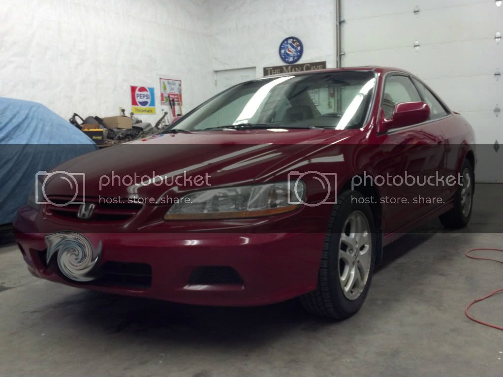

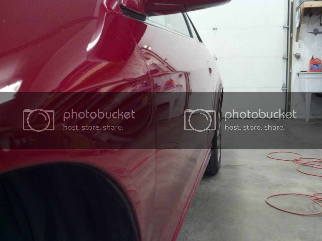

Got some pics of the new DD. I did a cut, buff, wax, and oil change today. I decided I am going to sell the maroon 4dr, and just keep this. Keep in mind it has 192k on it. The following picture is the reason why I decided to do a cut and buff (obviously a before pic)
Some shots after I finished.. cell pics:

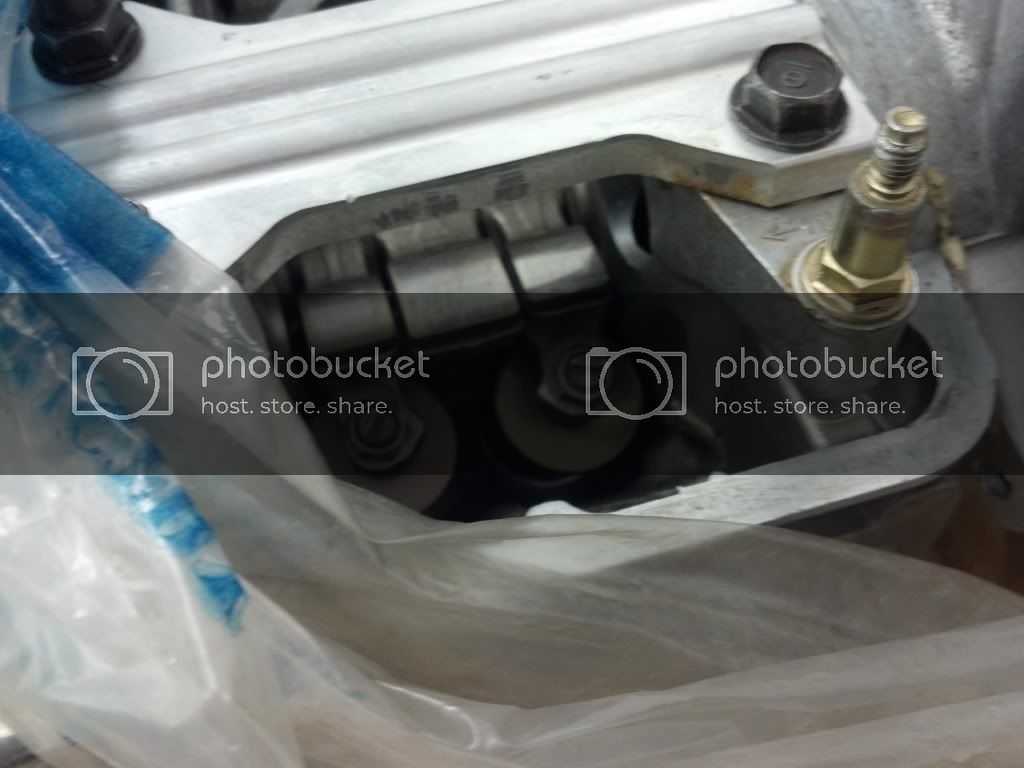

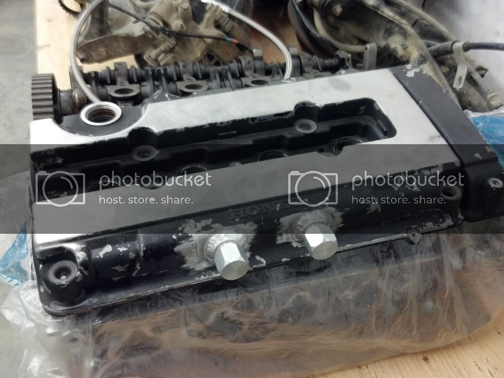

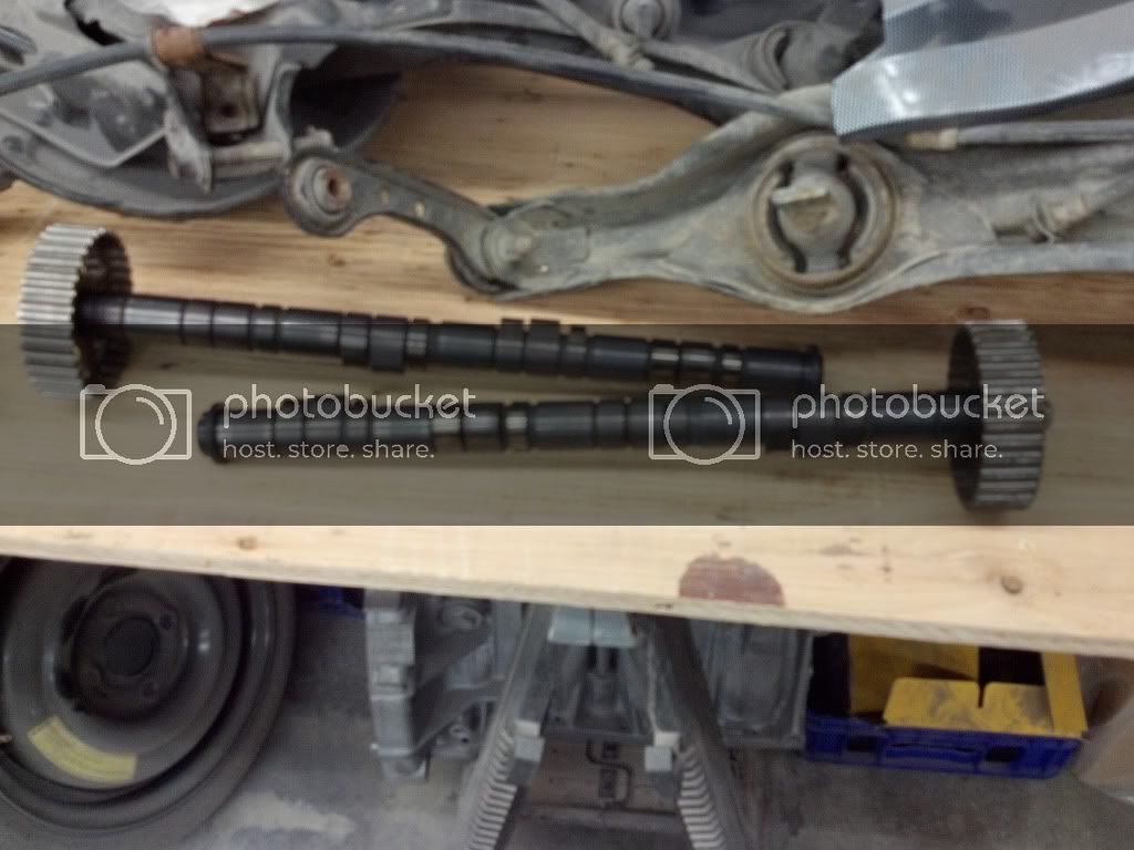

Also snapped a couple pics of the new head. 95 GSR head, ITR springs/retainers, GSR cams, VC is shaved and has fittings for my breather box.

It should be a noticeable improvement. Not to mention I won't be fighting the damn valve train when I try to set the timing :thumbsup:

Nice work! Red is a rewarding color to cut and buff, it always seems to make a dramatic improvement.
What do you use to cut/buff? How hard was it to learn to do properly?

I used the supplied pad kit (came with my polisher) and 3m cutting compound and machine glaze. I started with the orange cutting pads and 3m cutting compound, worked the whole car with that and then moved to the green pad with 3m machine glaze. After that I finished with a cheap ($4) bottle of Turtlewax. I applied the wax by hand and then used the white polishing pads to buff the car to the shine you see in the after pictures.
Cutting/buffing isn't too difficult; the most important part is to take it slow and do one panel at a time at first. Also, be aware of the age of the paint you are working with. Even basic washing will remove small amounts of clear coat over time, and when hit with a polisher the clear coat disappears a lot faster than you'd think. I start at the top of the panel and work my way down moving side to side with the polisher. I usually polish until the compound is worked into the surface (meaning there's not much left on the paint) and then let it dry to a chalky texture. Wipe it clean if needed, and move to the next compound.
Yeah, this is my second red car that I have polished (first was my maroon cb7) and I am happy. This car looks great, especially for 192k.
Red and Black are the most sensitive colors to UV damage and "aging". Nice work Matt.

Yeah the hood of this car was covered in those hard water spots pictured above. When taken through a car wash, nothing changed. My dad insisted that they were permanent, and advised me not to mess with it. Oops;)

What happens is this: Once the clear coat is cut through and into the color, it will recover and shine when polished, but the shine doesn't last very long anymore.
Not throwing cold water on your effort. Short of a paint job, you did the next best thing. It's old paint and you shined it up. It is what it is - either polish it or drive it around skanky looking.
Just keep a coat of wax on it or glaze and it'll do fine. :)

There's still clear coat left on the car, I think it was just really dirty and oxidizing in some spots. It came out nice. The polisher has been great so far, it also has a lifetime warranty so I don't think I'll be upgrading any time soon :thumbsup:
