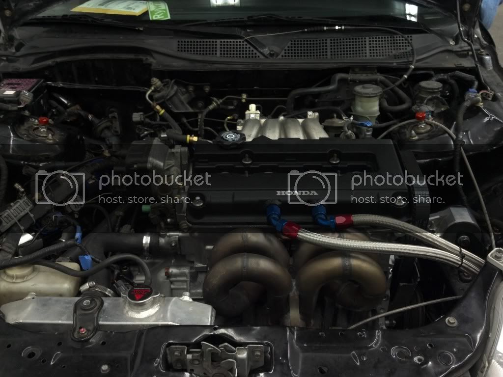

Here's where I'm at after today
Tomorrow is my last day off of work so I am going to try and get it as close to running as possible. I need a TB gasket, a missing plug for the harness, a throttle cable bracket, and a few other little things. :thumbsup:
Not too much visible progress on the car today. I fabbed up a bracket for the throttle cable and began plugging the wiring harness in. I am going to ship the ECU out for VTEC conversion to Xenocron tomorrow (hopefully.)

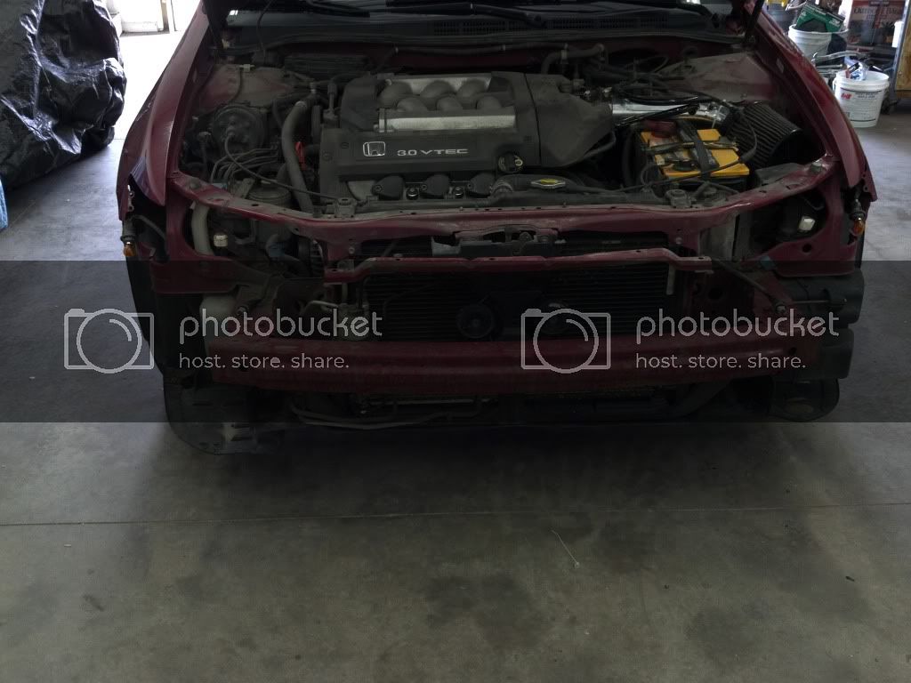

The projectors for my retrofit should be arriving today, so I'll be working on that and finishing up the interior LED's tonight. Pics to follow, they're on my phone I just need to upload them and put them in a thread here. Going to start a new thread for the Accord.
Meh, I'll just add pics of the Accord here.
Box o stuffz

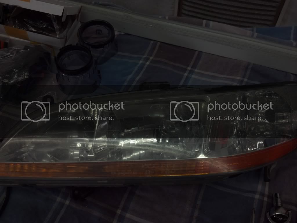

Bumper and headlights off

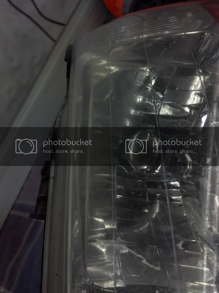

Headlight lense nastiness

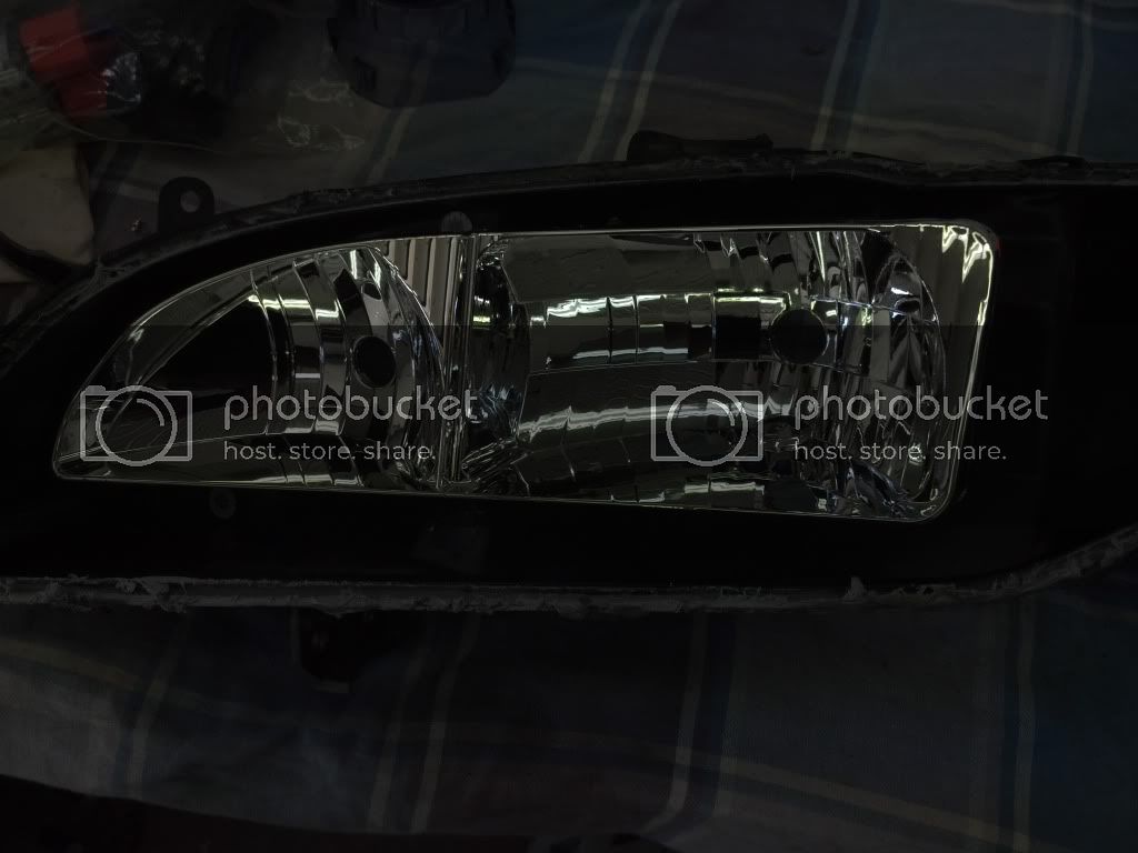

Separated

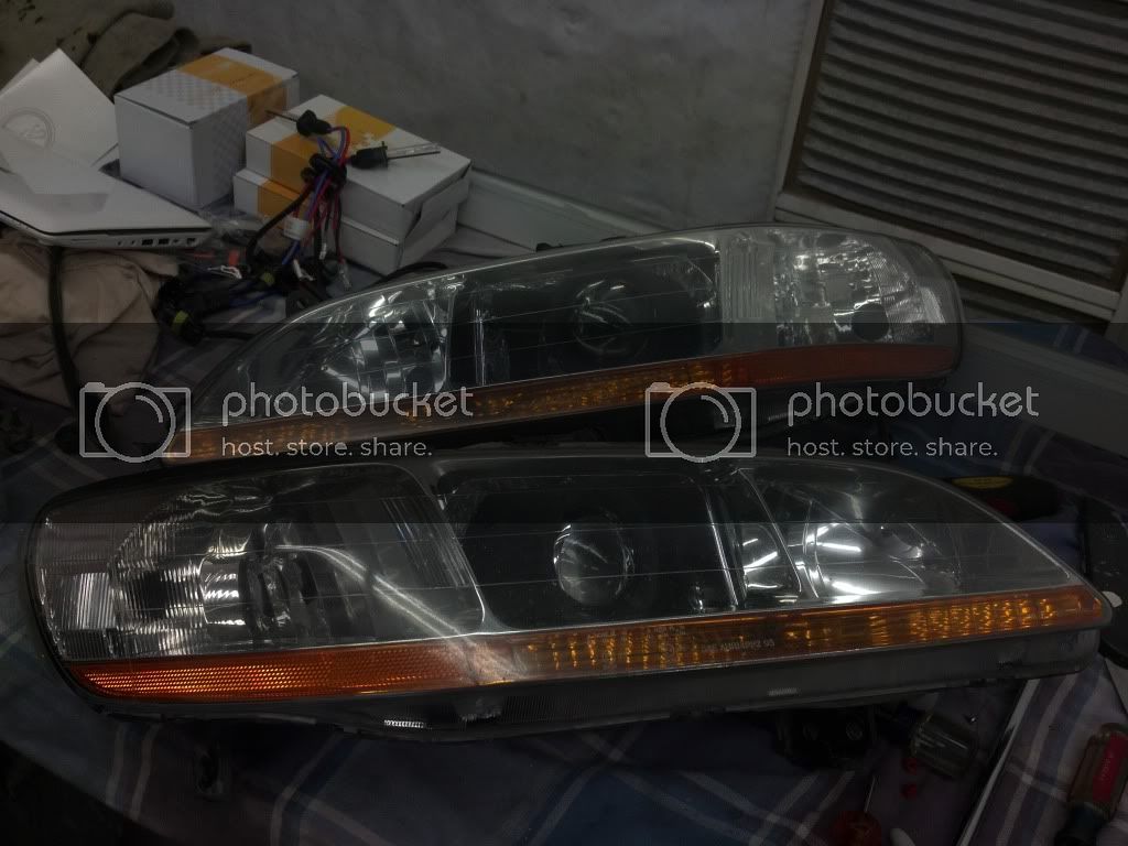

Re-assembled, retrofitted
light output pics, yes I realize they're a little crooked, I havent had time to get in there and turn them yet.

Yep! I got the Morimoto mini H1's. I am pretty satisfied with the outcome. The kit was a little pricey but it was a very quick and painless install, which is exactly what I was looking for.

How do you separate your headlight lenses from the assembly? I've tried a few different ways over the years and its always a PITA. And I usually wind up cracking something.
oven sir. oven.
I think 200' over a few minutes and the lenses unglue real easy. I've had plenty of friends try it and had success the first time.
oven sir. oven.
I tried that once. They didn't even budge. Guess I have to leave them in longer.
Check my thread in my sig. I'll rehost the pictures as soon as I get back home.
Yeah 200 degrees for 10-12 mminutes is what I did and they came apart pretty easily. I started at the end furthest from the turn signal and pry until you can get your hand in there to separate it. Make sure you separate the tabs around the light before you try to pull it apart or you'll break them.
Alright, I've never left them in that long. Definitely the problem.
