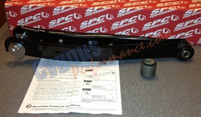

Finally got in there yesterday. Got the new tires mounted, Front fenders rolled (rears already rolled), and then aligned. When I put on my summer stuff I also put on some SPC rear control arms that are camber adjustable. These arms are great! finally an easy/affordable way to get rear camber adjustment in these cars. Before on my summer setup i was locked into about -2.5 degrees camber in the rear, which is just too much.
Previously you had 2 options for camber adjustment:
1. replace the bushings in the rear upper control arms. this gave you +/- 0.75 degrees camber adjustment. and they were a royal PITA to install and adjust. but they were affordable, about $150 for the set.

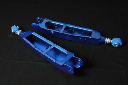

2. Cusco Rear LCAs. Easy to install and adjust, +/- 3.0 degrees, but quite expensive. about $550 for the pair. also probably not super great for all-season use.
now the SPC arms, +/- about 2.0 degrees adjustable, easy install, and should be a lot better than the other options for all season use. and at $220-$250 a pair, it's a no brainer. comes with offset bushings for the rear toe arms, but I did not need them to keep my toe in spec
