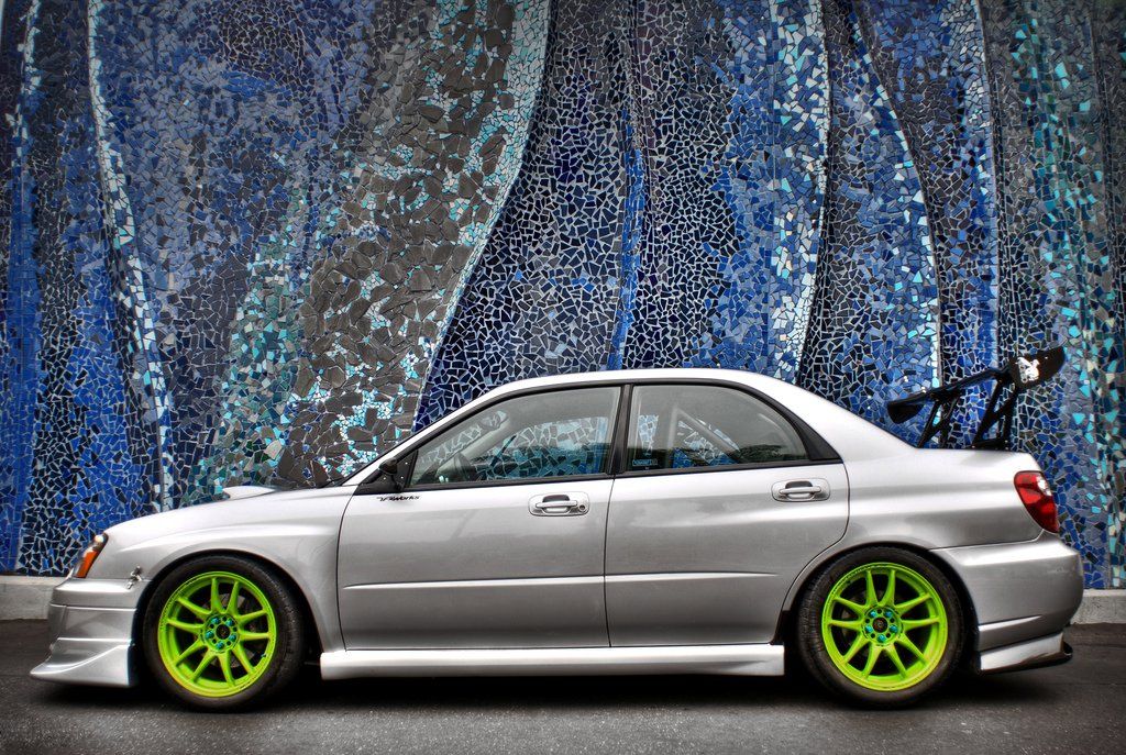

planning ahead to summer.
i need new tires.
while they're off, i was planning to have the rash fixed on the one, and the whole set re-powdercoated.
since they're getting refinished, maybe it's time for a color change.
thinking about a bright green like this (I know E will approve):
Why not a color that compliments instead? Like black grey or bronze.
because boring.
i dont like black/dark grey for wheels because the wheels then blend in to the tire and it's hard to make out the profile of the wheel, and my wheels now are already bronze and i'm looking for something other than bronze for a change.
