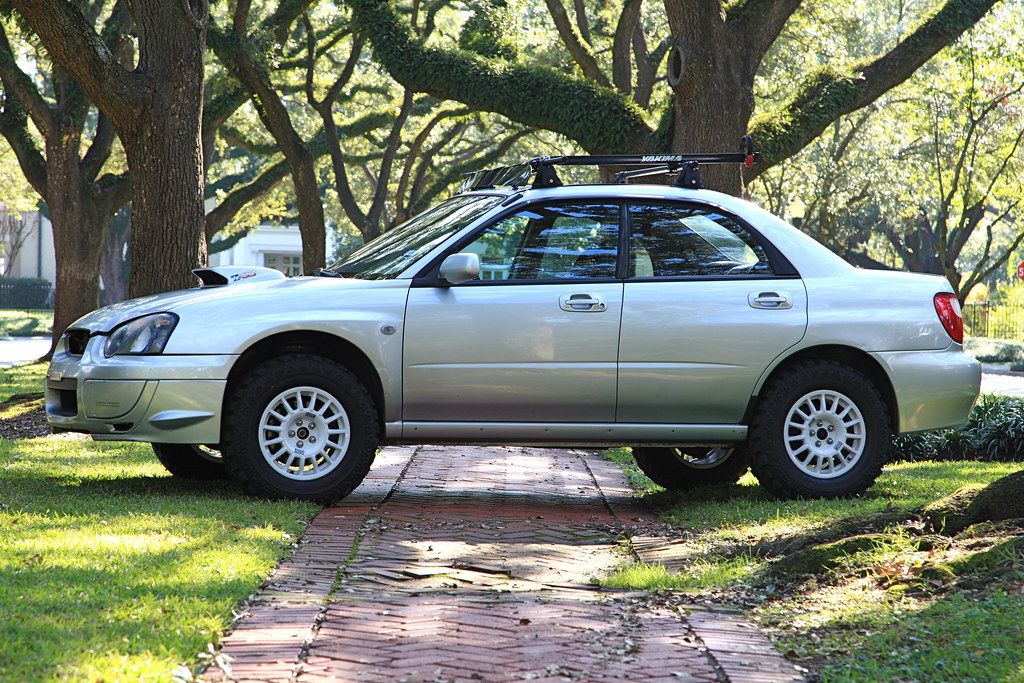

Haha. It's already pretty high. I was parked next to an outback sport today and my car was higher haha
I could be wrong but that doesn't look much higher than mine, looks like they cut the fenders out.
Either way that's ridic. I'll find some pics of a guy on another forum who put forrester suspension on his impreza. Gave him like 4" of lift haha.
