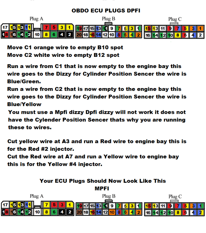

I have a civic ed dxi automat and do the dpfi to mpfi swap, from d15b2 to d16a9 manual
Now have i am the problem
The motor have only spark on cyl 1 and 2, 3 and 4 have no spark from te distrubutor.
i have first this manuel done, http://hondacrx881.tripod.com/mpfiswap.html
yesterday say people u must used this manual,
in both manuals have i am the same problem, no spark on cylinder 3 and 4.
Only at the last manual I suddenly have the problem error 3 (map sensor).
I can extract the key from the lock but the car stays on.
I push the wire from the cyl sensor, there are no changes, the car turn not off.
What are the problem and what are the best manual about mpfi swap?
