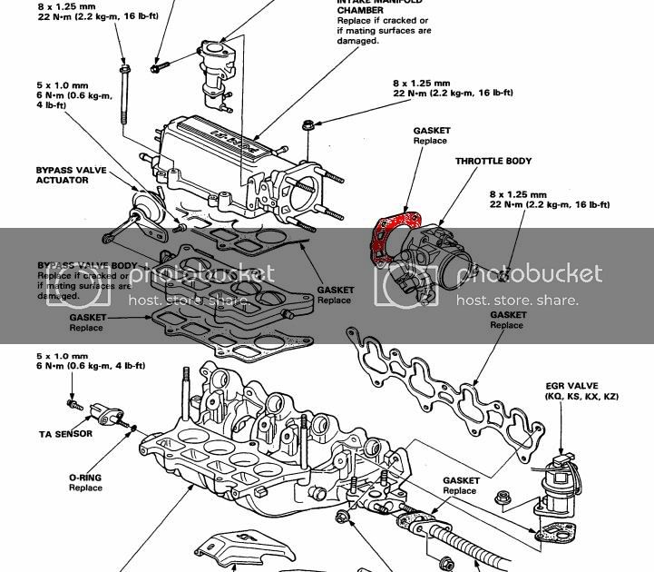

IT still sounds like you have a vacuum leak. that would explain the high idle and tuning down the idle when you have a leak would make it die at low RPM.
so, youre suggesting i start searching for a vacuum leak?
i do that by spraying soap and water on the hoses, right?
no, carb cleaner like i said in your other thread
fucking with the idle screw and the FITV.
thats the third gasket that i was talking about.
ahhh gotcha, i forgot bout that middle gasket. if adjusting that screw isnt working either spray the carb cleaner on the manifold and check for vaccum leaks
