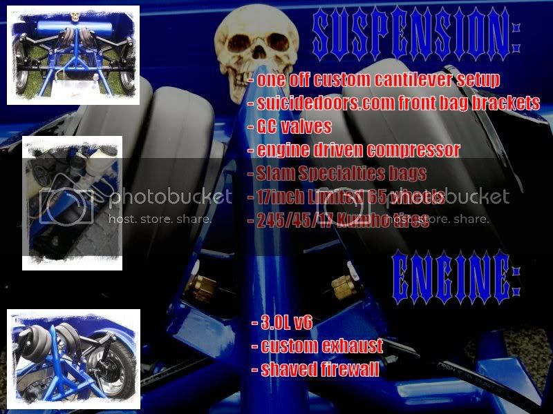

Most things have been done before, but I think one of my personal favorites was the bags that inflated sideways and the truck lifted last year at Dropt Out.
you mean this:
which is on this Ranger:
thats owned by a buddy of mine named Greg. its clean as hell i think and hes put alot into it...and he did all the work himself.
