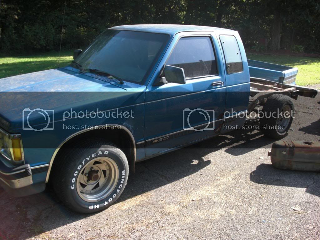

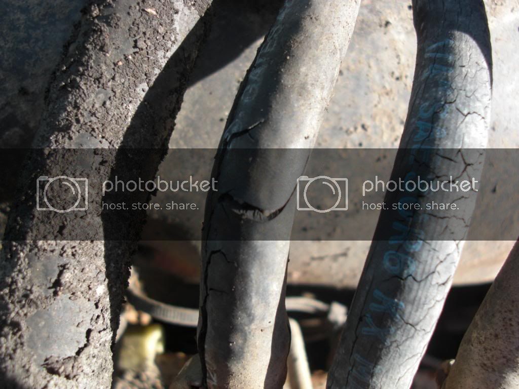

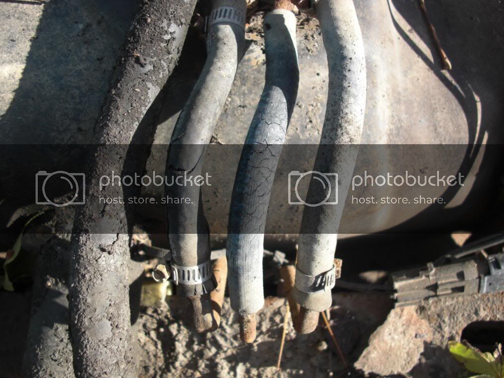

oh, and there was a huge gas leak on this thing so we took the bed off tonight and there it was a huge hole in one of those rubber hoses on the top of the gas tank, ill hopefully have that fixed tomorrow or the next day then it'll be runnin, and ill buy the new passenger window and it'll be on the street :thumbsup:

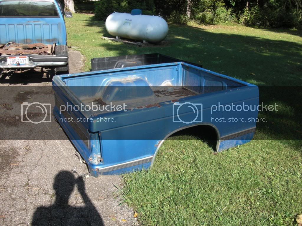

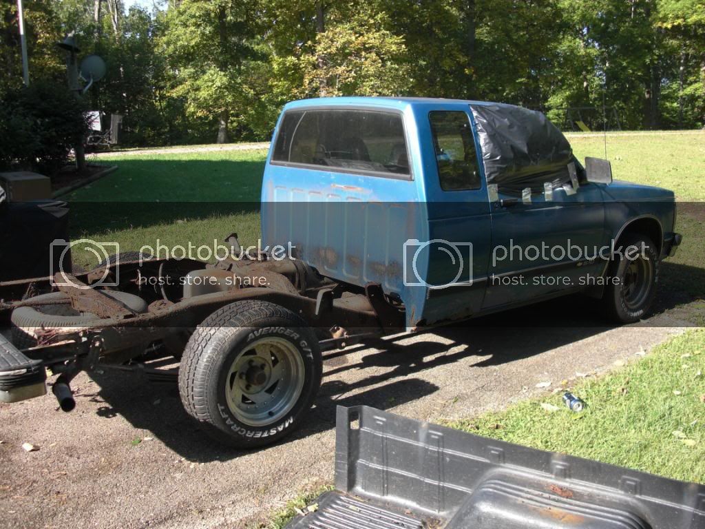

OP: good luck on the gas leak let me know how hard it was to take the bed off. I might have to take it off soon too.:o
it was 6 bolts on the bottom and 3 on the filler neck on mine and me and my dad lifted it off, it wasnt that bad, just have some long extensions, the right socket, mine was a 15mm for some reason my whole truck is metric, and i had a steel pipe so i didnt have to work so hard...
heres a pic of the hole that caused the gas leak:

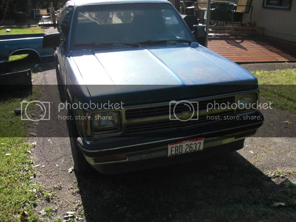

and more pics of the truck:
hope to have it fixed this week... let me know what you think...

also while the bed is off you might want to grind down the rust,wipe down with ospho and sparay on undercoating.
i dont have a hose to wash it where it sits now lol and im gonna try to get a pressure washer to spray that frame and everything off once its runnin ill definitely wash it though and im gonna replace all those hoses i dont wanna take the bed off again lol
$5 Says once you put the hoses back on the sending unit will crack. It's a PITA for any fuel lines. I had to drop the tank of mine 3 or 4 times. In review, taking the bed off would have been easier.
