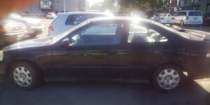

Anyway, here's a few photos of the ride. It needs some body work, but, I have the driver rear quarter panel to fix the hole, and the ej civic I pulled the mount/cluster/shift boot from has a good passenger door, as mine has started to rust out along the bottom seam. IMG_20200706_171115.jpg IMG_20200706_171138.jpg

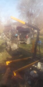

And the donor engine/tranny, ant the b18 put in the civic.
Sorry for the really bad pics here. The rear camera on my phone is pretty messed up. received_2812508505743796.jpeg received_423403498660591.jpeg
Yeah, the glass over the lenses was cracked and removed last year. I usually use the front camera and just mirror the image afterwards.
Oh, those pics aren't that recent. I am rocking some better wheels now. 7th gen Canadian civic Si Veloz Edition. Got them from a coworker. But, he does have a set of the 6th gen SiR rims (I'm in Canada, so American 6th gen Si rims) I may procure from him.
