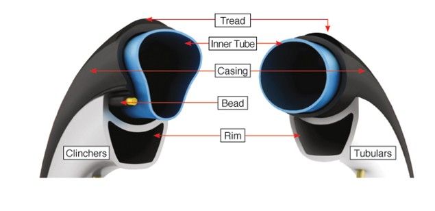

this is a cross section of a Clincher tire/tube/rim
1: rim, 2: rim strip, 3: rim braking surface, 4: bead core, 5: inner tube, 6: casing, 7: tread
here is a comparison vs a tubular tire
where the tube is part of the tire and there is no bead the tire is actually glued to the rim
