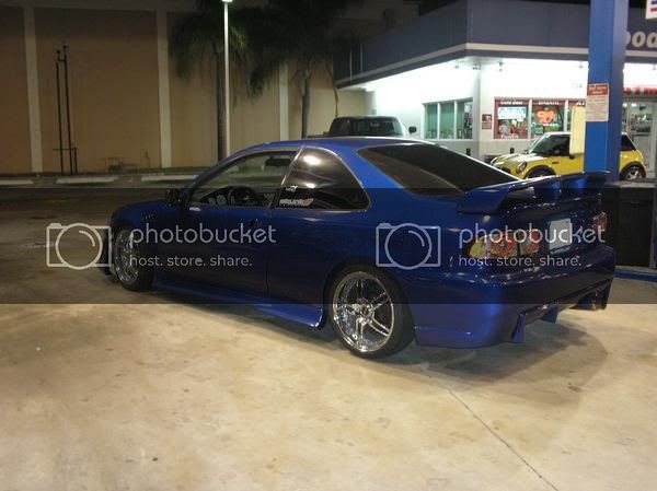

since u want to know to see how ma car looking like then here some picture of my car.

The only thing tasteful on that car is the color and since it's on that car it was a waste of good paint.
But it doesn't matter what I think as long as RWD_CRX_06 likes it is all that matters
Here's a car that was built in good taste ( eg. non ricer. Ok maybe the wheels...) ;-)

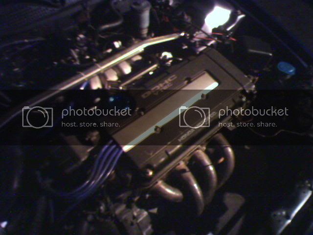

LS/Vtec
12:1 compression JE pistons
Eagle rods
Cometic 0.051" head gasket to lower compression to that
stock 81mm bore
Skunk2 Pro Intake manifold and 68mm throttle body
Hondata IM gasket
GSR head
Skunk2 Pro valve springs
Skunk2 retainers
Skunk2 Stage 3 cams
AEM tru time cam gears
Type R oil/water pumps
GSR tranny
11lb flywheel
Stage 2 exedy clutch
I have a polished ss hytech header waiting to go on
P28 Chipped by me running crome on an ostrich eprom emulator
LC-1 wide band with o meter
Picture was taken before the cams and headwork so you won't see cam gears.
The whole body of the car is stock but the front emblem was shaved and the side rub strips are painted. Fresh paint last winter. Oh and the painted ricer mirrors :) I didn't put them or the wheels on.
Nice build, yuck to the wheels though lol... i'm not feeling the head lights either though... but that motor isn't a bad peice of work :)
