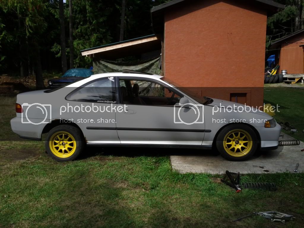

hey brad, before you go blowing your hard earned cash on a set of coilovers, take it from me (no homo) i have tried all types of combinations from skunk2 springs on oem shocks, skunk2 shocks and springs, cut springs, tanabe springs on dropzone shocks (BIG MISTAKE!!) emusa coilovers... the list goes on.... then i finally just bough a used set of oem type r springs and struts, complete with control arms... and it is the best setup i have had so far!!! give the type r's a try dude. its cheaper and the quality of thehonda parts will outlast any coilover setup you will get. (or can afford, cuz lets face it, shit's expensive!) thats just my experience anyway... down the road i might go with tokico struts when these wear out...
My $0.02 on cheap lowering options.
I been rocking Neuspeed Race Springs for over 14 years and they sit fine even with my K-swap. No more Neuspeed (from my knowledge) but H&R and the same springs and they can be bought for roughly $200. Not adjustable but they sit lower than Eibach springs. I think the lowest Eibach's are 1.7-1.8" but my race springs are 2.25". Although it would be smart to run camber kits so you don't go through tires so fast. Decent shocks are a smart buy but you can tear the stock ones up first and get aftermarket shocks later....at least thats what I did lol. If you don't wanna be that low.....get something higher (like Eibach) which could also alleviate the need for a camber kit. Decent Coilovers are $600-1200 and that price can be scary in comparison to other options that are not adjustable.
People talk about spring rates and I can agree with a desire to have a stiffer front with a swap but I also think its not totally necessary if you go with a reputable spring set up. Just run what they are rate for the D-series motor. If its possible to get a stiffer spring for the same price......do it.
Cheapest and least appealing is the cut spring. But all it takes is time and a cut off wheel. You will be more bouncy than an aftermarket spring. If you go this way.....just make sure you cut dead coils only. I would say 1.5-2 coils could be cut. If I was to do it....it would be temporary and changed soon as funds are available.

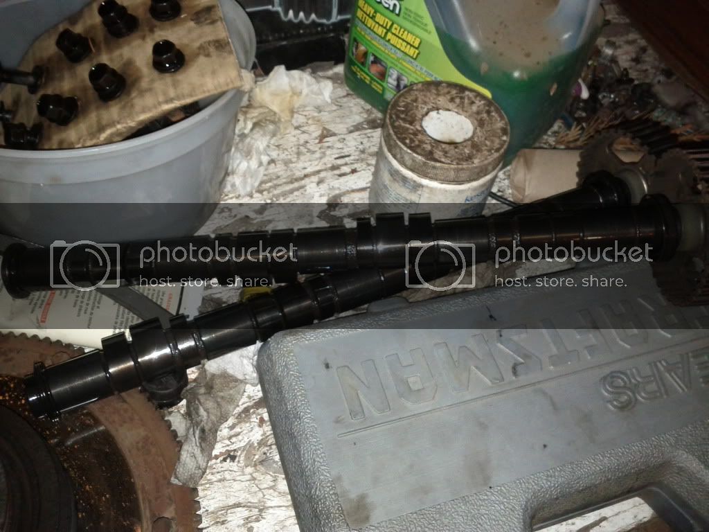

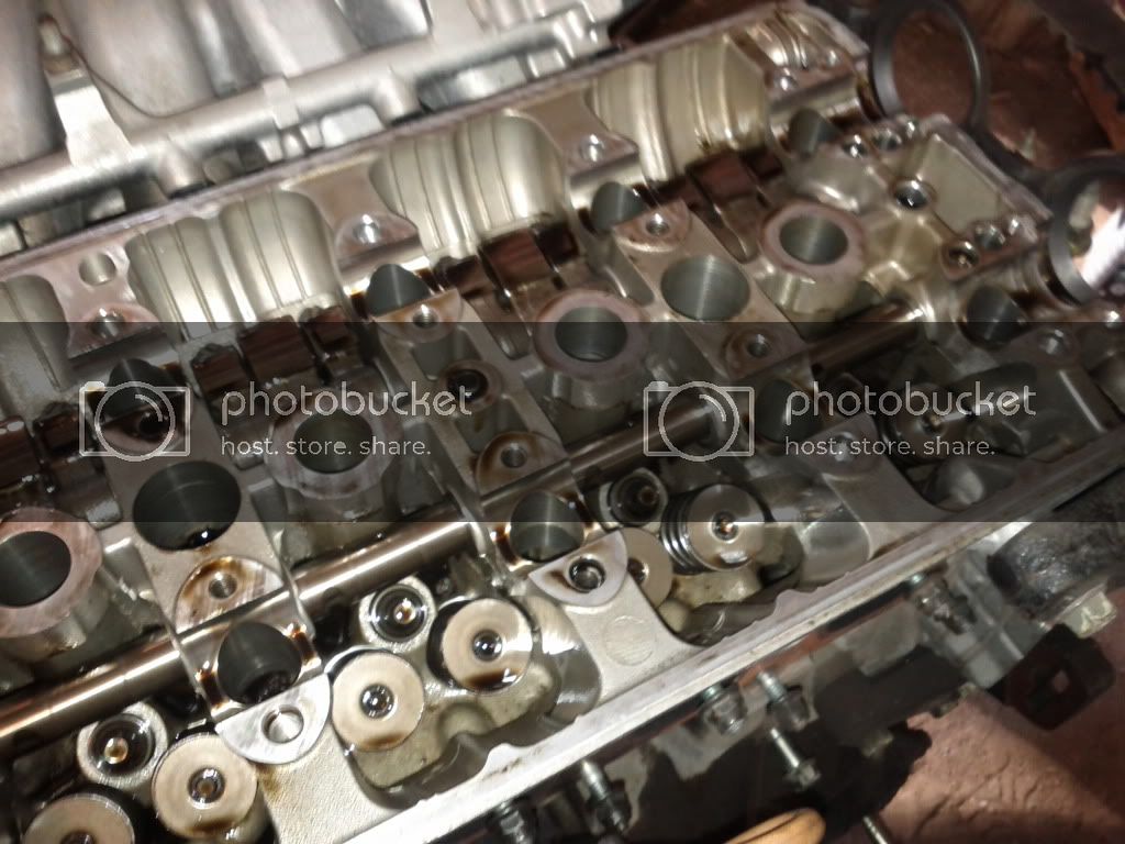

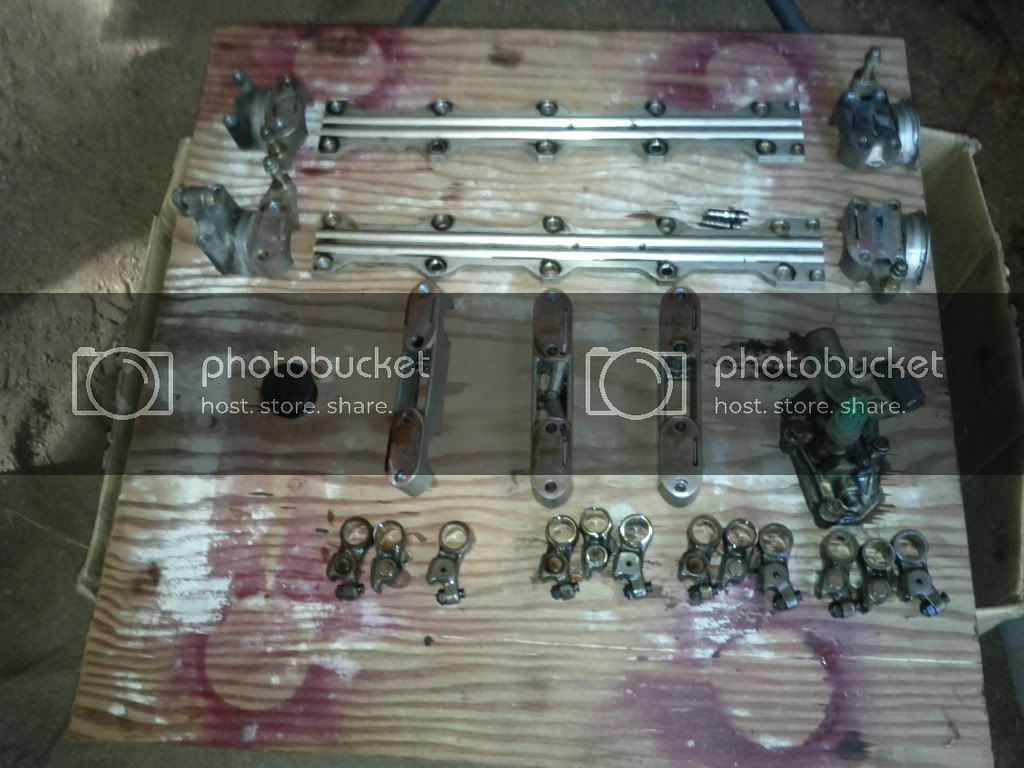

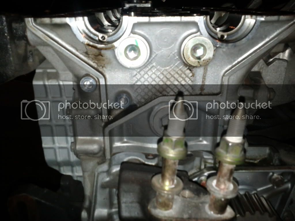

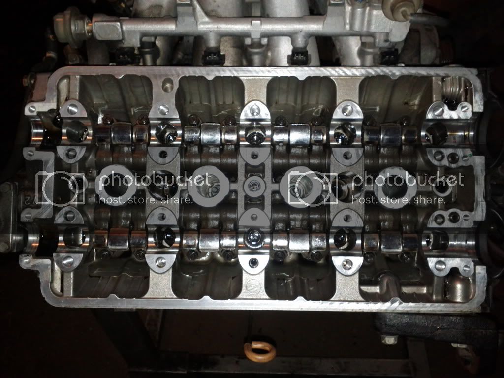

I got the head torn down and installed the new LMAs. It pretty much needs a whole gasket set but for a high mileage motor its in clean shape. It looks like it's been serviced at the dealer it's whole life too.
as DC4dude said.. OEM ITR springs.. i'm running them on the GSR w/ AGX and couldnt be happier..
you know, mr. eg6sir.... they DO say great minds think alike....lol
and brad, ive seen them on ebay, struts, springs, and control arms for $350.00 shipped. thats how much i got it for... check it out dude!!
no to mention, with ITR lcas, the itr sway bar will fit perfectly
The ITR suspension sounds convincing but id rather have adjustable suspension one day. Its really worth the wate imho.
For $150 I can get a JDM ITR rear sway, rear shocks and LCAs from Total JDM.
do it.. use the LCAs and sway.. gotta make sure you order suspension for an ITR though.. shock base goes inside the lca instead of around it

Maybe I missed it, but wtf happened to those retainers?
Yep I got it then put it away for now. And what retainers do you mean?
