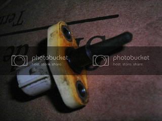

Because I'm thinking since I'm getting both the IAT AND the IACV codes...I mean what are the odds that there's a problem with BOTH sensors I probably just mixed plugs I'll try that tomorrow then hopefully just have a couple leaks and the vtec wiring to deal with.
heres the IAT SENSOR....
SHOULD BE ON THE LOWER PART OF THE INTAKE MANI
On both my d and b series its held on by 2 12mm bolts
Those 2 electrical plugs from the back of the IM? My shop teacher told me the IAT is supposed to be in the air intake pipe when I took my car to the shop an hour ago. I'll check that for sure tomorrow I couldn't do it today.

Lol yea he's kinda dumb with anything other than domestics. He thought the ecu test wires were on the drivers side. I've been doing most of it myself and glad cause I've learned a lot. I found those iacv and iat sensor bolts they're both probably bad.
I tried switching plugs, spraying with carb cleaner, reset the ecu each test, code 14 disapeared and came back, I'm not sure what to do with it since I went to the service manual and it says I need a special Honda tool my shop teacher doesn't have.
