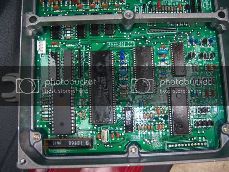

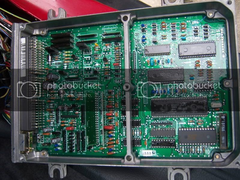

120 is the high in CA and it was 240. He said its unburnt gas. Makes me think my P30 USDM has a chip in it or something (maybe b/c the fuel/air ratio isn't stock which puts it higher....??) It don't read the knock sensor so I think it might be the problem. The cat has always been good to me ('92 original) but I might need a new one? He said it wasn't that high and that he could diagnose it for $70. Gonna have him look at it Monday and see whats up...seems like my only option. I can take the ECU back and switch it with the guy (he has one in his car too) he told me we could switch if I wanted....so I just might now and try again. I figure I can find out if its the Cat first and go from there.
chip would be in this location
I think I'll crack it open soon to check thanks
Took the four screws out and it seems to be stuck on there.....I don't want to pry it off too hard....not sure what the hell is going on....edit...nevermind...I'm an idiot. I left the receipt on the ECU which was covering the center screw....pics up in a moment

eg6sir I do have a chip in that location....doens't say much on it (not liek the pic you gave) but there is something in the same exact spot. Is that spot suppose to be empty or what???????

CAFROG that is a chip.. and it sux it isnt the one that you can lift the lever and replace w/ a different one.. because i have a stock b16a map burned to an SST chip from when i chipped my p28.. the guy made me a stock map just in case the basemap he made me didnt work out

So I am glad to find out I have a chipped P30 and this MIGHT be my problem at idle. I would rather not buy a $200 restricting Cat (mines all broke in lol) or a $180 O2 sensor.
Shop I bought it from will get me a new one and I'll pop it open right in front of him before I go through this crap again. And I'm hooking it up right then and there to see if the CEL for Knock comes up.
