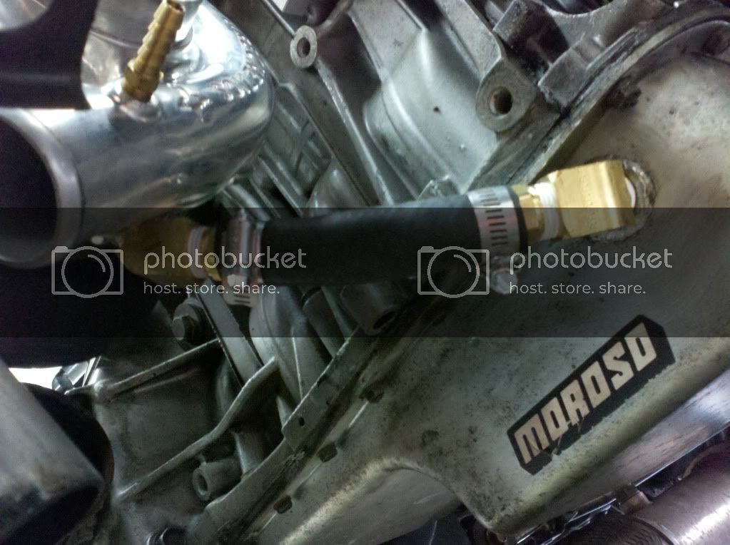

so i got the turbo back on the car. i made the drain a lot larger and more straight as opposed to the mess i had going before. thinking this will work 100x better than the last
i need to have an elbow welded on the compressor housing in order for the drain to work this way, but i figure that is better than letting the oil back up in the turbo lol

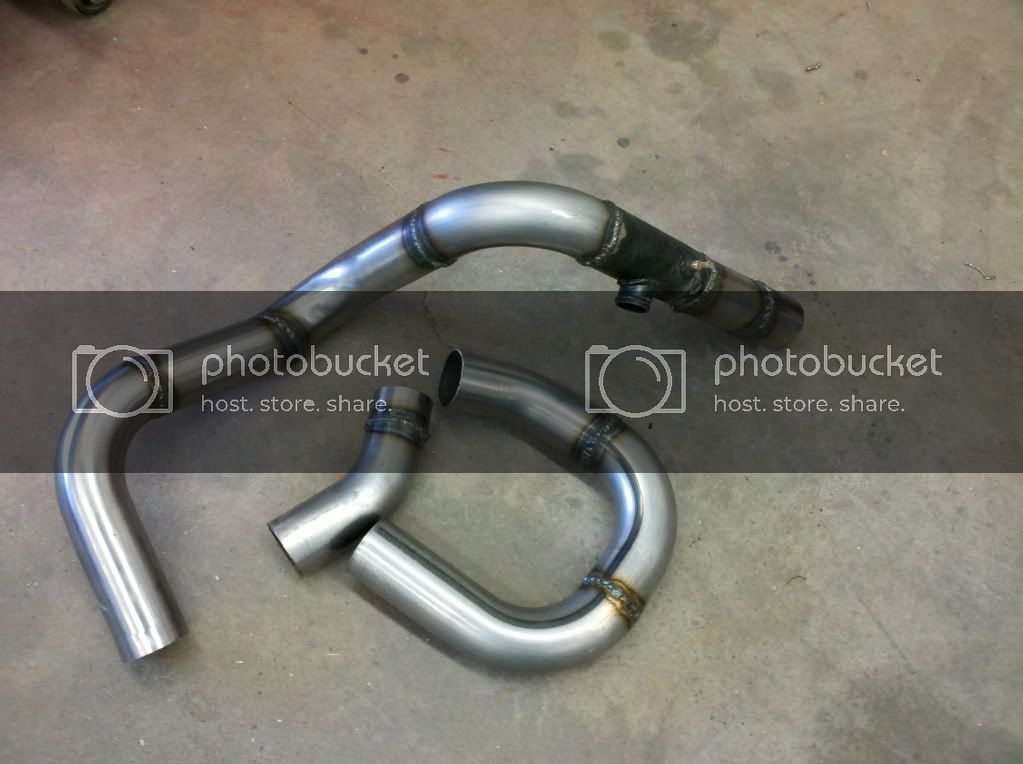

new charge piping that i cut/welded.. welds arent the best but itll work went from 11 couplers to 6 couplers on the charge piping (one on the turbo, one on either end of the IC, one just after the BOV to allow me to install it, and one on the TB).. here it is:
