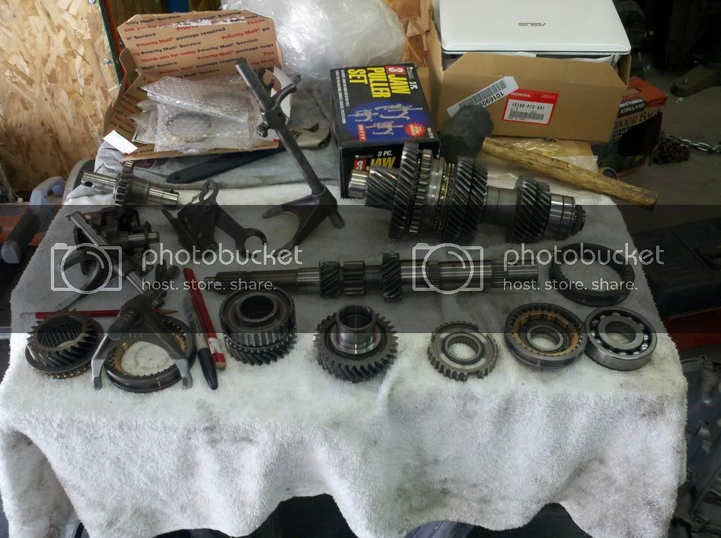

I just finished replacing parts on the main shaft of the transmission. It was actually fairly simple.
Parts replaced:
1st, 2nd, 3rd, 4th, 5th and Reverse Synchronizers with new carbon coated Synchrotech Synchronizers.
3-4 Synchro Sleeve
1-2 Synchro Sleeve
5-R Synchro Sleeve
Did some filing on the gears to remove mushroomed material. Scuffed up the gear cones to ensure that the new synchros will grab to the best of their ability.

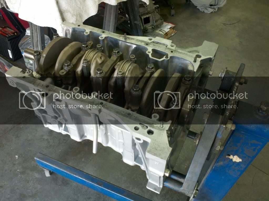

Waiting on a shipment from Majestic so I can put the case back on the transmission. I'm also playing a waiting game with the machine shop that has the cylinder head. The bottom end is back together. Fresh oil pump, pan gasket, pickup gasket, oil front and rear main seals.

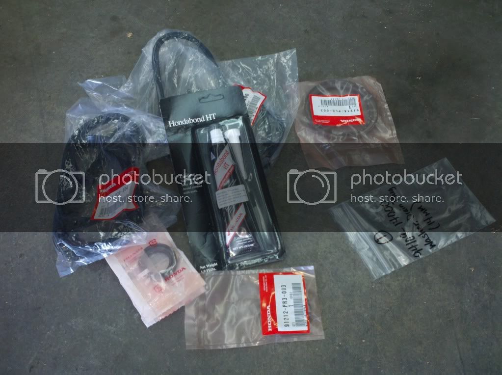

These are old now, but I thought I'd put em up anyway:
new parts: seals, gaskets, etc..

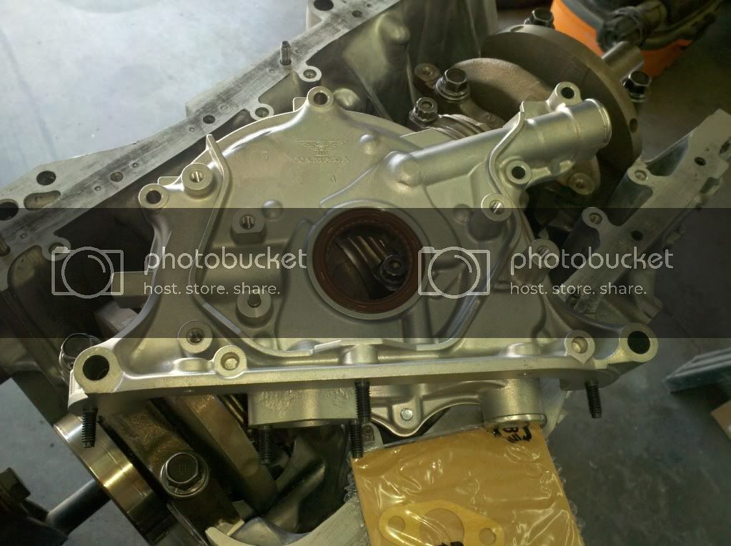

New OEM oil pump:
Bottom end together:
This was during the transmission rebuild. Not as bad as it looks.

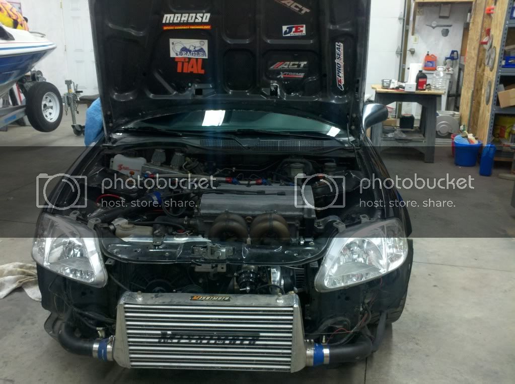

My engine bay is a fustercluck.
