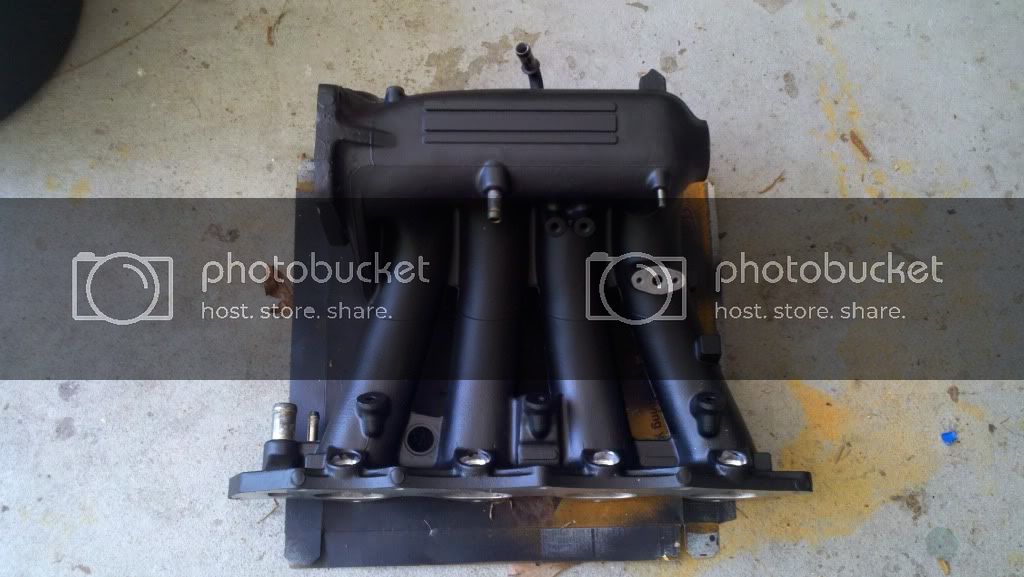

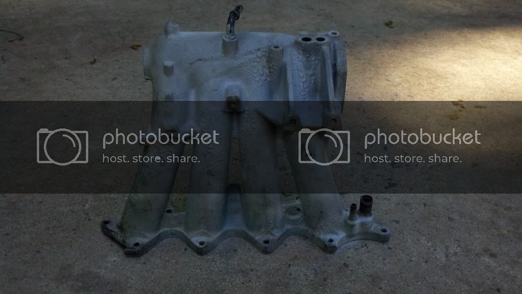

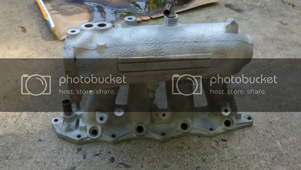

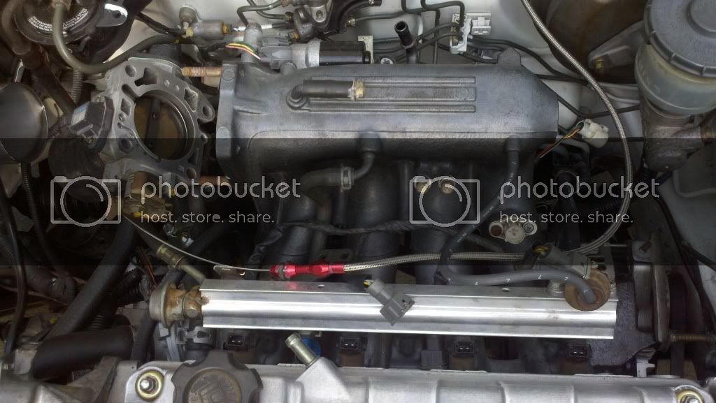

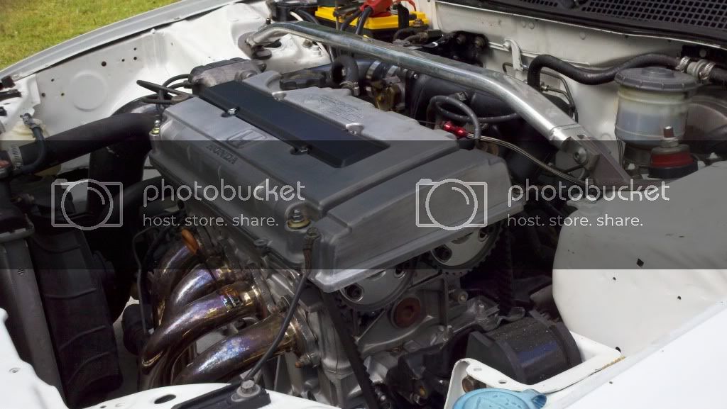

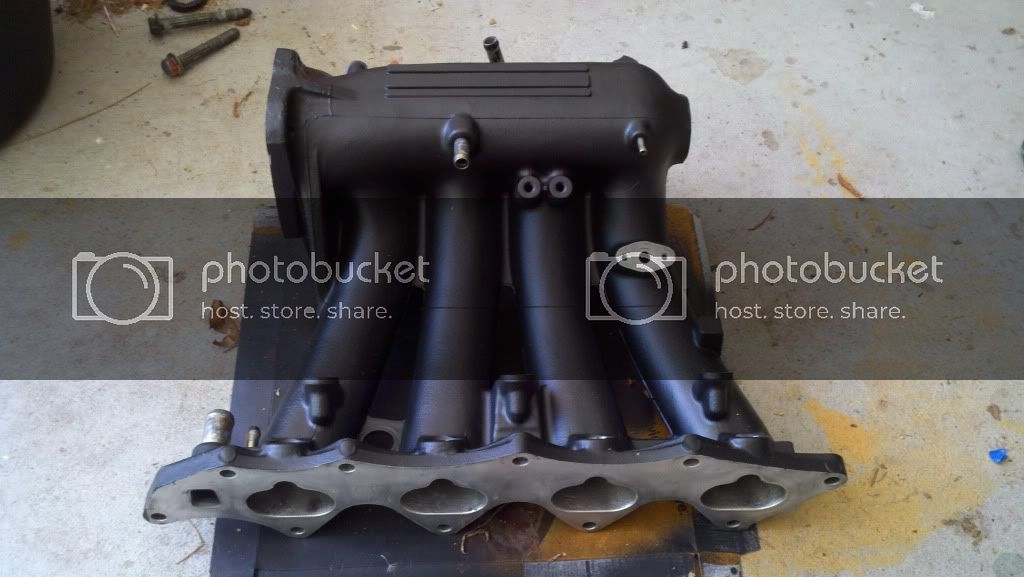

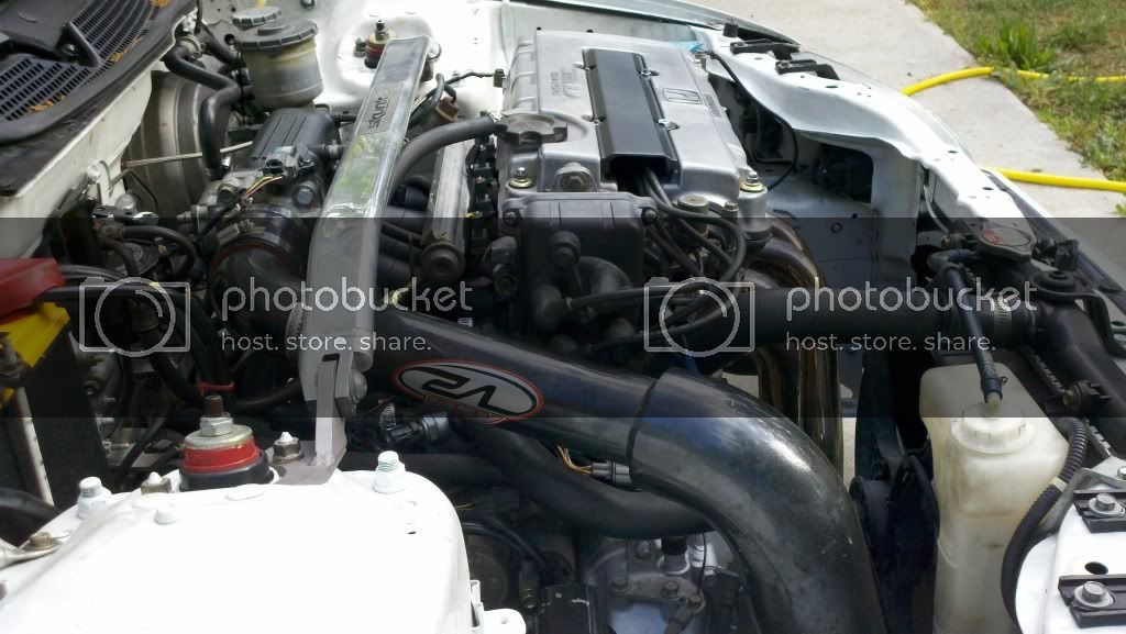

Time for a little update. I have been having idle issues for a long time now and I have finally fixed the problem. I do not know exactly what the cause was, but I don't care because it is gone now. I had been tossing around the idea of switching intake manifolds. The one I was using was an obd2 mani that I had to modify to use the TA sensor. I had to block off two vacuum bungs with hose and screws. Also I had to modify the coolant hose so that I could get coolant to the iacv. I was looking around on a local forum and found a guy that wanted to trade an obd1 mani for my old d series shift linkage, so I made the trade. I cleaned up and painted the mani and replaced all the gaskets, and now no more surging. I was never able to find any vacuum leaks before, but that must have been the problem. Here are a few pics of the IM before and after and some of the engine bay as it stands right now.
Old mani as I am taking it out.
Some before with air craft stripper on it.
After. I polished all the mating surfaces (finished with 1000 grit).

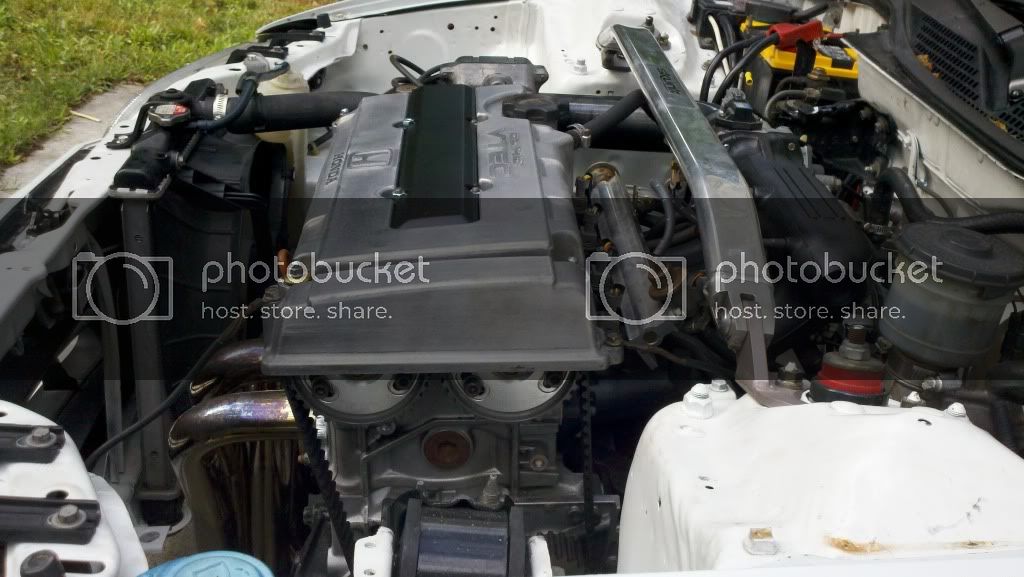

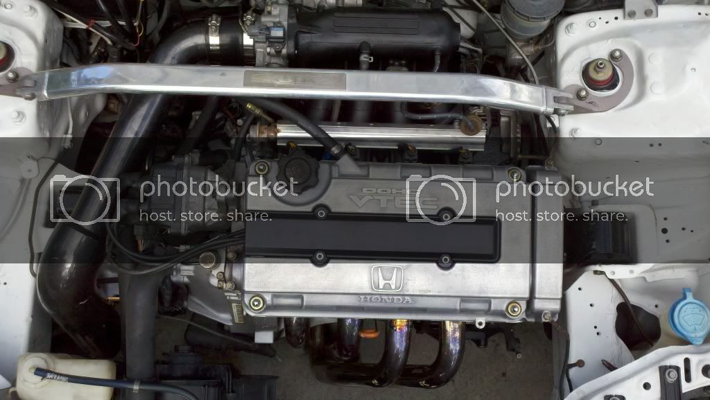

A few of the engine bay.
The black paint job on the intake manifold looks great - I'm going to paint mine now before assembly. Will sandblast it along with the valve cover and paint both.
:thumbsup:
wheres your timing cover? :bash:
other than that, the bay looks awesome. :thumbsup:
I am missing the middle part so I took it off...is it that big of a deal?
I am sure the strut bar is probably cheaper than the spoon.
Is it dangerous? I know something could get caught between the belt and pulley, but I have seen other cars without it. I wonder if I could make one out of sheet metal. The plastic one rattled so bad that it drove me crazy. It might have been because the center piece was missing.
I was just messing with ya bro.
Just get one from the junk yard and if it rattles get a large tube of RTV and go to work on it. That'll do the trick and you will still be able to remove it without much of a problem. I see a lot of them off in pictures. Probably best to keep the belt and stuff covered for longevity.
I always run the covers on mine.
Still like that black intake manifold - Mine will be painted tomorrow - may do the valve cover to match - not sure - after the stuff is sandblasted I need to paint the intake, valve cover and oil pan.
I think I will make one. I really don't like how cheap the oem ones look. Plus a one piece cover would have less room to rattle. I have a serious problem when it comes to rattles. They drive me crazy.
Thinking it over a bit - the "Why". Why do they put covers on the timing belt in the first place? I can't think of a reason why one is necessary. Other belts run out in the open. Serpentine, alternator, power steering pump, A/C compressor, etc.
Wait a minute, here's probably why they cover it - the timing belt performs a critical function so if something from the road bounced up or deflected into it the results could be catastrophic - which is not the case with other system belts. It's an unlikely scenario, but a possibility and the results are such that it's not worth the risk.
