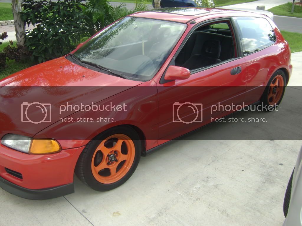

    ABOUT THE CAR: Well i ended up with this hatch from a co worker,i had a 2000 monte carlo ls that was clean but high mileage,i ended up trading him for the civic plus he gave me a grand to even things out,it has a cheap red paintjob that is fairly new,b18b1 swap with intake,exhaust,and chipped pcm. the car has run high 14's from its previous owner.i have done a compression check and all cylinders are around 180 to 190.doesnt use any oil,no smoke pulls pretty hard!
    the rims in the pics below are gone and its currently on 14" steelies.also i hit a possum the other night that ripped the front lip off as with some paint on the bumper:(car has ice cold ac

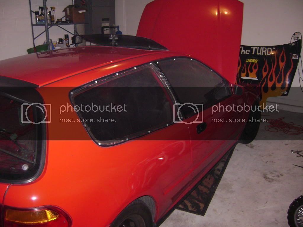

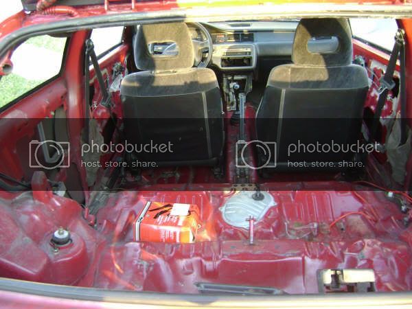

    So the only chance in hell i got of making this turd runs 12.s is making it as light as possible and thats what ive done.i removed everything that wasnt needed and of course ill pull the passenger side seat for track runs.front side windows and tracks were removed and all of the interior except for the dash.

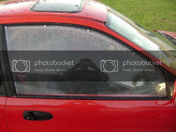

    So to keep the rain out i got some 1/8 lexan from a co worker who used to work for a plastic company,he wouldnt take no $$$ for it,although he only had enough to do the front and rear side windows.being a leadman at my job has it perks!lol
    so today me and a freind installed it on the front side windows,i didnt want to rivet it over the door frames so we cut it perfect to fit in the original seal of the glass.although a few screws were needed to keep it in place. we ran out of light before we got to the rear side windows though:(

    and not that you guys havent seen a eg with lexan and a rear strutbar:) i figured to show progress,i went out to the garage and snapped a few pics.
    i was able to use the factory seals for the rear just like thr front,but i put some clear silicone on the inner lip just to be safe.and the car doesnt leak a drip even with the garden hose right on top of the lexan.im gonna get some black paint at the local hobby store to duplicate the factory glass lines like the rear windows have on the eg's...problem im having is the lexan is hard to see out of WTF? ive had g.e. lexan before and it was crystal clear,this stuff is like hazed although it was new and had the protective tape over it?wtf?
    i mean i can see that theirs a car next to me,just hard to tell what it is,lol
    anyone know what to clean lexan with?
