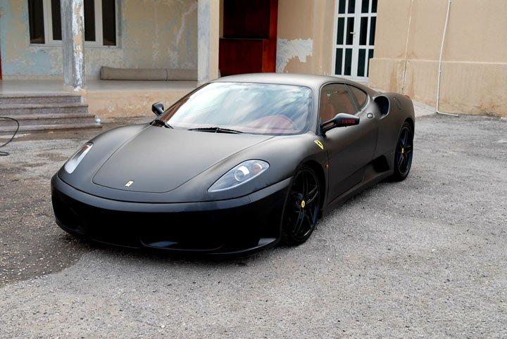

what color are you going to paint it? please tell me you aren't doing a full resto just to flat black it.
if its ok for this , then its plenty ok for a 57 Ford truck
why not?? Satin black looks amazing on a straight body
because it's played the fuck out.
that ferrari was probably one of 3251344513445 RED ferraris. they painted it to look different than the rest. if he shoots his ford with a great paint, by just having clean paint the truck will be different than most.
