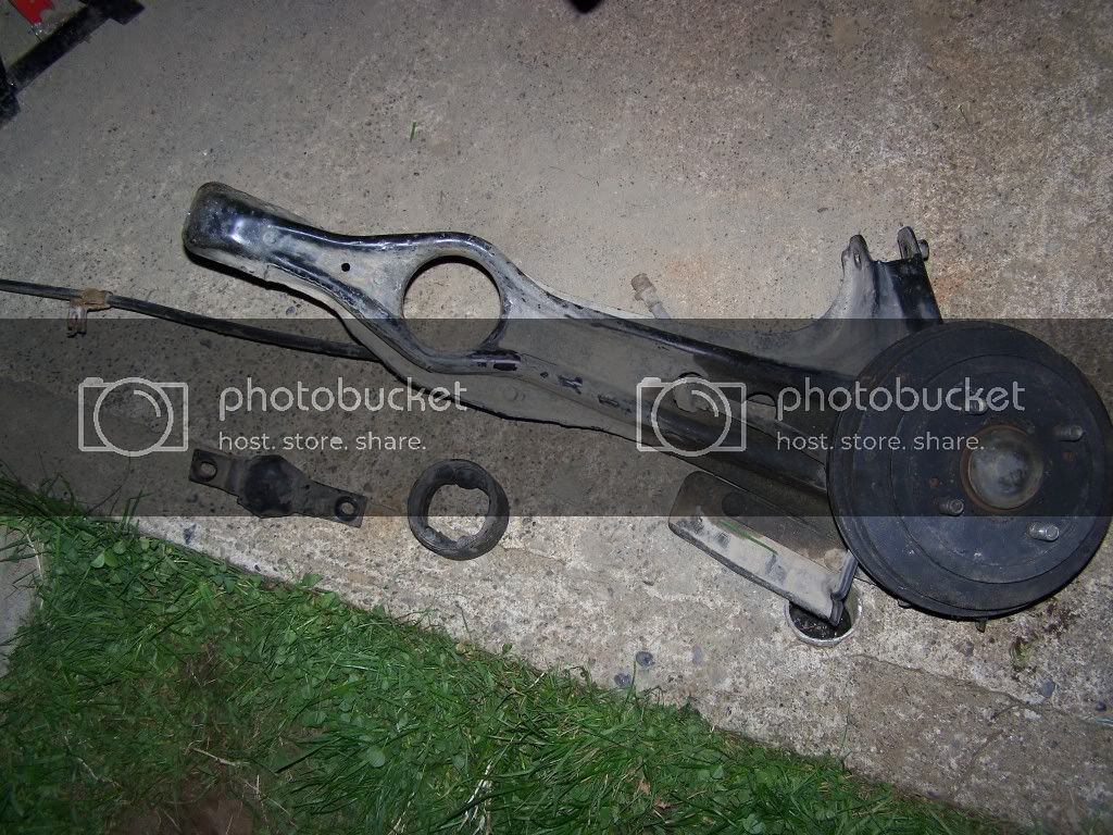

  17. GlassHeadlights
    4,066
    71
    Oct 24, 2007
    Calgary, AB
    I'll see what the dealer wants first then go from there.

  19. GlassHeadlights
    4,066
    71
    Oct 24, 2007
    Calgary, AB
    I just used a hammer, nothing else. I would recommed using like a 3" pipe or whatever diameter to match the bushing. Came out really nicely.
