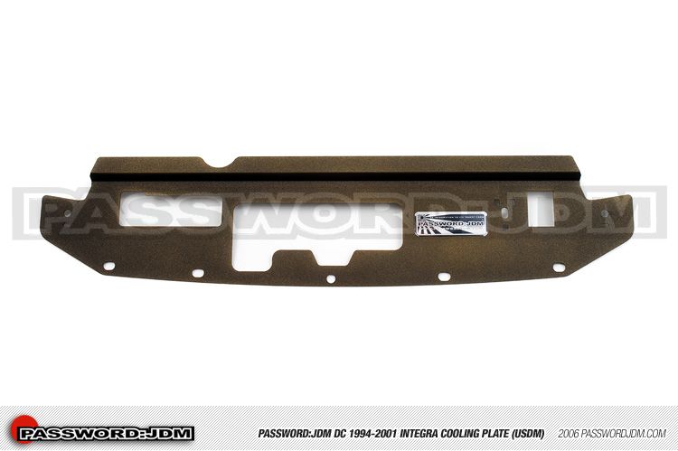

    you could also run one of those radiator panels?
