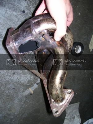

Alright, got around to taking pictures of the turbo kit. Wondering where one of the parts fit, and I need a wastegate. Gotta love that eBay bov. Turbo is freshly reground, 0km on it, I'll be the first to spool it. Gotta fix a few suspension parts, fix the cancer before it spreads, then wauptsh.

The tube in the second last picture, connects to the manifold... Where does that lead too?

wastegate... duh which is attached to your manifold
let us know how long that Ebay manifold lasts. My buddy got a week on his. At least get a Tial 38mm wastegate. I would not trust a ebay wastegate and the better ones are still the same price as a Tial one. I just checked Ebay. Tial WG 38mm about $225.00
How can you tell it's a eBay Mani? The guy I bought it off said he had it on the bar before the turbo went, so he had it re grinded (I can see the red marking pen) and had to leave town. Might be naive of me, but I thought it was all custom made

How can you tell it's a eBay Mani? Might be naive of me, but I thought it was all custom made
Um that is not custom manifold. That looks like Cheap chinese Stainless steel sus-304 2mm thick crap. That is a very common design. Don't take this the wrong way it seems you have not seen mani turbo manifolds. Trying to give you the heads up not bash you in any way. its all good man.
this is a 75 dollar manifold the same design as yours. it will crack

He wanted $1500 for the kit, and showed me the reciept from a volvo dealership for the cost of the rebuild/grind of the turbo, that alone was $500+tax. Ended up paying him... $500 lol
its slightly different.. his has small supports welded in under each runner
