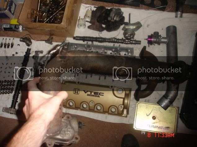

pictures of new stuff

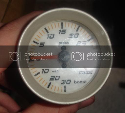

boost guage
downpipe

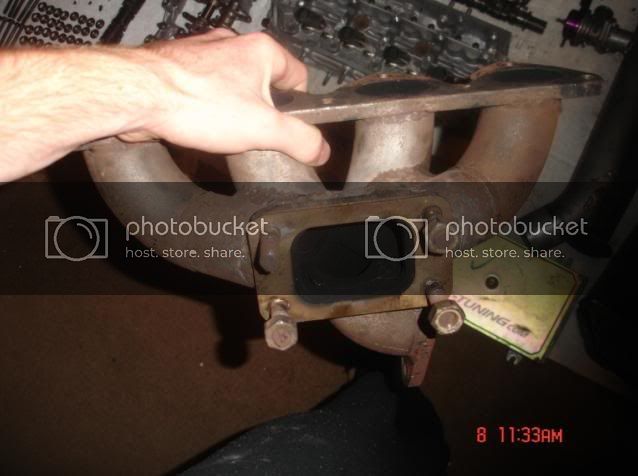

exaust manifold
z6 head
p28 ecu with crome chipping

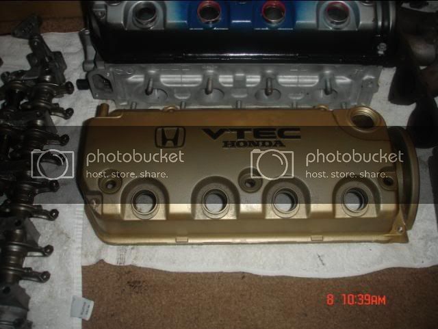

vtec valve cover
painted w/ matched intake manifold

maybe I should give you credit then?
I knew how to paint a valve cover before coming to this site, but figured I'd just read through all the stuff anyway, saw that, and thought it looked real nice gold with the black lettering. I didn't think you had the colors copywritten lol, but I do admit that I got the idea of the colors from your guide
except i think you used a better gold paint, yours looks much nicer
haha.. i dont care if you use the colors.. .. thats what its there for.. i'm selling that one anyways.. putting the b16 one back on, but its painted a medium grey.. nothing too fancy.. just not my style.. i'm pretty basic
