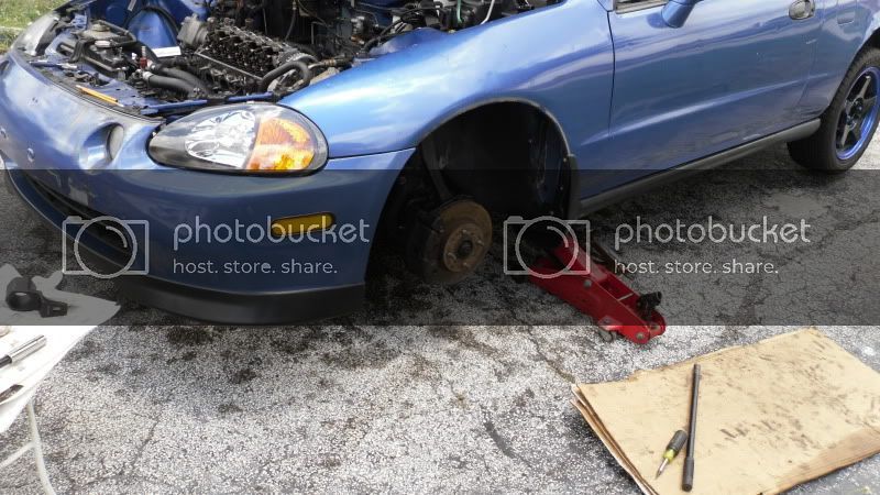

Woke up this morning with a postive attitute to work on my delly :)
Time to drop the new engine in.........SIKE lol

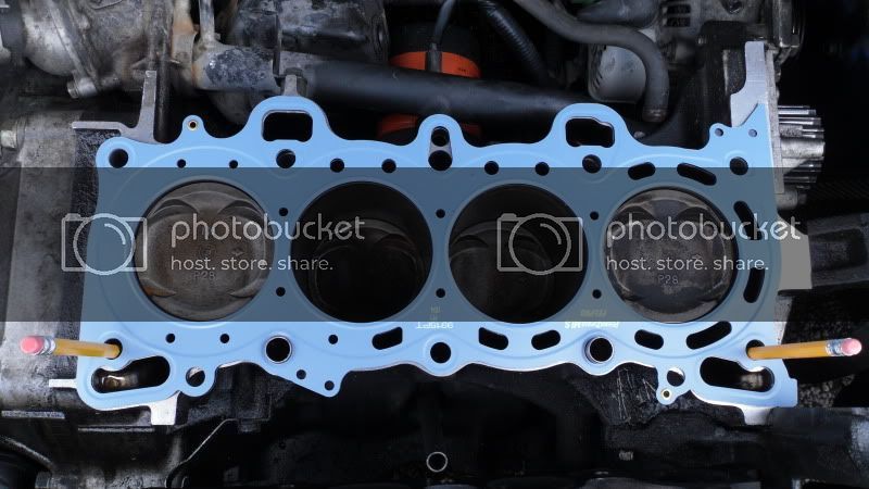

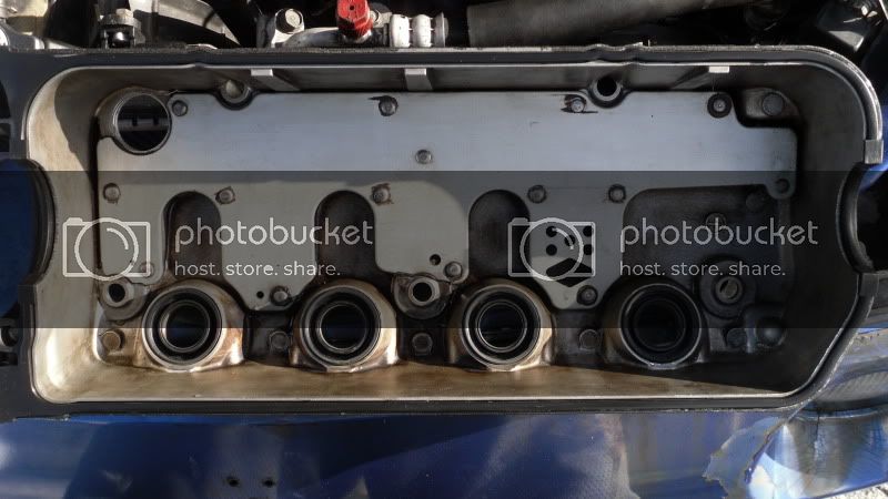

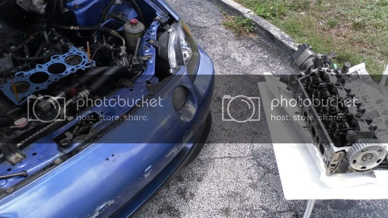

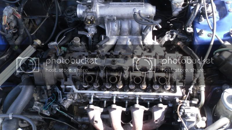

I made sure the engine head was as clean as possible this time.
Then put my new headgasket on. This one feels much stronger than the previous one I bought.
Then I tighten back the head bolts.
Random?
Anyways time to jack this bad boy up.

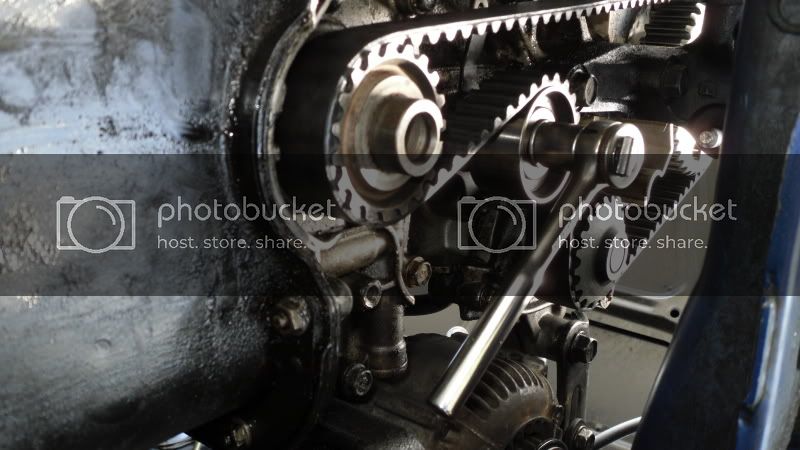

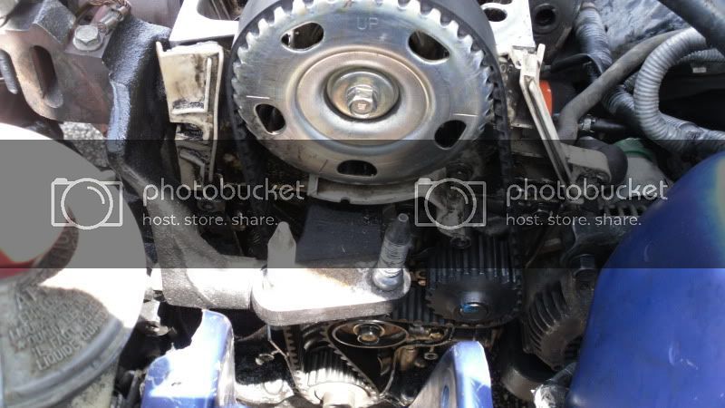

Timing belt is back on.
Tightening the tensior now.
Putting the crank pully back on.

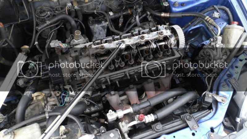

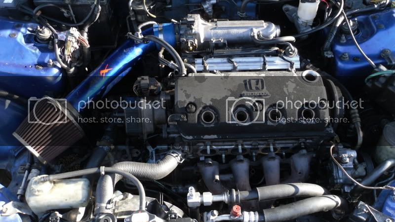

Got the Intake Manifold back on.
Cleaned out the valve cover that was mixed with coolant and oil.

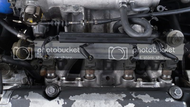

Put the fuel rail, intake, hoses & plugs back on.
Refilled it back up with new oil and coolant and engine is finish and complete!

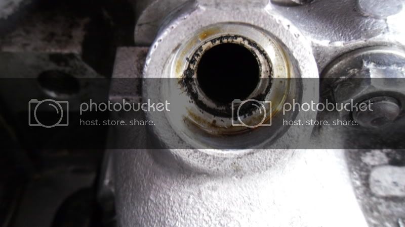

Then I tried to start it and BAM! a problem occurs. Gas is spraying out inbetween the injector and the fuel rail causing the car to turn over, but not start.
It's a easy fix though, but night started to come so I couldn't see anything so I'll fix it tomorrow and start this bitch up ^_^

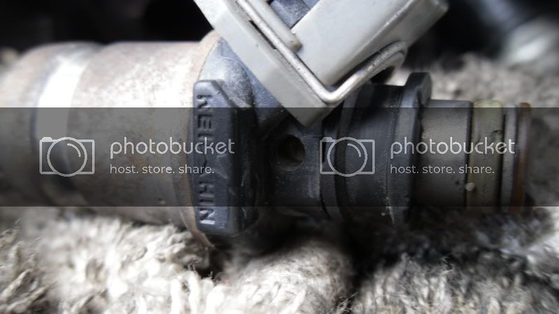

sometimes you have to get those injectors just right. when they are old sometimes the o-rings dont seal so great.

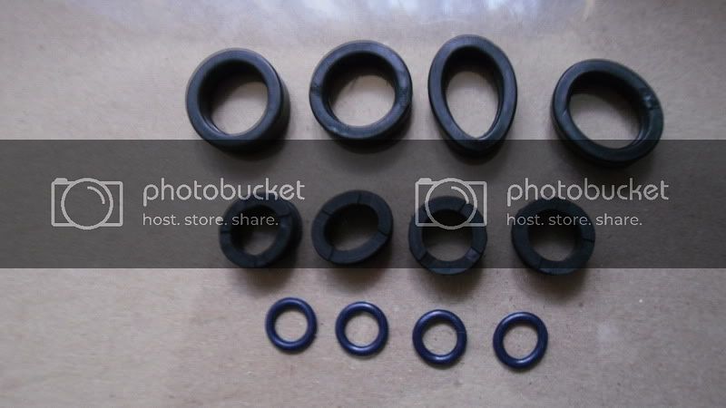

Solved my injector problem thanks to Mike aka "mdpsEG"
Found some new rings/seals in my room

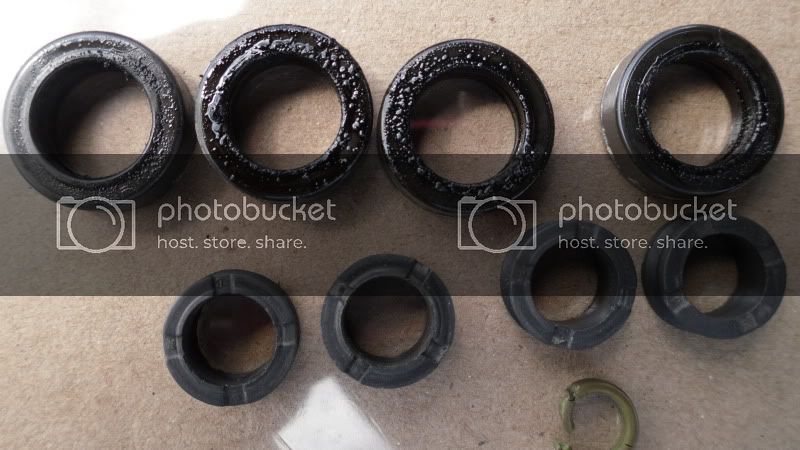

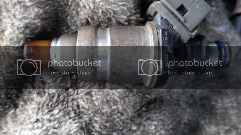

So went outside and started to get working on it. I took out the old seals and they were pretty much toast. Some of them actually popped when I was taking them off.

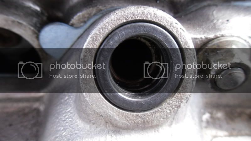

This is how the injector looked when I took it off.
And the bad seals
Then I replaced them with the new seals
And then put the fuel rail back on and it's complete!
Started the sucker up successfully and no more overheat or fuel squirting out :)

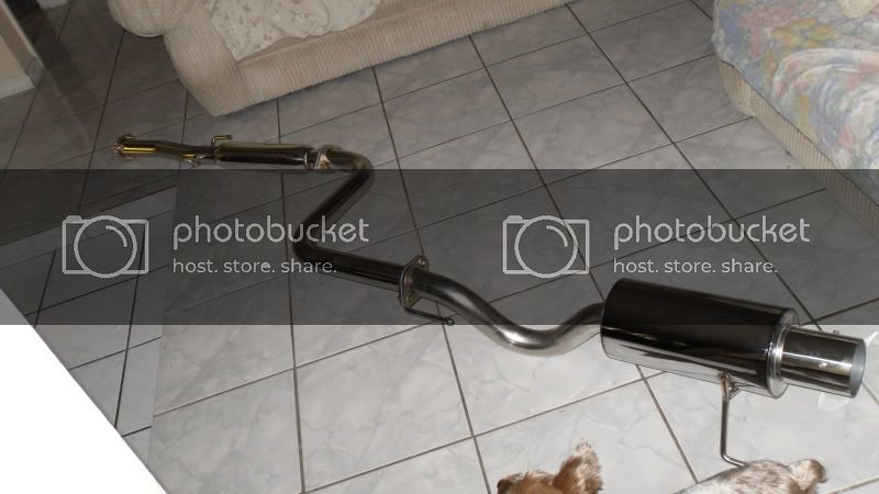

Came home from school and saw a box sitting in the living room for me.
Ohhh lala, a brand new exhaust.
Nothing special, just a eBay catback exhaust. Don't worry though because it's not going on the Sol right now. I mainly bought it for the 2.25 inch piping. The big shiny fartcan is going to get chopped off and replaced with a Vibrant or Borla muffler (still deciding). Also going to buy a Magnaflow 2.25 cat. It should sound pretty decent when I'm done with it.
But for now it's going back in the box till I get the rest of the parts. Should be on within the next 2-3 weeks though.
Thats a smart idea. How much $?
Only paid $90 bucks for it ^_^ It was actually $100 but I got a $10 off because I recently bought something from the same seller.
This beats buying some Skunk2 exhaust for $500+ bucks since thats probably the only brand that makes a full catback for the del Sol.
After I buy the Magnaflow cat and Borla/Vibrant muffler, my grand total should be around $260 for everything.

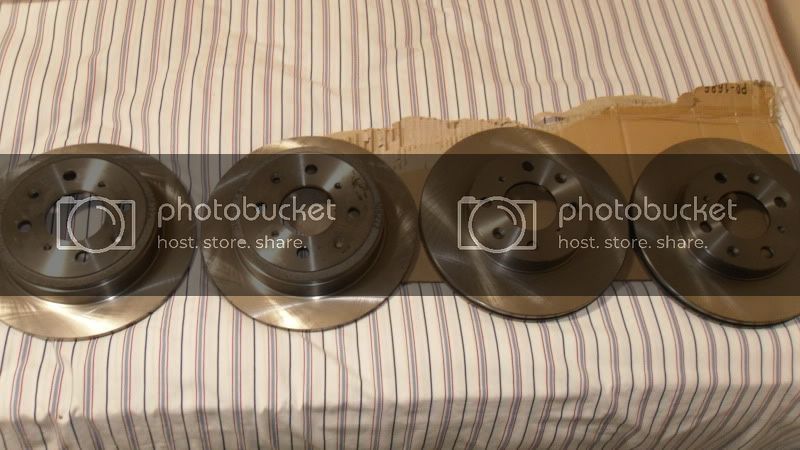

I rearranged my room today so I could have a dedicated corner for the parts I'll be getting soon and the ones I have curently lol.
Anyways I just remembered I had these laying around. There going straight to the parts corner ^_^
