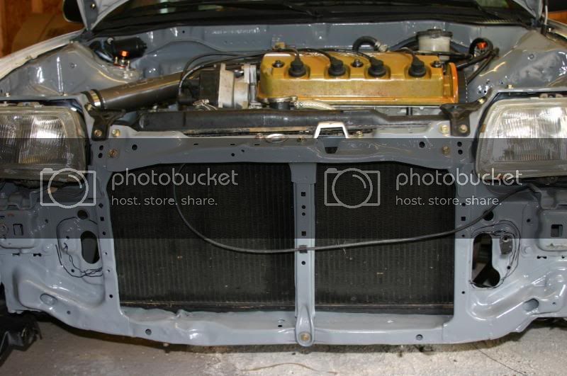

So I can't get this 'turbo fever' out of my system so I went to work today, fooling with the intercooler. I'll keep it brief (as I took a LOT of pics).
I will have to buy a new radiator. I'm going to buy this one:
eBay Motors: CXRacing Radiator Civic DEL SOL 92-00 D Series 12" fan (item 320281082246 end time Aug-06-08 17:56:54 PDT)

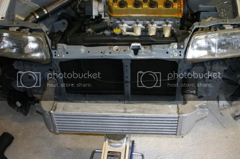

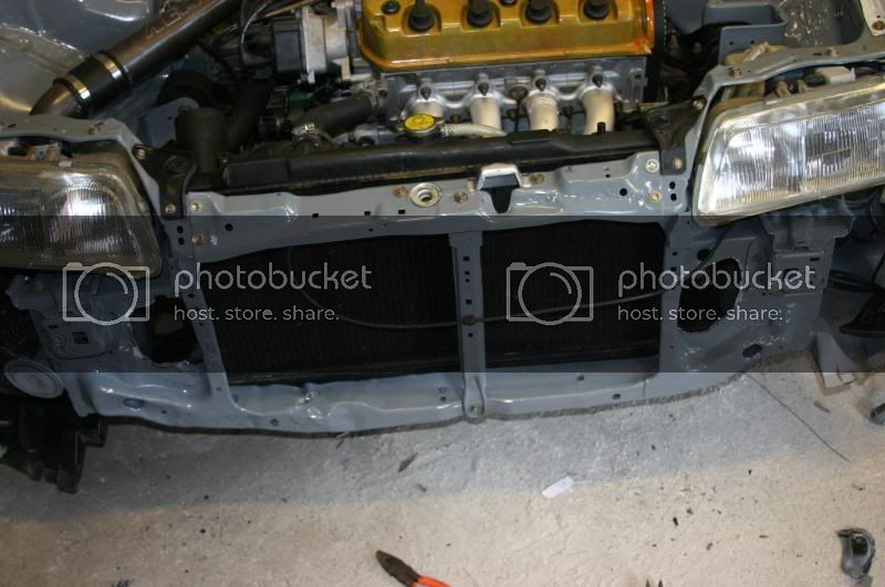

Heres 'what I got'.
Oh yeah!

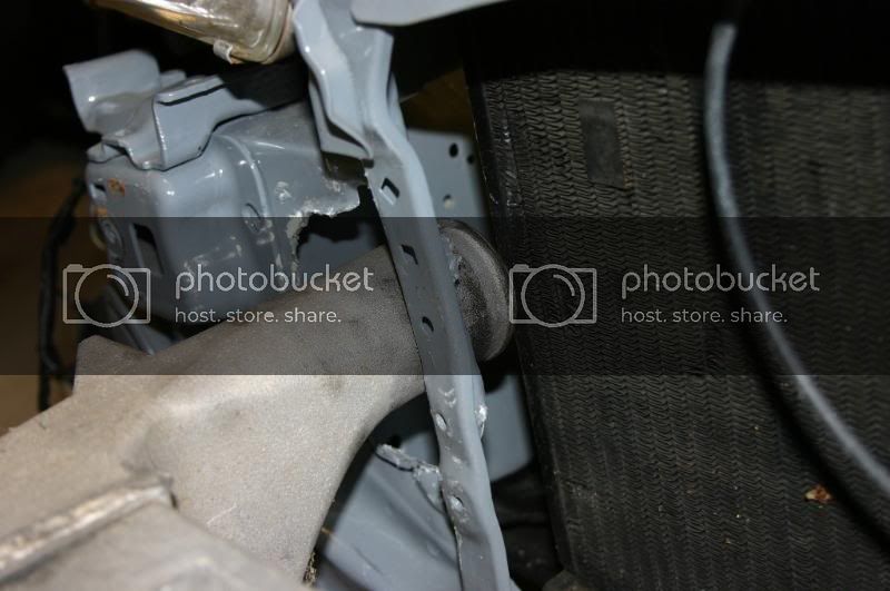

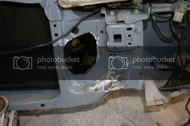

As you can see, its a tight fit. gotta make some cuts!

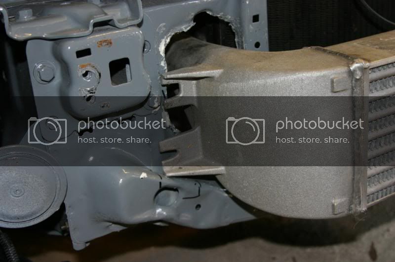

Unfinished cuts (no filing yet):

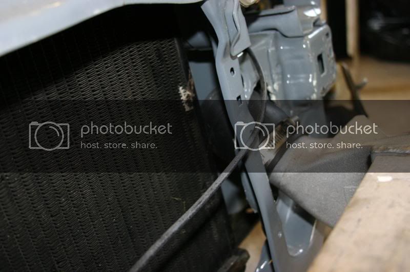

This is why I need a new radiator: We're talking 1/2".... GAH!

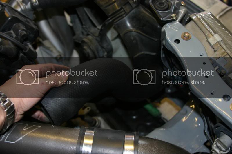

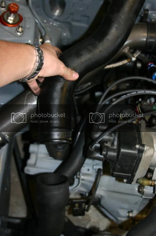

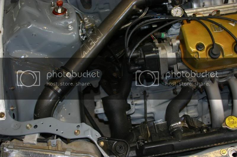

Heres how my cold side piping will be routed. (VERY simply and I had all the parts laying in my shop! hooray
This S bend will pick it up to the topside.
Another angle:
Then I'll cut this piece and use about 45* of it for connecting the upper section I already have.)

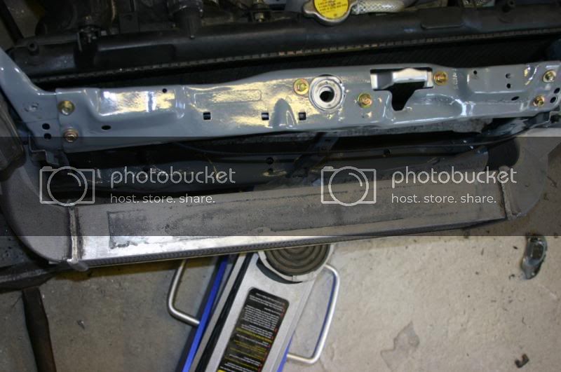

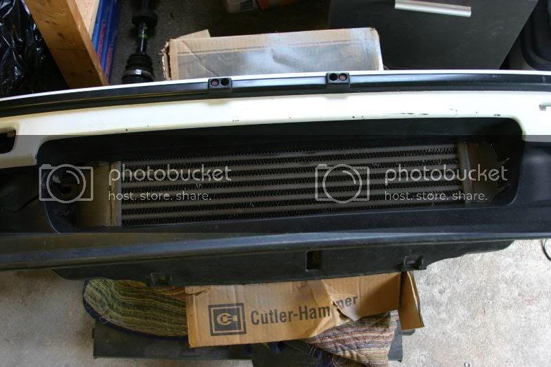

I thought it was kinda cool that these bolt holes will work pretty well: Keep in mind this is a SRT-4 intercooler.
But I had to get creative with some excess bulging metal. (This took a lot of carefull thought and planning!)
The only thing bad about this setup is How far it comes forward from the mounts...
I was hoping to get a new fresh bumper (from Korax) and be able to install it w/o cutting the front grill. Doesn't look like it'll fit with the stock grill. Luckily mine is already butchered so I'll 'practice' with it. If/when I change intercoolers, I can do it differently.

Wow the stock SRT intercooler fits nearly perfect, and seems to be properly sized, where did you pick that up from?
Locally, off Tallahassee's Import forums. I paid $40 for it! :o
