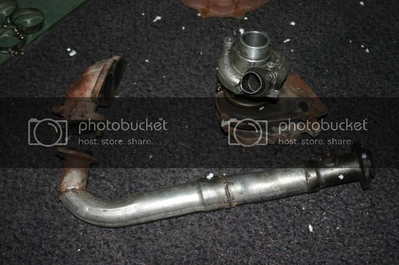

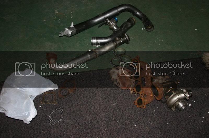

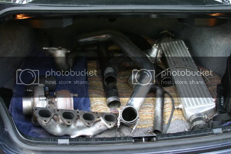

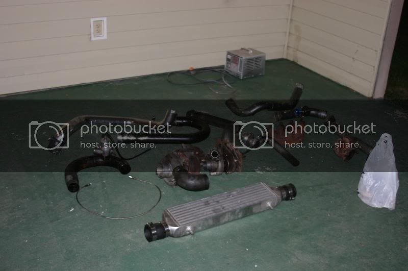

Heres my stuff! (I was suprised at how crappy/HMT the Downpipe and charge pipes were. lol. OBVIOUSLY I"M NOT USING THEM!
The box:
Whats in it:
Welded plate

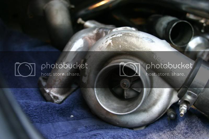

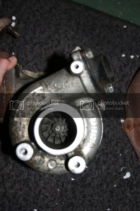

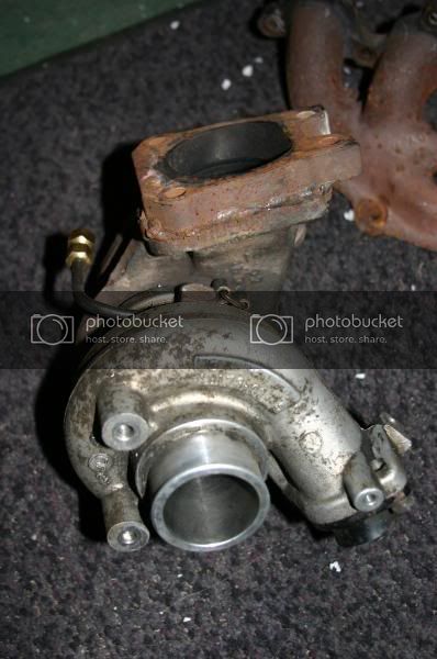

Blurry, but you can see from this pic that it's a 14b (14 straight bladed compressor blades)

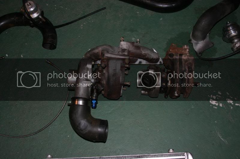

BTW I picked up this kit for Terrance while I was in ATL.
Both of 'em together:

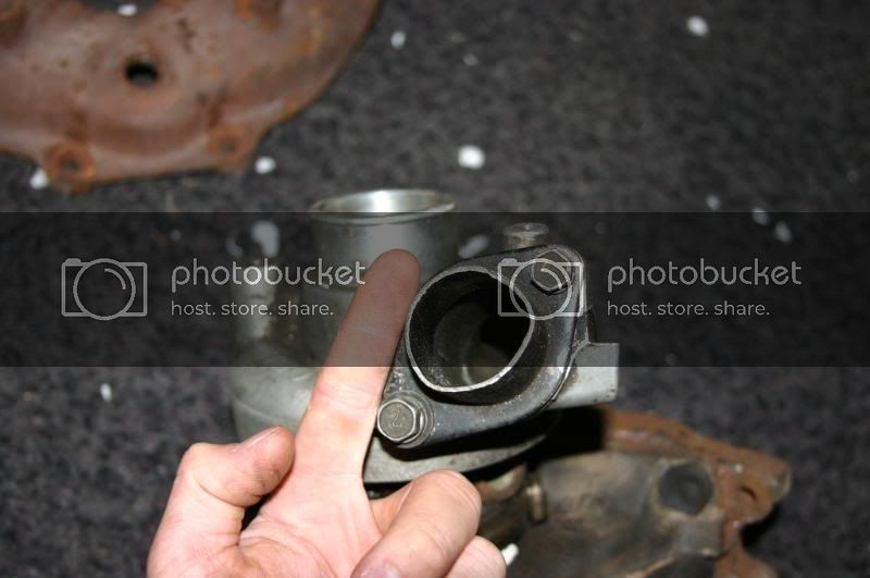

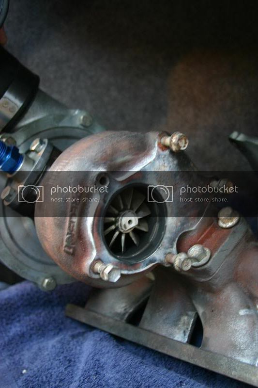

So basically I need to get my hands on a wastegate actuator.
Anybody know which ones work and don't work?
And, what should I do about the output (compressor) being so small? Is the piping that small on DSM's or what?!? 1.5" just won't do. I could just run a reducer-coupler but I mean,... geez... What should I do?

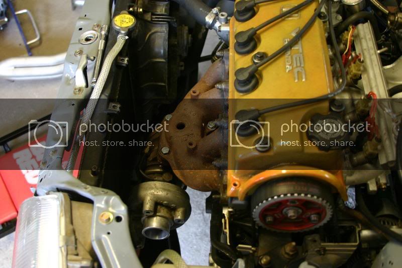

Oil line will be a sinch!

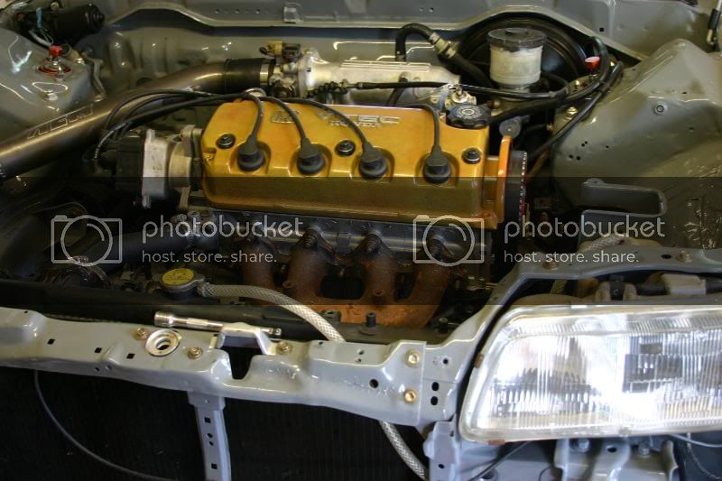

Heres my main problem. I need to find a tight radius bend that will make this bend:
(2"- 2.5" dia. piping)
(And no, I didn't do this to my radiator on the install. It's just from all of the engine swaps....)
The thought of a piecut crossed my mind... What do you guys think would work here?

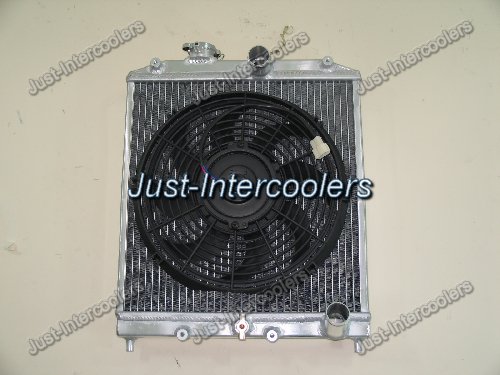

I've heard those lil thick radiators work a lil too well... yoru car cools off bigtime once you get rolling down the road.
And the problem with aftermarket radiators usually isn't leaks, it's fitment. I was thinking about going to a half radiator myself.
You can use that extra room to mount a fan to blow right on the turbo.. help keep it cool(er) and for it to cool down quicker when ure done playing.
And that clear tubing stuff... I dunno. It woudl heat up bigtime from the turbo and expand, eventually busting ( so I would think).
There's a reason why you don't see that stuff on turbo builds too..... My .02.
