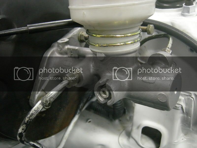

Got the brake line taken care of. Went to Car Quest and they hooked me up.
It was my first time flaring, so I'll be suprised if it doesn't leak!
Will talk to KMS again tomorrow.

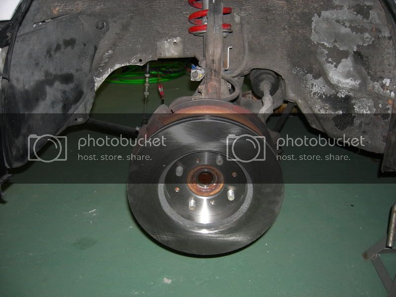

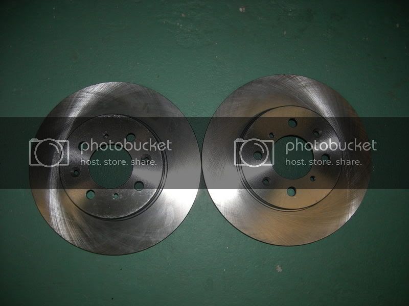

And I picked up some brake rotors today. EF EX rotors, but I didn't get the Legend Calipers because I couldn't remember which one I needed to buy.
My ideas for my brakes up front are Legend calipers/pads, EF EX rotors, SS lines. Then in the rear I'll throw on some DA rotors and calipers, and SS lines. All to go along with my 1" DC MC.
Can anybody refresh my memory as to which year/trim Legend calipers I need to buy? I'm thinking 1995 Legend Sedan, but am not sure.
Thanks
-ANdrew

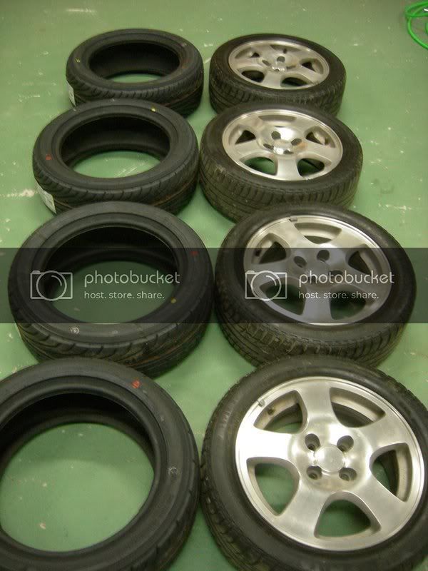

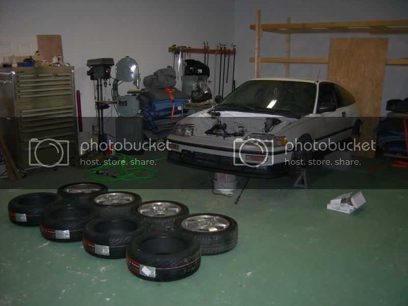

I've got some tires to get mounted(I've had them for a while, but decided to go ahead and do them this week) 195/50/15 Yokohama AVS ES100's.
And I picked up some 10.3" rotors to fit under the Legend calipers(will buy tomrrow)

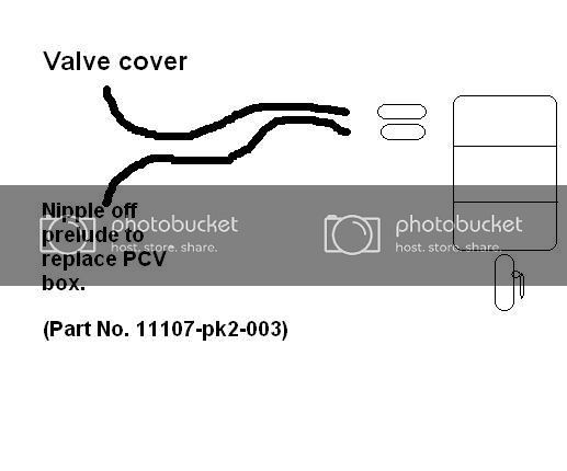

Speaking of pipes, I picked up some goodies to play around and make a homemade catch can!
Shopping list is as follows:
(2) 1/2" x 1/2" hose barb $1.44
(10pk.) 7/16"-1"hose clamps $5.72
(6') 1/2 ID braided PVC tubing $4.92
3" x 5' S40 PVC piping $7.07
(2) 3" PVC CAPS $5.16
= about $25. I still need to get a drain valve. (like $8)
Heres my plan:
Any tips I should know about?
I'm thinking of sticking some steel wool or something in there to trap the oil.... ?
That looks good to me. I wouldn't worry too much about the steel wool. I actually had my catch can draining back into the block- the lower fitting was low enough that the oil could go back into the drain plugs in the back.
Huh. That would be a good idea, that way I wouldn't have to buy a valve to manually drain it.(actually wouldn't ever need to touch it at all..?)
I mean, I can make the bottom drain hose as long as I want, so maybe I should consider doing what you did. Could you elaborate a little bit on which plug I'll be needing to drain to?

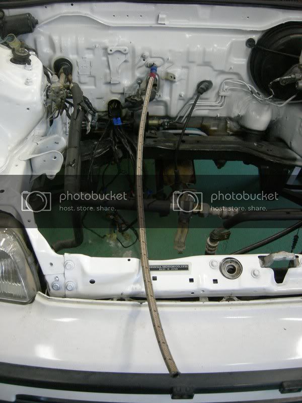

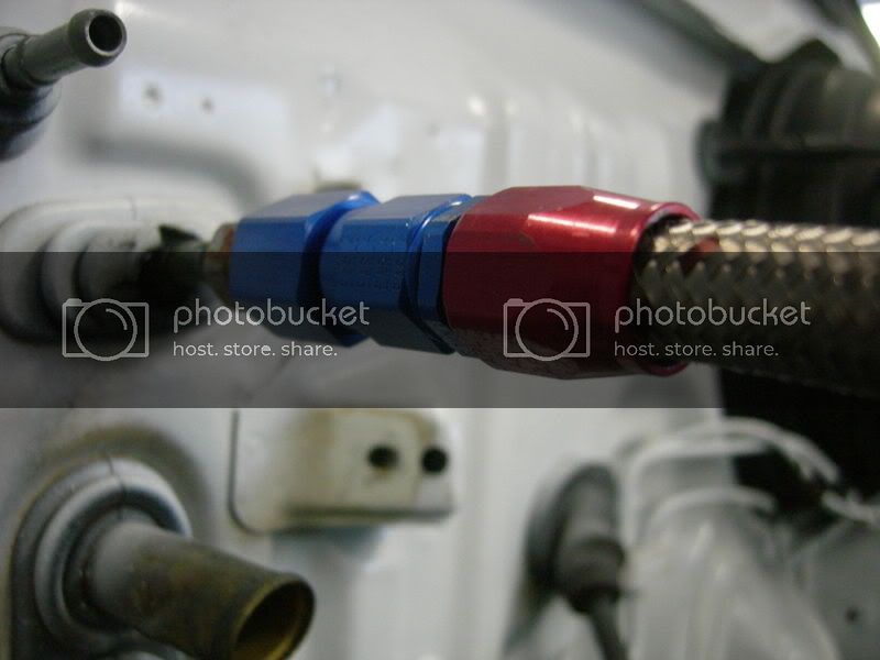

Got one end of the fuel line done. I can't do the other side because the motor/manifold isnt in for me to measure...
Yup, I never had to touch the catch can once it was hooked up. The filter on top let it breathe so that it wouldn't have to be drained or have pressure relieved from it.
The plug I'm talking about is the giant brass plug on the back of the block. I don't think I have a picture of it, but there are 2 plugs on the non-VTEC blocks. The GSR might only have 1- the other is where the black box sits I think...
Well, I'm in the process of buying that prelude nipple to replace the black box to go to the catch can. Oh, and remember, this a A6 block.
I guess I'll have to figure out a way to incorporate a filter on the top of the can somehow. won't be hard, just got to find a filter.
Couldn't you rig a fitting into an OEM oil filter and use that as a catch can? It'd be supa cheap and stock, eh, sort of...
