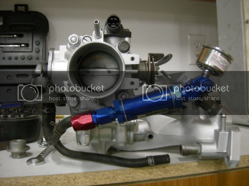

so how did you manage to not light you car on fire dremeling a fuel line? lol. what you did works, but technically not correct. i modded (well had someone else mod) the stock fuel fitting with an -AN fitting. and just screwed the lines onto that. but i used the black fuel lines and fittings. looks sick.
I know. I could have just cut the entire fitting off, slip on a B-nut and a -6AN tube nut, and re-flared it, but I decided to do it this way.
I think I'll eventually run a different setup(perhaps a -6 line all the way from the fuel tank, but not in this car. perhaps in a track car thats stripped out and stuff...

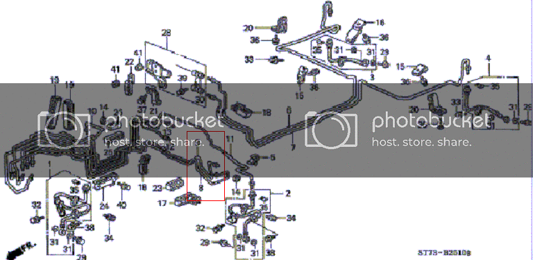

I need the fitting on Brake line #9- Part 32930 on here
However, I don't want to order the entire line just for the stupid fitting for the MC.
Does anyone have one?
It's the fitting on the PASSENGER side of the MC (on a 94+ integra). It's slightly bigger than the one on the drivers side.
Much love and $5 shipped if you do!
Anyone have one of those fittings, or at least know where I can buy one? Theres NONE at the local junker.

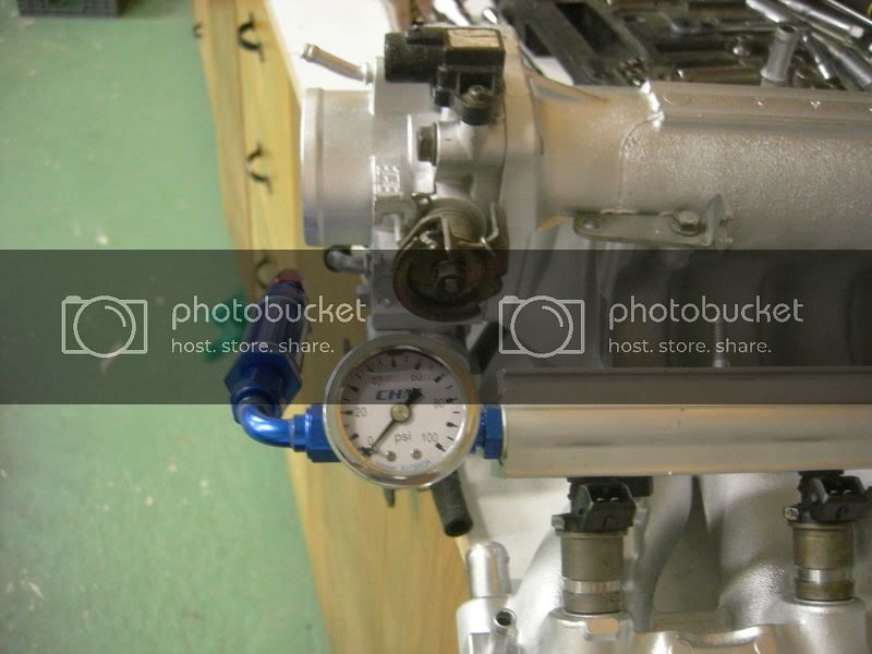

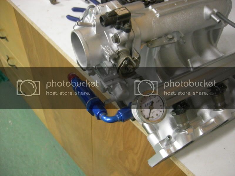

Got my fuel rail taken care of.
It would be ideal to have a 45* Hose fitting on the end, but it will hopefully work. Otherwise I'll have to shell out the $20+ bucks for it...

The best way to do it is to just cut the line off, slip off the stock fitting, and slip on an AN tube fitting and a B-nut(sleeve), and do it that way. I just did it this way because it's way easier.
Hopefully I won't have any leaks.

Pics of the AN tube and B-nut?
