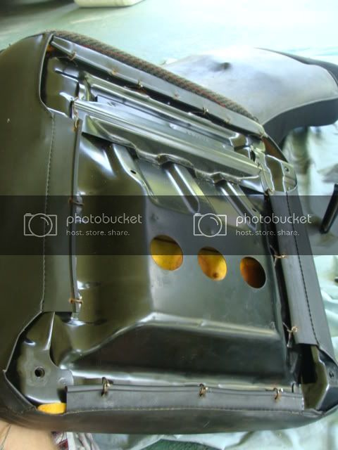

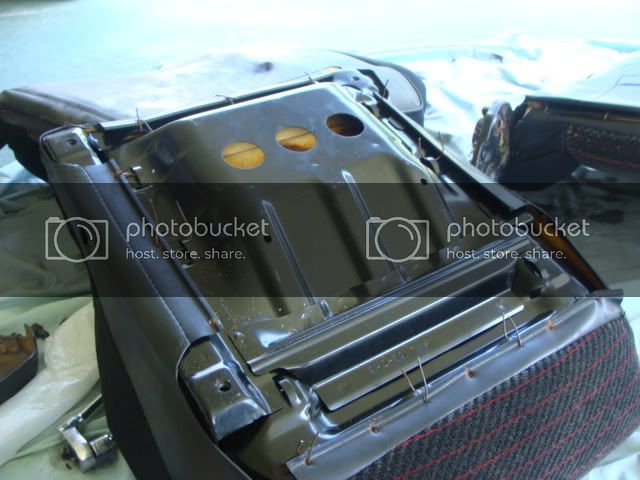

Get your seats-

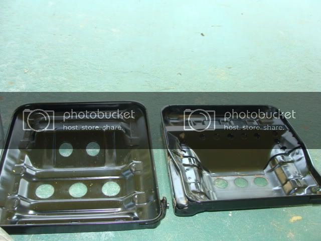

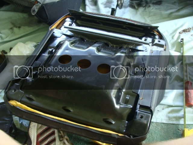

Flip it over and see the reason for the pan swap. The bolt holes are different, therefore it won't work in our floorpans. or at least mine!
USDM Seat:
JDM seat:

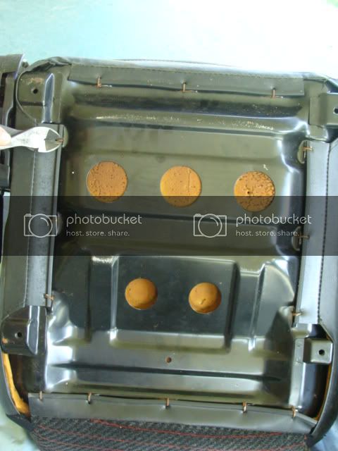

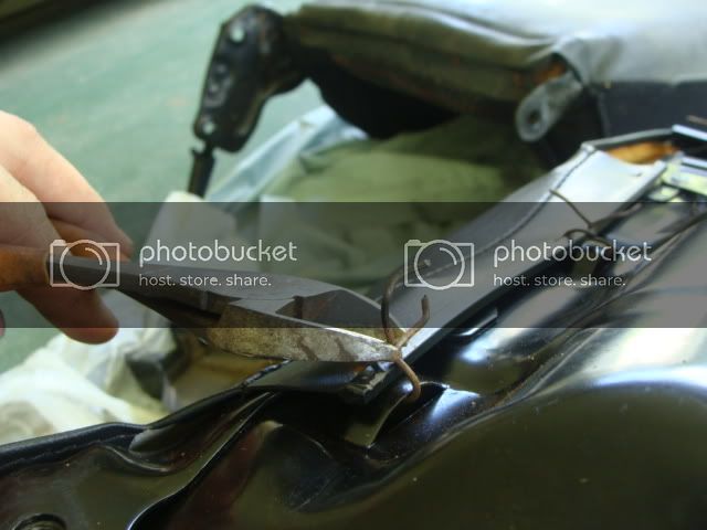

Cut the hog rings-

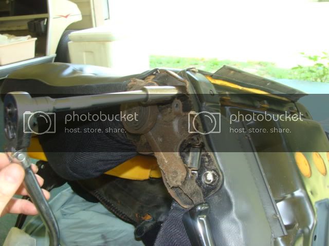

Use the 14mm socket to pull the 2 bolts off this side of the seat.
There is a 19mm bolt on the opposite side of the seat, remove that too. (no pic, sorry.)
It'll come right out with a little motivation:

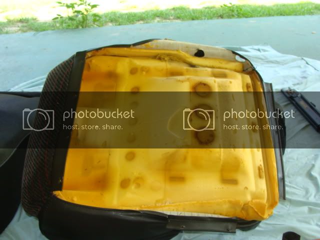

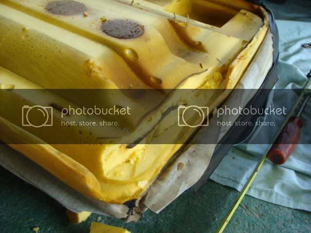

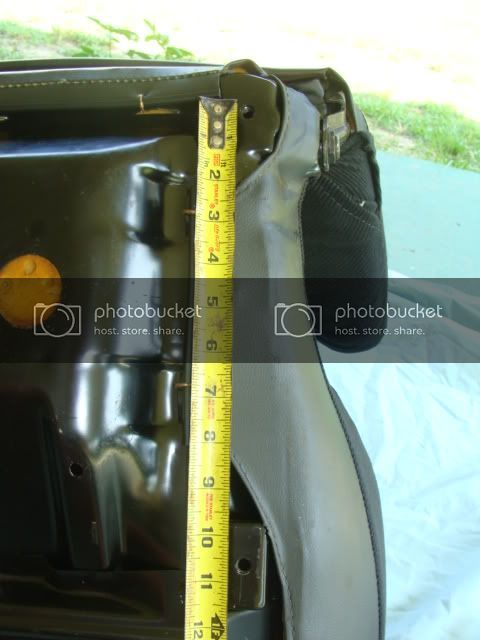

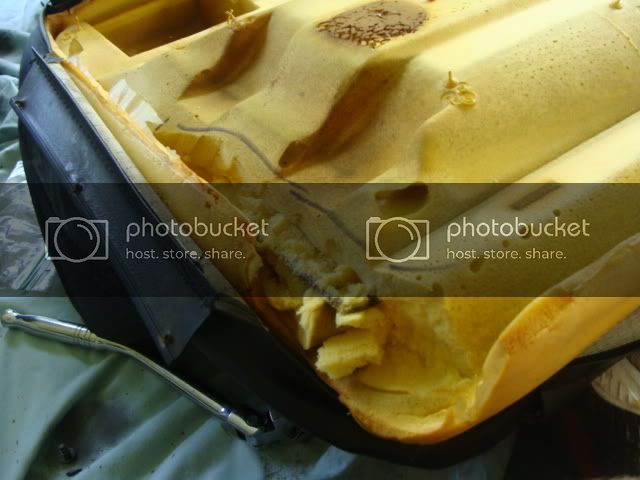

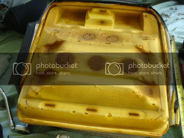

Notice how the JDM seat (Left) is square, and the USDM (other left) tapers at the back. Gotta cut the seat foam a little bit to make it work:
Mark it:
Cut it. Carefully...
It ain't pretty, but it works.
USDM pan installed onto JDM seat bottom:

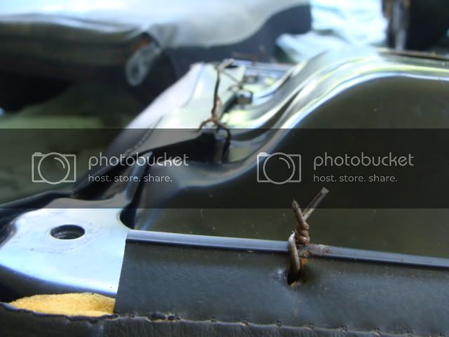

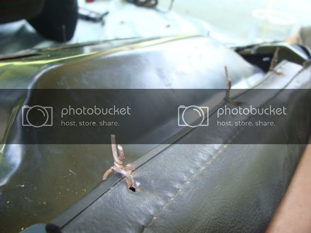

Use new hog-rings or utility wire and slip it through the holes.
Tighten them down:
Trim the excess:

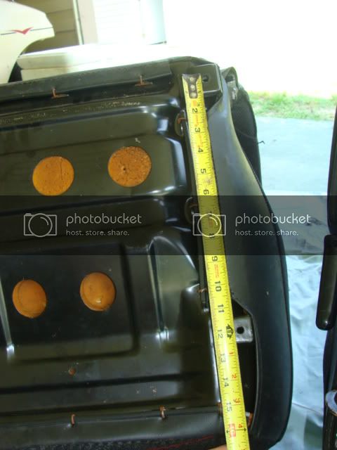

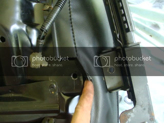

I needed to cut a little bit to make this track mounting bolt:

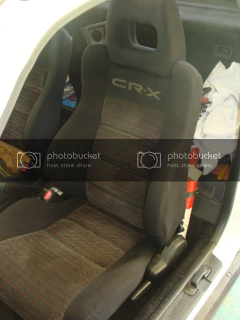

Finished!
Car is cluttered, moving parts from 1 place to another... but you get the idea:
Not so bad! I've never done it before, and it took about 30 min to do it all.

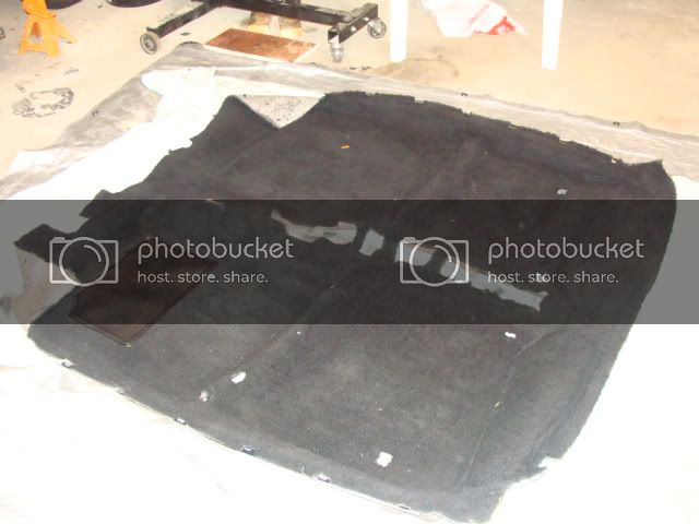

Also, I recently dyed my carpet. Used DupliColor's Vinyl and Fabric (Gloss Black) and after vacuuming it like 3 times (out of the car, of course...), I went ahead and just sprayed it. It took 1.5 cans to do the job. Great stuff!!
Old pic: (Before)
Dyed:
In car (still installing interior...):
