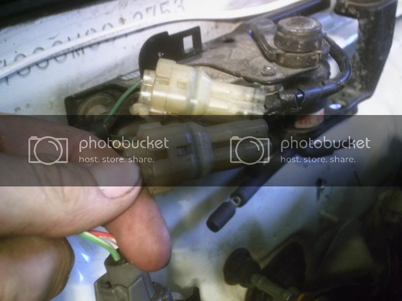

the green plug is for your vtec oil pressure switch. and the other wire coming out of the grey vtec plug does go to the ground
did someone that was helping ou pull the old engine have a cold//allergies//etc??
left plug looks like knock sensor
middle is vtec oil pressure sensor (ground the wire with the ring terminal)
right is vtec
the 2 pin plug your looking at isnt going to be used for your setup
Thanks bro. thats exactly what I needed to know!

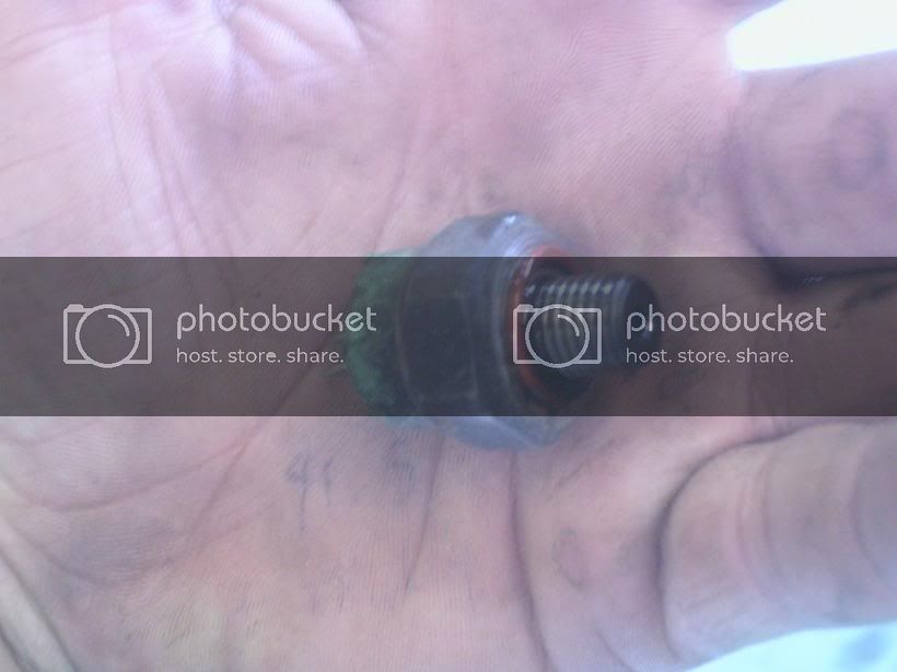

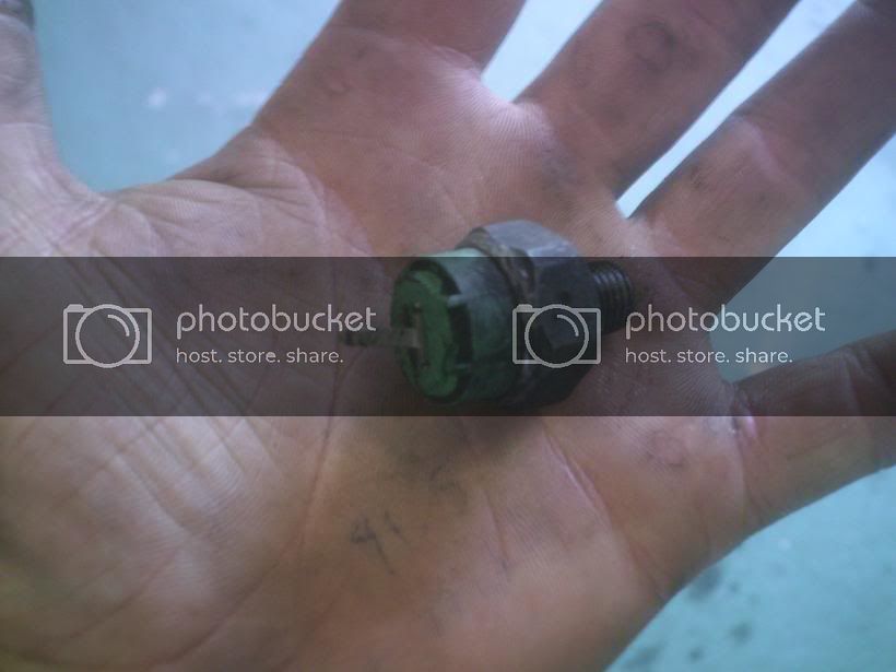

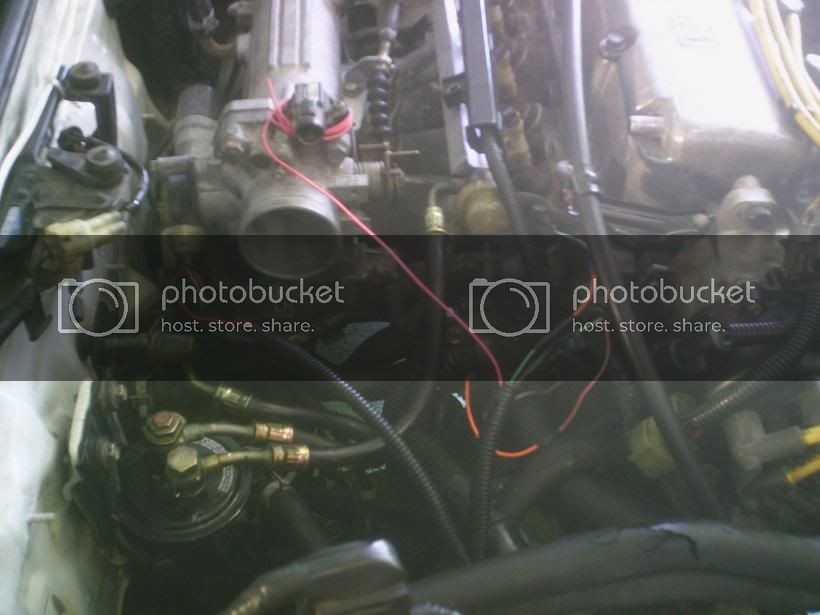

Update 6/23:
Last week during the install my rachet slipped and broke off the plug on the vtec noid.
And I took a picture of that strange looking plug.
the only other plug I can find thats like it is on the emissions crap(held it up next to it). Anyone know where it goes??
Cypher suggested it was the Knock sensor.
Where do i plug it into? I've been looking all over but can't seem to find a plug for it.
And where does my Vtec plug go? I thought it would be that Green/white wire from the vtec selenoid, but it has a cripped end, and my vtec harness has a plug...
should I pull the crimper thing off, and insert it into the other side of the long plug, so it lines up with the wire?
-Andrew
Aight. Thanks bro.
I can get around buying a new one by just connecting my vtec wire(from my harness) to the green wire, just by cutting it and throwing a male connecting clip on there, right?
So instead of a grey plug, I'd just have the little connector.
That'll work right? dont see why it wouldnt...
-andrew

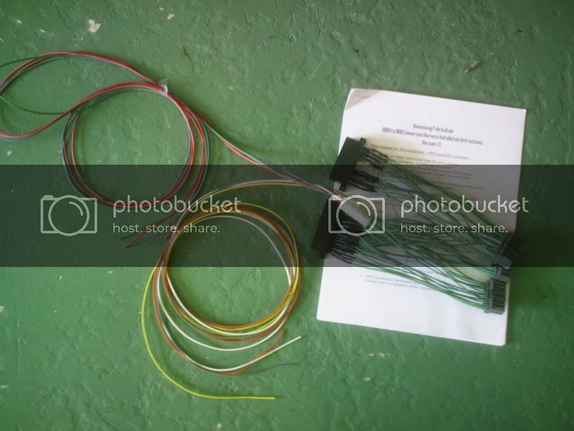

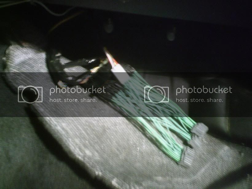

Update Evening of 6/23
Got my Boomslang ecu harness in. MAD props to those guys. everything was so easy and coordinated, VERY easy/simple installation. HIGHLY RECOMMENDED!!!
What I've got sofar(finished 'cept for the secondary intake sensor- pink wire)
ECU GETS HERE TOMORROW!!
Should try and fire it up tomorrow if I can get an o2 sensor in time...
till then
-Andrew

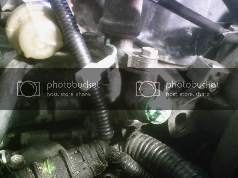

Not that it matters since you got a conversion harness but..
OBD0 vtec harness's came with the square single wire vtec plug so how you have it plugged up on the firewall isnt right. your vtec plug on the motor itslef was cut so it wouldnt be used anyways.
since you said you are running a b16 the 2ndarys wont be used. those are for h22 or gsr
you also dont have the map sensor plugged up or the vac line ran.
you need to unplug the map sensor on the firewall (round 3 pin plug in 2nd pic) and plug it into the map on the throttle body (less to mess with instead of running the vac line to the intake from the firewall map)
