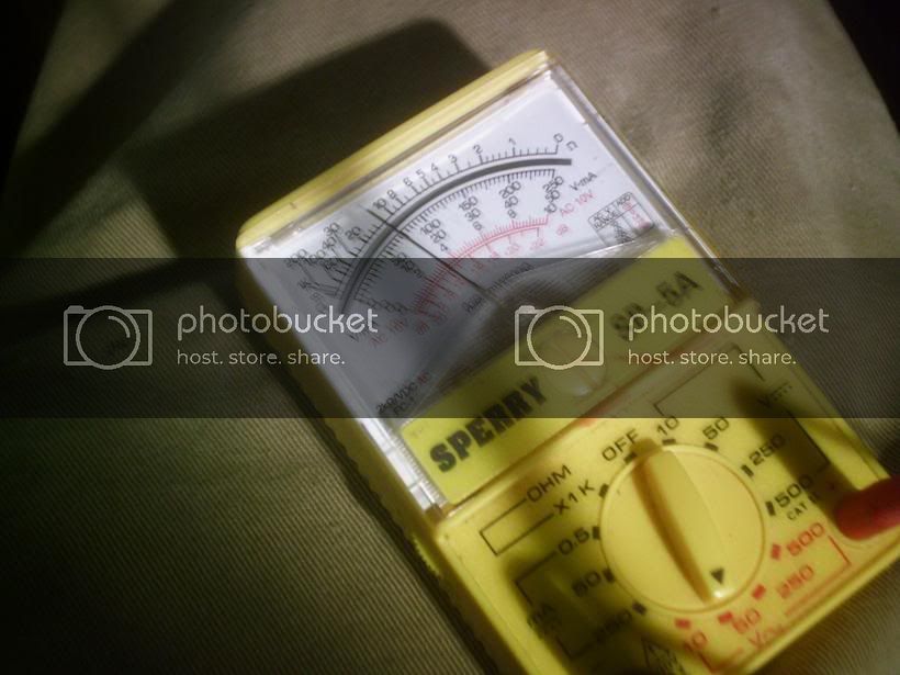

Today I Pinpointed the problem.
Bad fuel pump!
Multimeter says it's got power going to it-
I'll pick up a fuel pump today and try and get it in there.

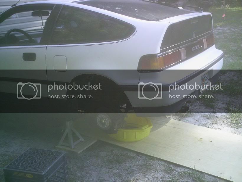

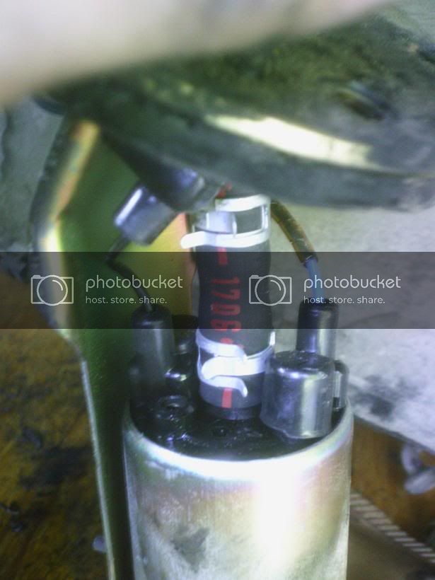

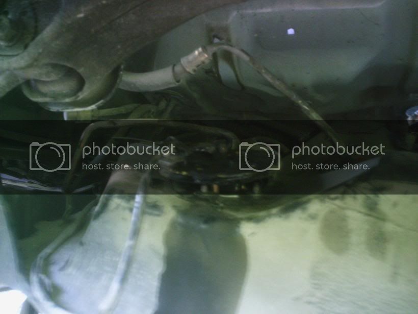

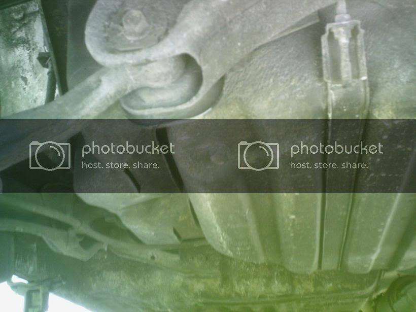

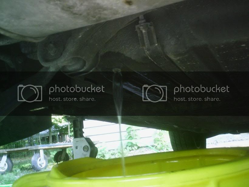

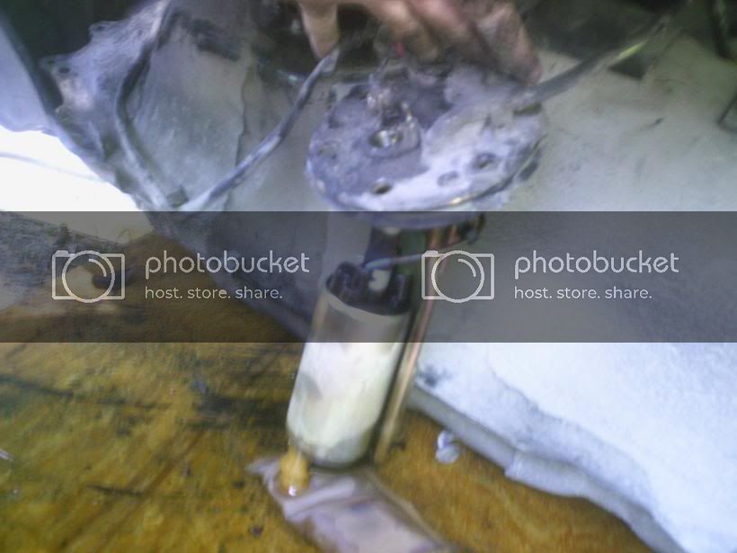

This Tuesday(july 4th) i went to the shop and picked up my car, after plugging up some more vaccum lines and the Map Sensor. We traced the lack of fuel pressure back to my fuel pump, so I bought a new walbro 255, and it should arrive today sometime(hopefully this morning).
Heres some pics of the tank drain (needed to anyway. it was full of '87' octane, and i'm running 11.5:1 comp....) as well as the fuel pump removal. (my first time. it was actually a lot easier that what I was expecting, but still time consuming.)
Hopefully I'll be updating you guys tonight with the installed fuel pump, as well as the car starting up(cross them fingers!)
Is there any prep work I need to do on the new fuel pump? Is it just a drop in deal? no manual priming needed?

BTW fellas I got the new Walbro 255 in there, and it's purrin like a kitten(the pump). However the car is not running.
