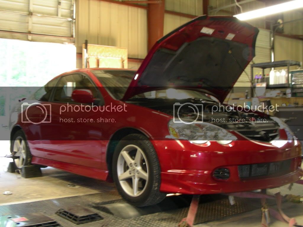

But my buddy in his DC5 did, got a baseline run of 171whp/~126wtq.

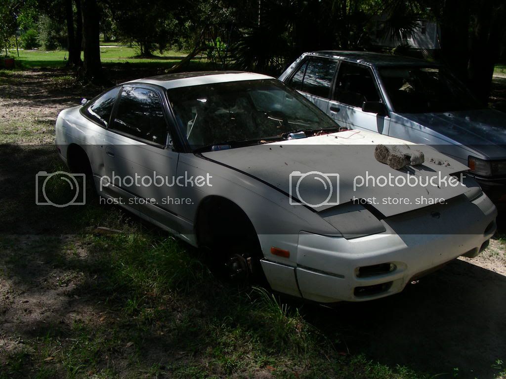

Then around lunchtime we got to work on my 240sx project. We pulled the 4.3Vortec out of "spongebob" (1970-somethin Chevy Chevette lol... 1500 or so LBS with 210hp v6 = FUN)
I've got thursday-thru-tuesday off of school this week(end), so the plan is to trailer the 240sx back to my house and I'll get to work welding up all of the holes in the engine bay
Wire-tucks/shaving ftw! I'm excited! I've been looking forward to doing a full shave on something... and now's my chance.
FYI I'm pretty much decided on a Battleship Grey color scheme for it.

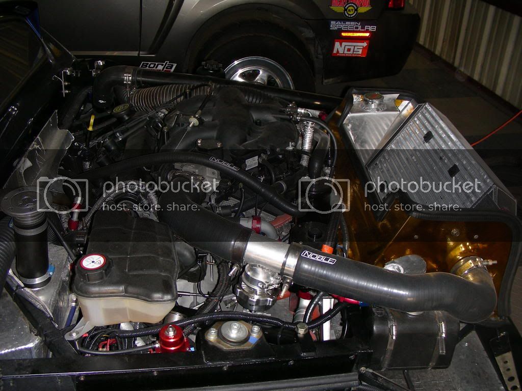

This one put down over 1100 HP I do belive the last dyno day.

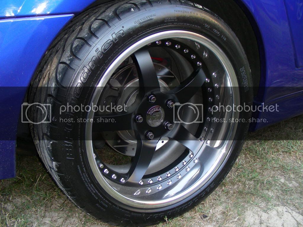

Check out the lip on this mustang's wheels...

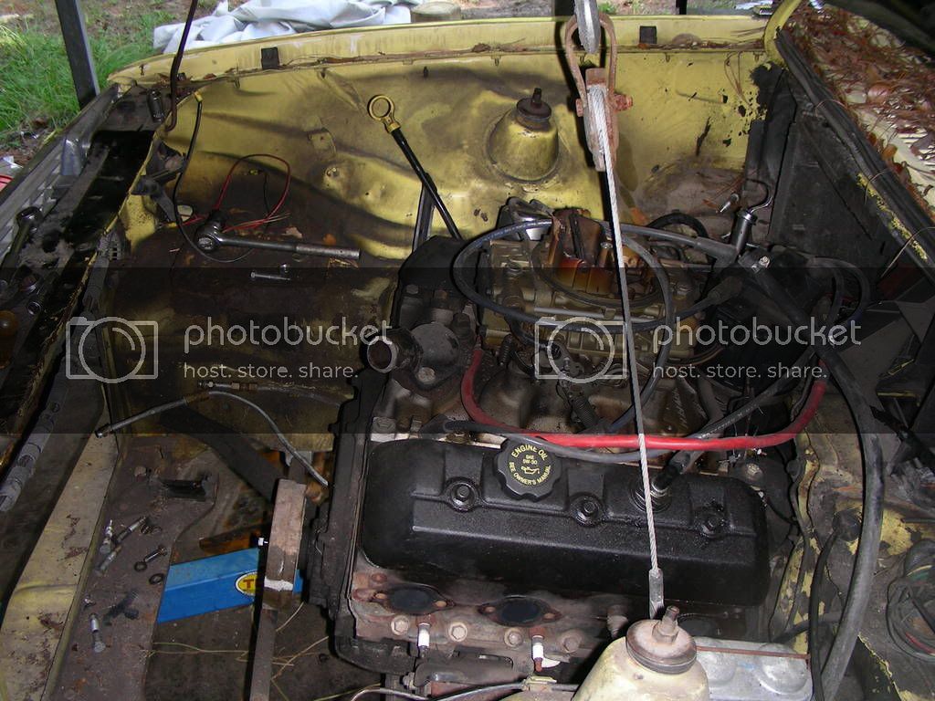

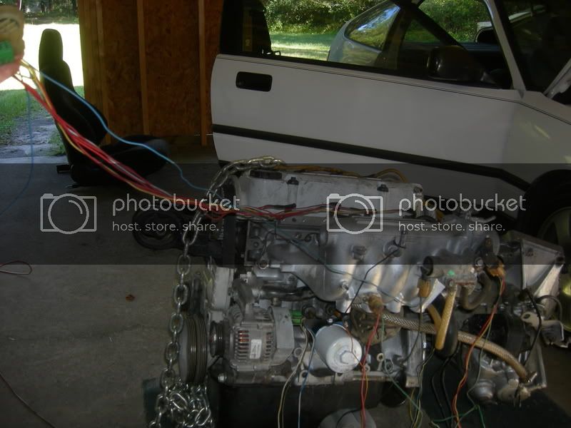

The engine in this:
Into this:

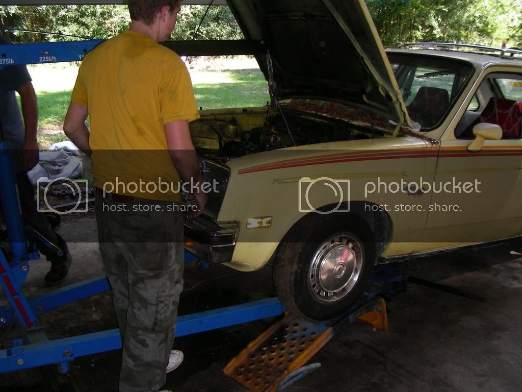

Some pics of the pull.
What better way to move the ramps than with an ax :)
Gotta have a thumbs up!
And it's done. Andrews gotta get the 240 and then the real work will begin. More on all this as it happens.

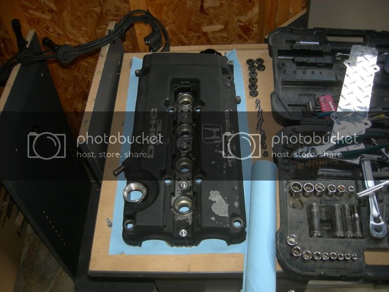

I've also started on my valve cover. I got it off and ready to start sanding the letters off(yeah I'm gonna shave it) and paint it.

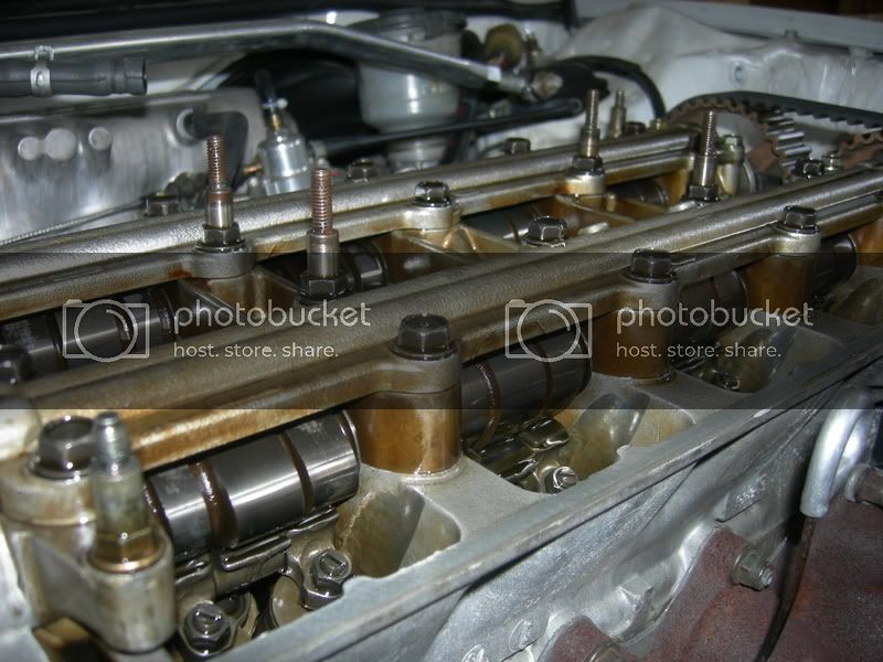

Then I pulled the cover off to see what she looks like underneath.
Looks pretty good! It's obvious it doesnt have a lot of miles on it. :thumbsup:

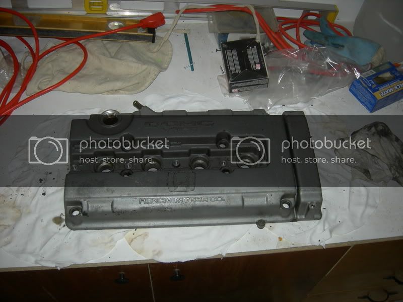

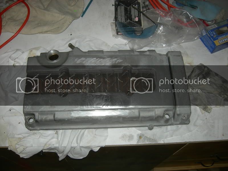

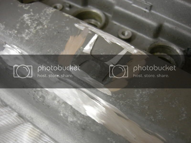

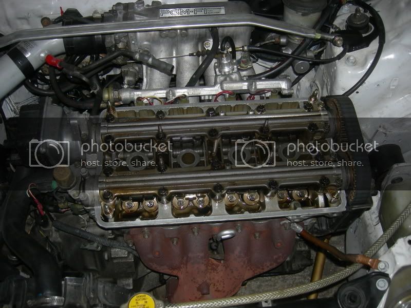

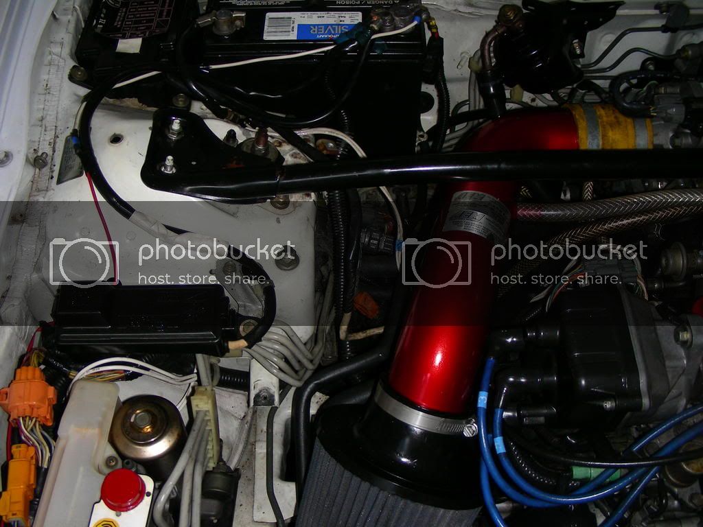

I did this last night. I've still got some sanding to do, but it's looking good, so far.
I thought about leaving it like this...
But then decided to go ahead and do a complete shave.
And this is how I left it...
Like I said, I've still gotta do some more sanding, but didn't have any good paper around. Probably going to do a 600, 800, 1000 combo and it should be good and ready for paint. Color? idk.

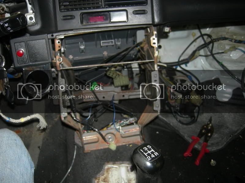

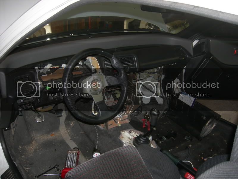

Also got some work done on the wire-tuck:
-Gutted AC/fan assembly.
-Working on getting dash out then removing heater core. (it's FL, I'll just wear a sweater... lol)
-Then I'll block off the heater hose ports on the engine.
-Then I'll start running the wires. I'm going to make the harness come out of the heater hoses hole.
-Then the interior will go back in.
Let the tear down begin!

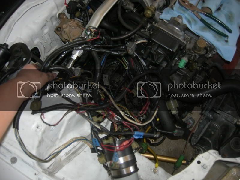

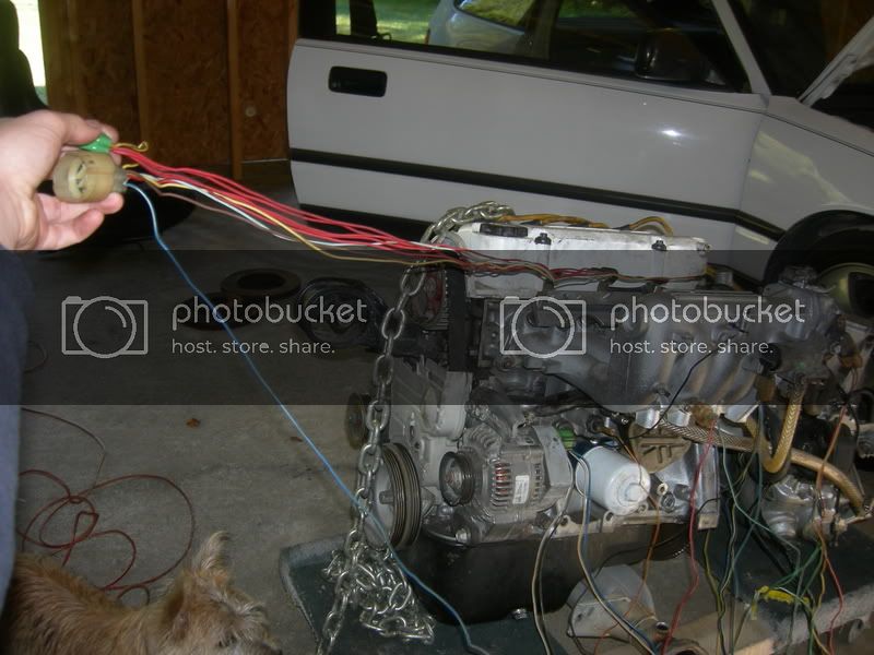

Using the D as a mock-up. I'm not cutting any wires, just depinning/rerouting them cleaner and more easily tuckable.

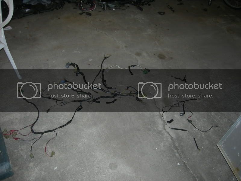

Got the old harness out >>
POOF

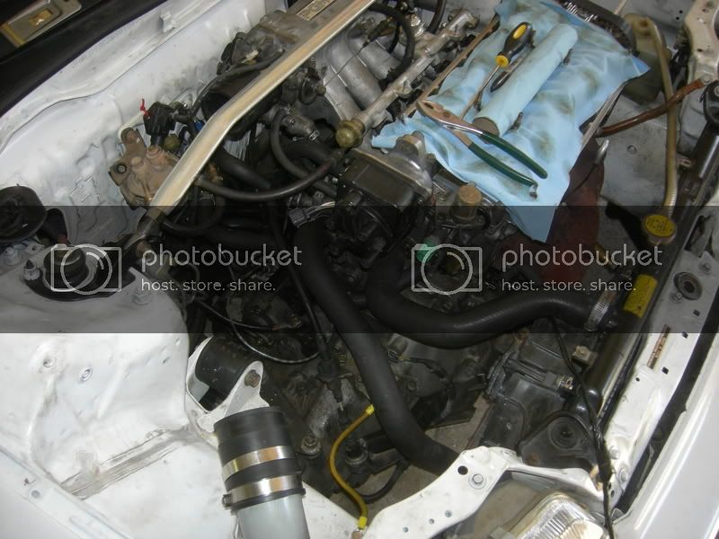

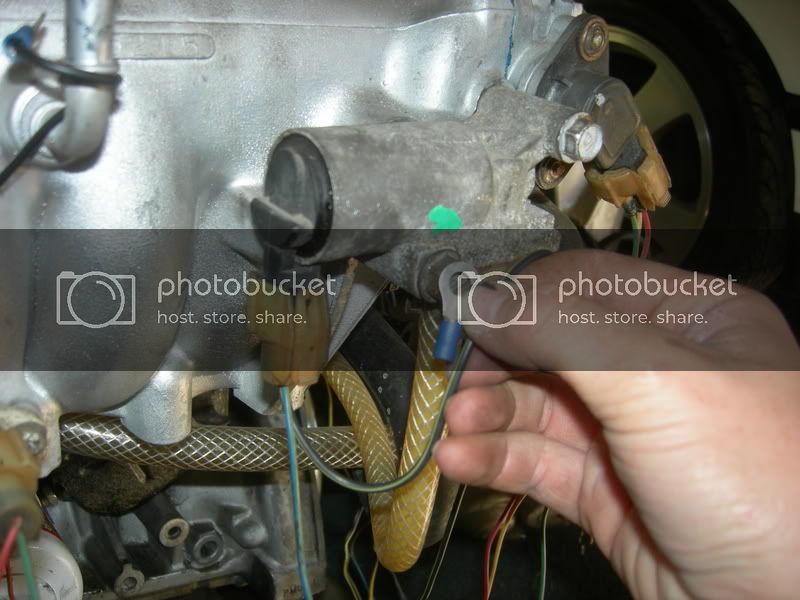

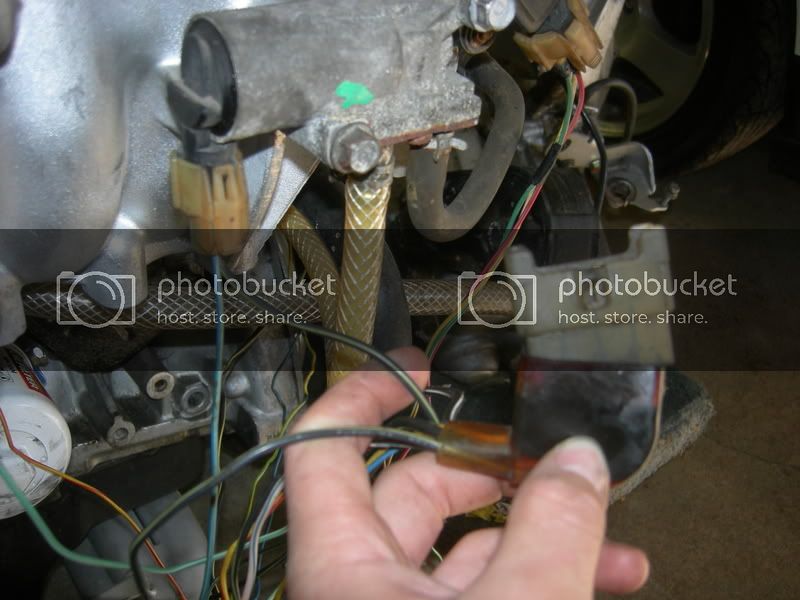

I do Have 1 question, though. I read somewhere that the injectors are definitely separated from the rest of the harness.... Thats true except for the 1 wire that goes to the IACV. (the Blue one). Thats all fine and dandy, but I want it to be clean. My question is: Does this black wire coming from the IACV get grounded or does it carry a signal to the ECU? If it's grounded, Sweet!... But idk if it is... Anyone know?
You can see it dangleing here...
And I held it up, here...
And this is the black one. It goes into this 90* connection.
wondering if I can ground it. If so, I'd do this >>
Any help would be greatly appreciated!
