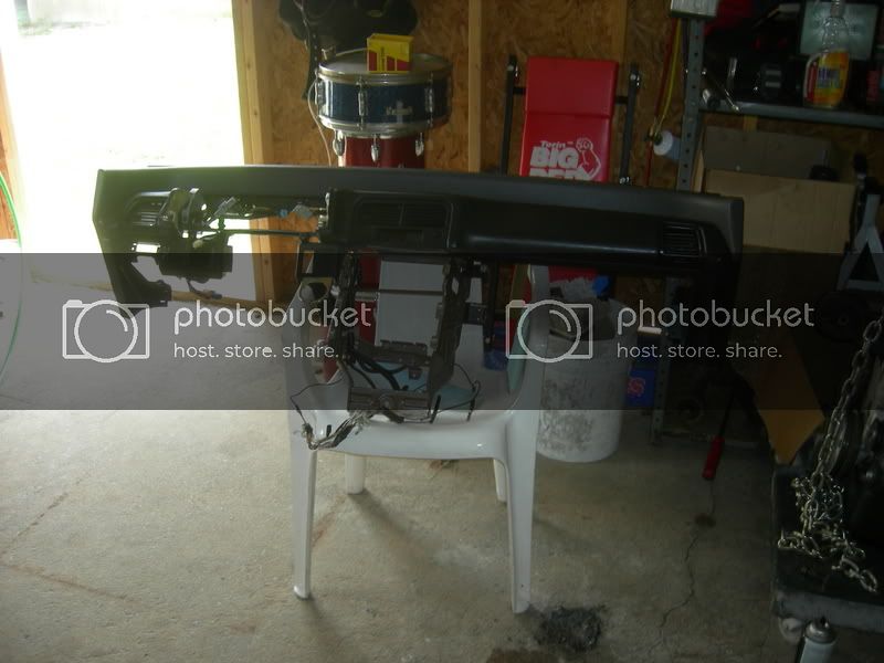

Heres the pics I promised!

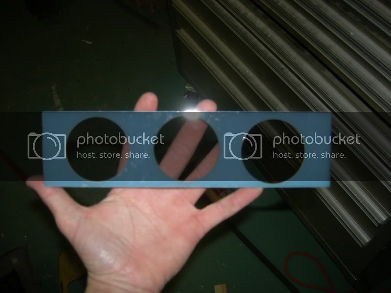

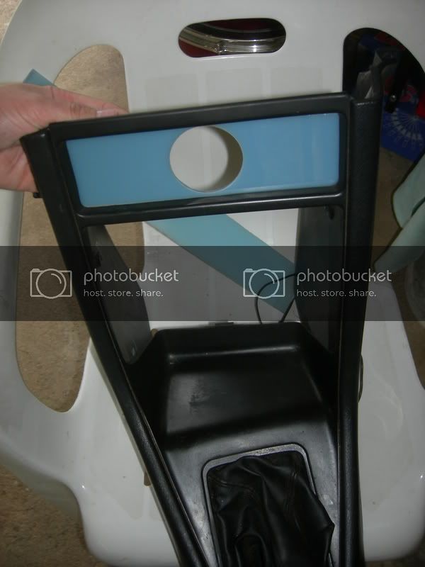

Got my gauge bezel holder thingy almost done; Just gotta paint it and attach it somehow. (probably just use some super glue and something else ghetto.)
Boost > Oil > Voltage or Water. Probably voltage.

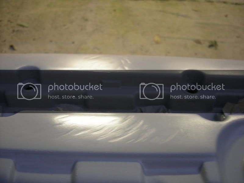

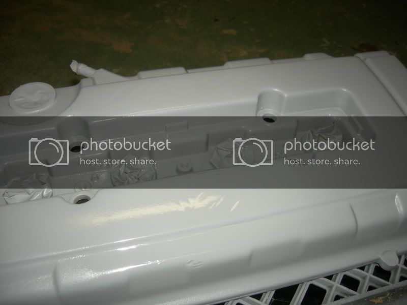

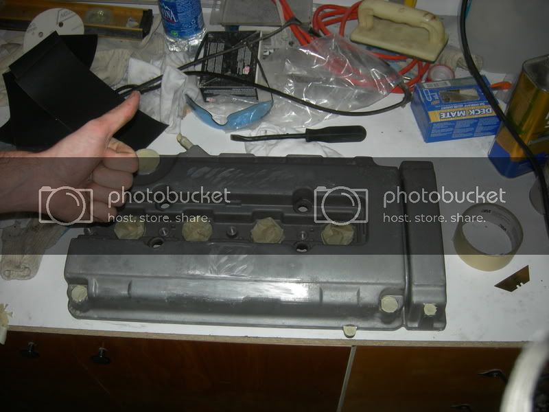

Then I finished masking off the VC and did a little priming. (4 coats to be exact. laid it on extra thick in the middle area.) It's not going to be perfect. I accidently grinded a little too much in a few little places. Maybe a sticker or something can fix that :p
You might actually not even notice it when I get the darker grey on there. idk. I'm not too worried about it.

Looks good! :thumbsup:
So what's the final color going to look like?

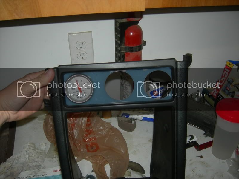

And the gauge setup looks cool too. Are you ditching your head unit though? Or is that space the pocket underneath?
Grey with some gloss in it.
The gauges are in the climate control area. I'll still have my Jamz :)

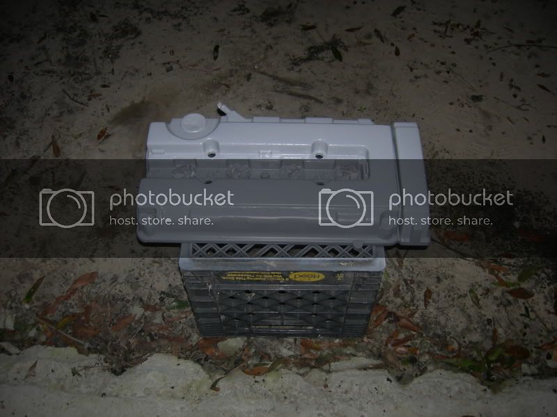

You should do a skim coat of bondo to fill those gouges, tho I'm not sure how bondo would hold up to the heat.
If they're not terribly deep, you can put a thick coat of filler primer on, then block sand til you hit the aluminum around the gouge, and repeat until it's flat.
I will say what my old painting buddy said to me "How hot do you think a black car gets sitting in 110 degree direct sunlight all day long?"
Hope that answers your question. Just use good quality filler.

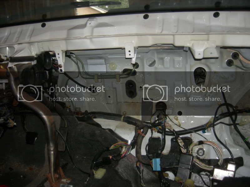

Heres what I got accomplished yesterday:

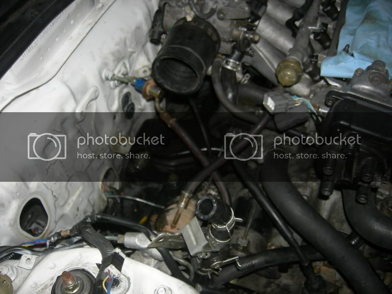

I just plugged the Coolant hoses. I've got to wait until I either 1) get a rubber Cap, and 2) get the Honda Plug for it. (I'll give the part # in a couple days, don't really have time to go find it.)

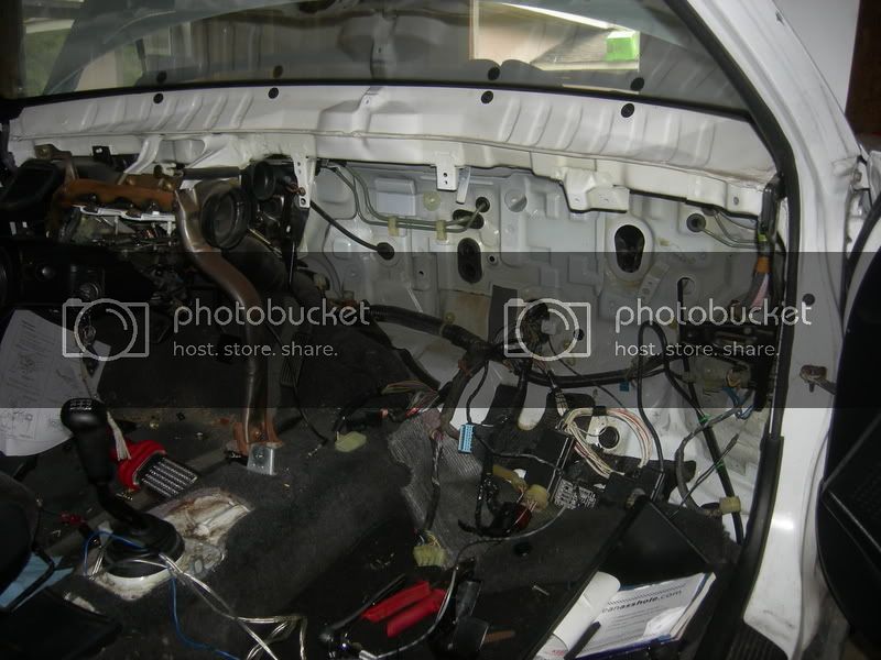

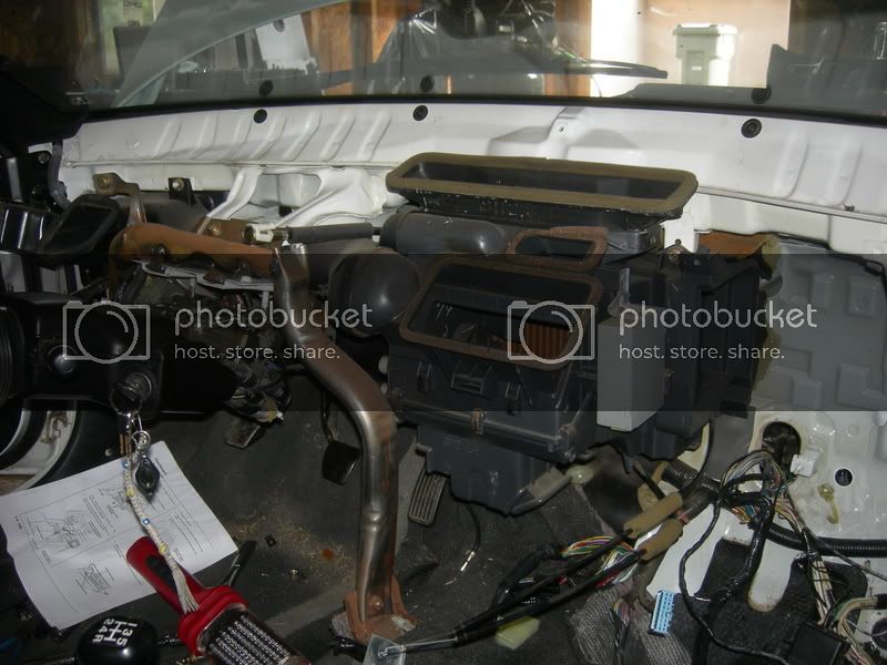

Nice spot for the guages. Can't believe you just gutted all the climate stuff, though. Dayum!
What da hell r u doing Andrew :confused:!!!
Making a track car man. This baby's gonna see Road Atlanta and a few others nearby. :)

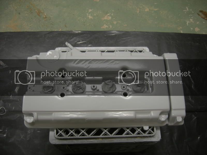

-Put a few coats of the grey paint on the valve cover :thumbsup:
