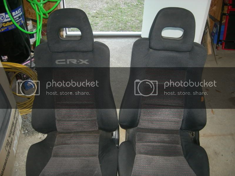

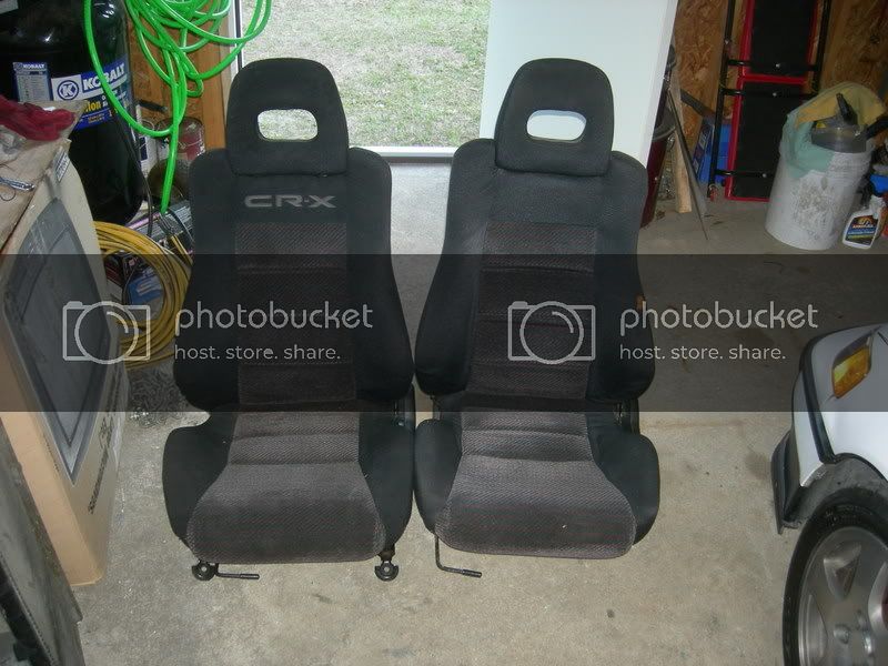

Picked up a JDM Passenger (U.S. Driver) seat from a guy off H-T in Miami. The only reason it's not in my car right now is that I need to switch the entire seat pans. I tried to just switch the rails, but the bolt pattern is different, plus theres no provision(bolt hole) for the Seat Belt Buckle thing to go. :thumbsdown:
MINT condition though! :thumbsup:

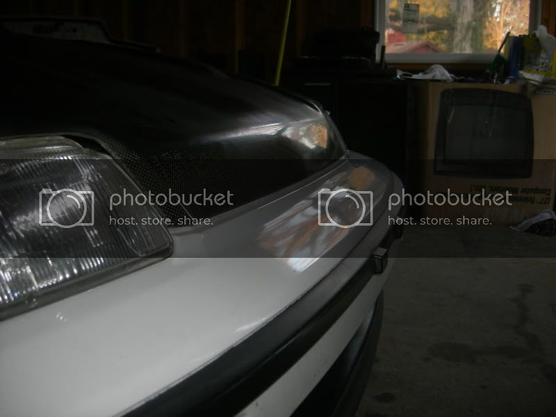

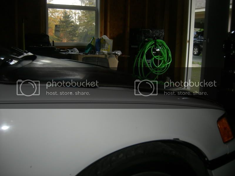

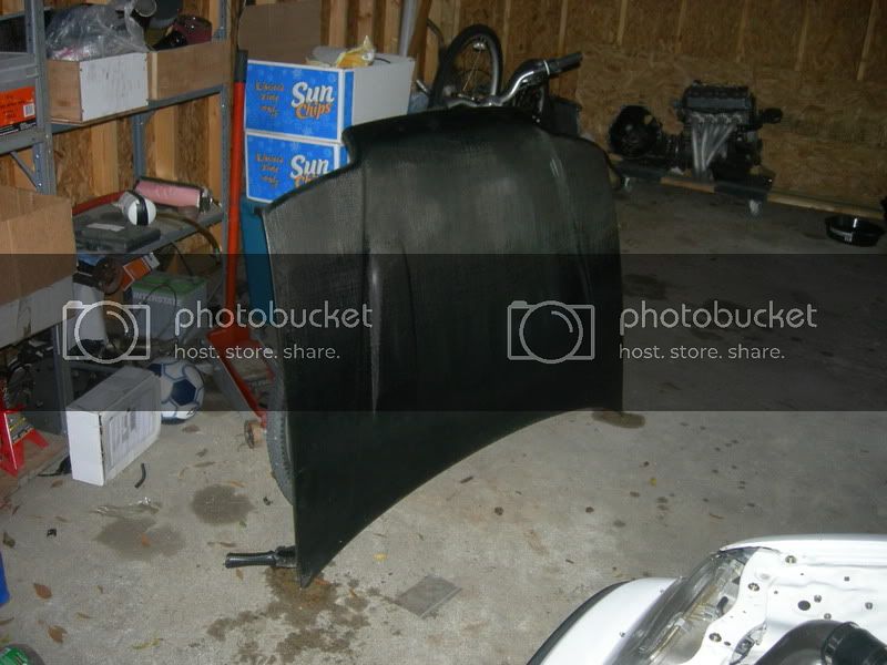

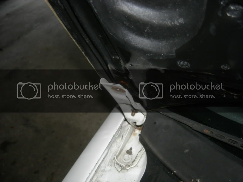

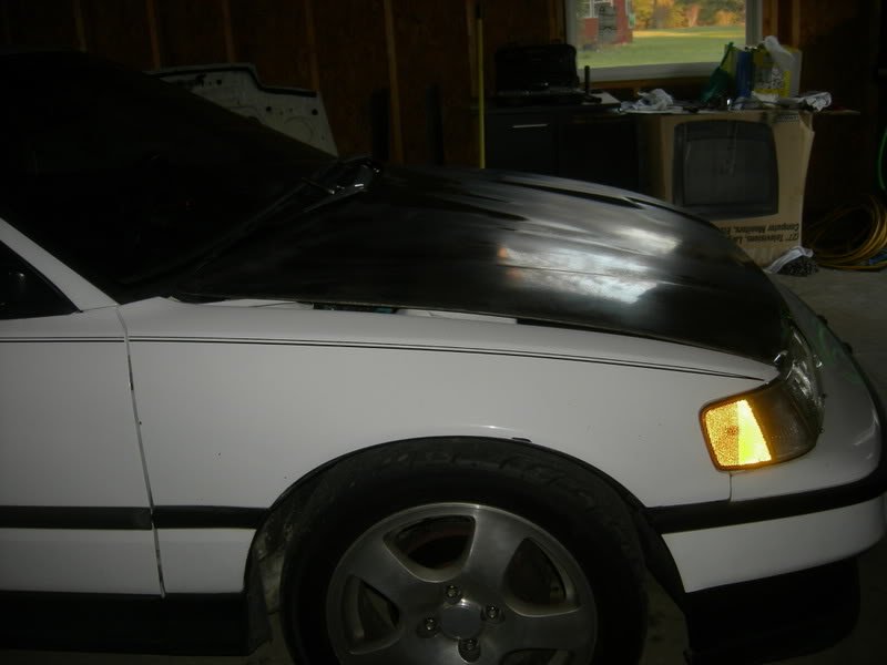

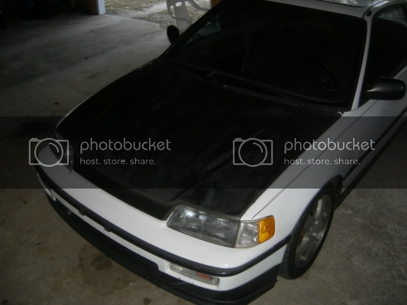

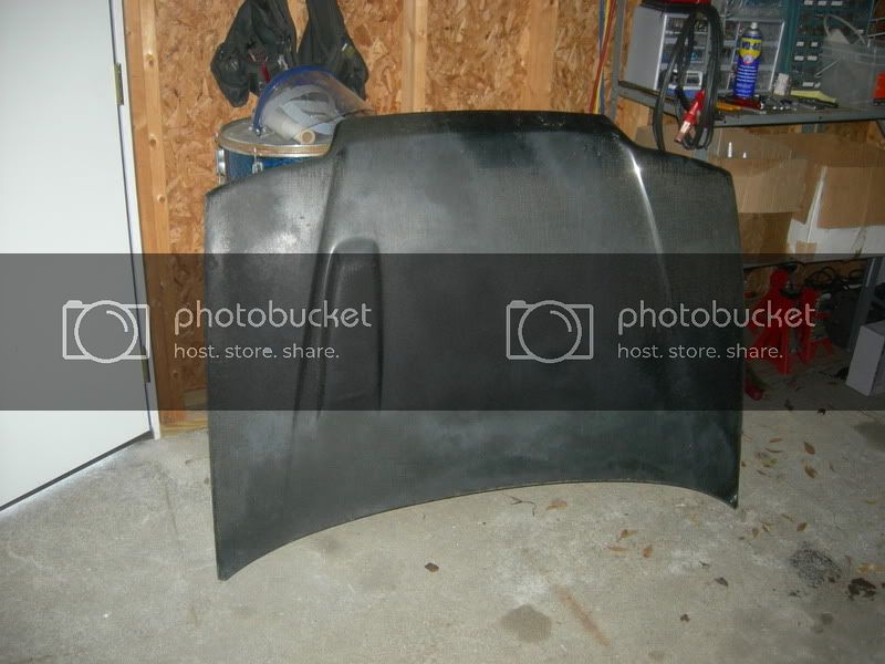

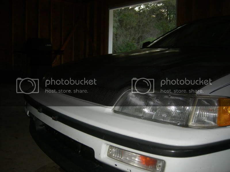

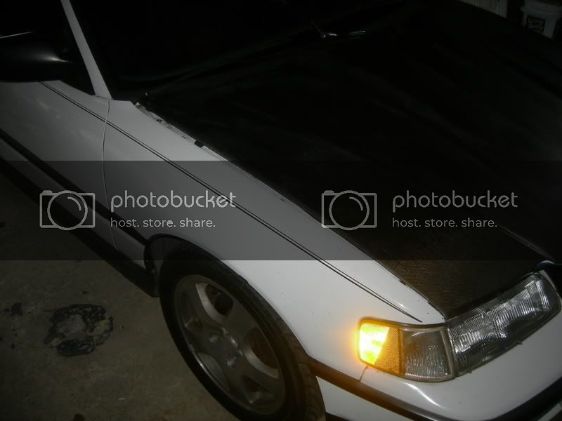

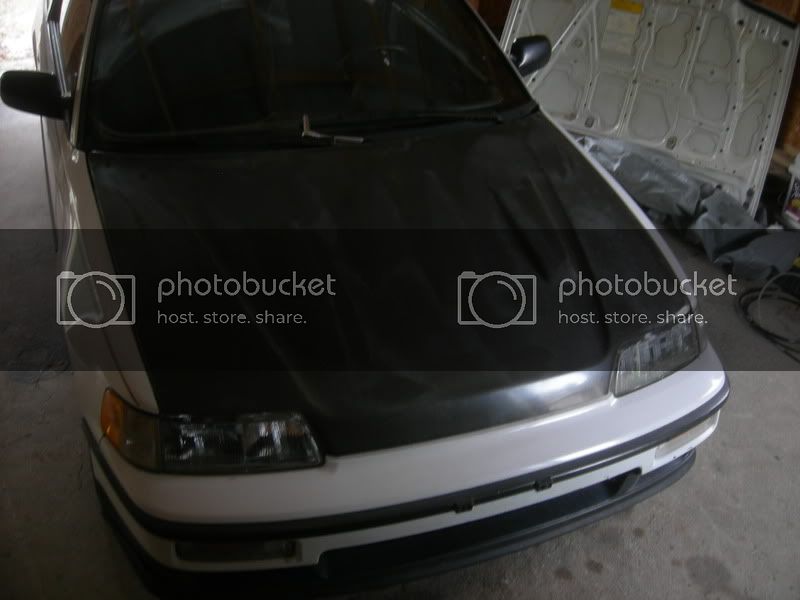

And I just picked up a ZC style Carbon Fiber hood today. It's in pretty rough condition, but it was cheap so I did it anyway. I haven't decided if I want to Re-Clear coat it, or paint it white. Like I said, it's not in the best condition. The bolts are a little rusty and 1 is sheared off (just rusted on and got torqued too much when they took it off type of thing). Plus it's kinda warped (see pics).
Right now, I'm leaning towards NOT using it. but if theres any way I can screw around with it a little bit and get it looking pretty decent, I'll see what I can do.

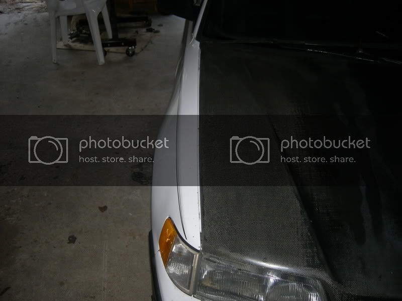

Notice the gap... This side is the worst...

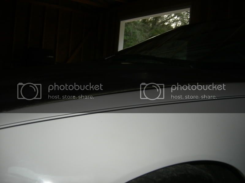

Front is straight
Eww...
Eww...
:huh:
IDK. It's pretty ghetto. I don't want to put it on my car as it is, OF COURSE. But I just want to find out if it's repairable. (the warpage is the main thing I'm concerned about)
What do you guys think?
-Andrew
If you park the car in a hot place and put a cinder block or something heavy like that on the sides then it should go back a little. My friend did that with a cheap nopi hood and it worked. It was bowed up on the sides just like that. Also a good compound a buffing might bring back the shine without any paint work.
Wow. That hood looks like my car does after the body shop screwed me and my insurance company.
Any shop that deals with CF should be able to fix it for you. OR you can do it yourself with steam and some wood.
PS, paint it. Add to the sleeper look.
Thats an interesting idea. I live on FL, so I shouldn't have a problem finding a hot place. I could always steam it, too. We have a steamer. Hmm.... I've got some research to do.

Changing out the pans on the seats sucks BTW. You're gonna have lots of fun!
