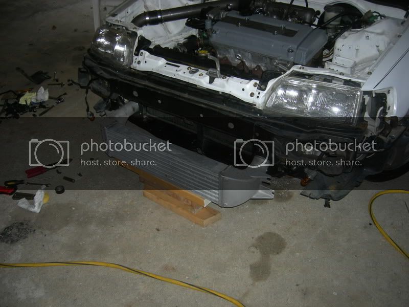

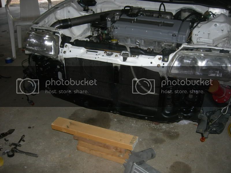

Test fit my IC just for kicks. I actually think it would work! with only minor modifications to my front end.

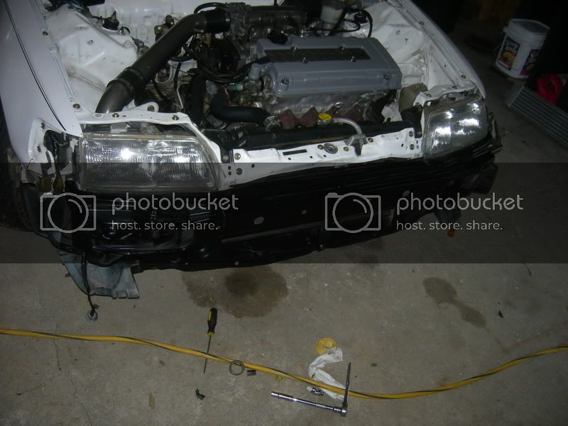

Painted the front

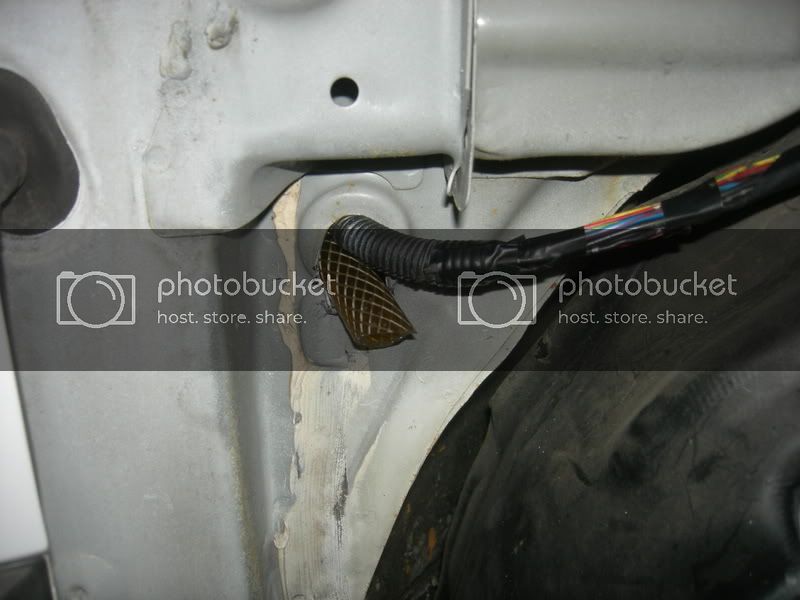

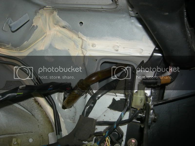

Got my sun-roof drain going to the right place( namely OUTSIDE the car)

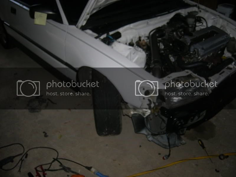

Put the fender back on
And did some more touchup paint on the bumper support and stuff.

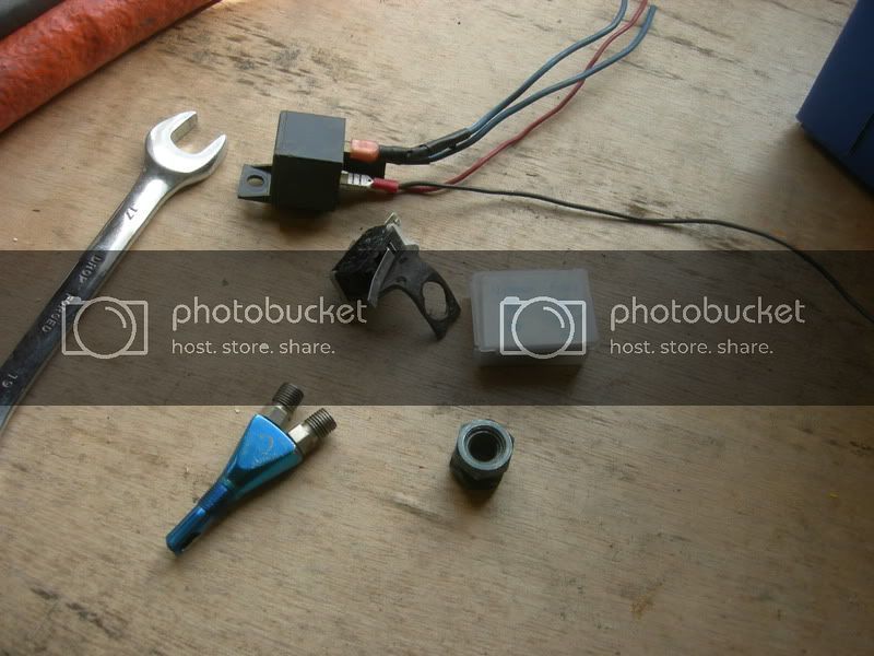

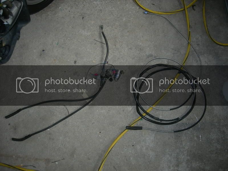

Then I picked up my Civic and delivered it to my buddy. Traded him the civic shell for a complete Wet Kit (NOS) and $200. Needs a new fuel solenoid.
I'm thinking of dropping the D16 in with that new headgasket(making my Compression 10:1) and spraying it.
thoughts?
did i miss something? What the intercooler for?
Ohh and that D should be able to handle some nitrous. Just make sure you get it tuned for maximum HP. i can see it handling a 100 shot.
Big chris was running a 75 dry shot on his single cam and it held up for a long time
Abel I was just seeing if it would work. I'll hang on to it. Who knows, I might want to try some turbo Action sooner or later.
Terrance, Yeah, i think it is. :thumbsup:
If you're having trouble with that IC I Have a johnny racer one that fits REALLY well. IT's not as deep, but it's longer. The mounts truly hide it under the bumper skin.
It's pretty trick. Lemme know if you're interested in a trade or something.
