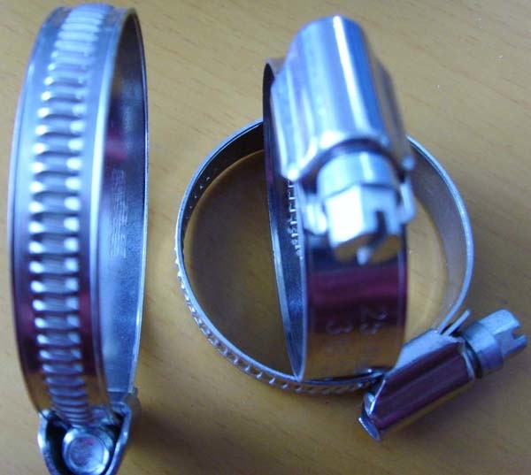

Anyone think that I could get away with zip-ties in leu of hose clamps?
EDIT: Yes, I'm serious. The fat kind. Like the kind you use on A/C Ducting in houses. Yeah, I have been browsing HMT waaaaaaaaaaaaaaay too much.
but since I'm going to be using this turbo for longer than I thought (long story, don't want to go into it publicly) I will have to.
It deals with some local person wanting to try to rip me off for some parts I needed to sell to get the money to buy a STi turbo.
I dont know about using zip-ties for charge piping, even the big ones, unless you can get them really tight I think the would cause you some boost leak problems.
yeah, that's what I was thinking too.
I'll just get some worm-gear clamps today.
There are two different kinds, make sure you get the ones with the holes in them, not the ones that use little bumps. I dont know if you know exactly what Im trying to say but you want the ones that have the holes.
DONT use this style, they dont clamp very well.
You want this kind, they work way better. :thumbsup:
And these would be by far the best choice, but I dont see you having any problems with the second one.
I've got some T-Clamps, but those are only being used on the 2" turbo->intercooler circut.
Those clamps that you said not to use, I've got two of them for the blow off valve, they should be fine on it though.
Thanks for the info, I'll see if I can find them at the store here.
