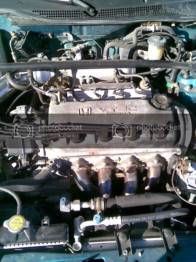

B16 nice Del Sol track car you have there. Sorry to see you have had so much trouble with the B18C block. We all have been threw issues like this. Mine was a PR3 head that was cursed. Had stripped cam cap threads, needed full valve job, oil seals and guides. When I got it back from the shop the valves where worse then when I gave it to them. They f@#%ked up the valve seats and ruined the head by the end of it and would not replace it. It was going to cost me $500 to fix the head at a real shop. So I trashed the head and got another. IMO you should just get a new block either another B18C, B18C5 or do a mild build on a B18C1. Wish I still had my Del Sol, it was going to be my track car. But I had to sell it, it did donate some parts to my EJ though :). Loved the Del Sol handled like a go cart, just needed B18 power.

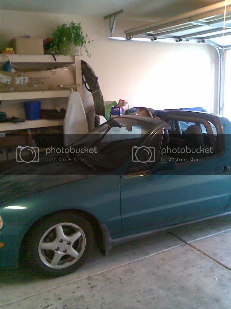

My Del Sol Si
Intake Greddy header and cat back, hasport mounts, eibach sportlines and GR2's (now on my EJ) eibach sway bars and full roll cage.
Del So and my EJ
