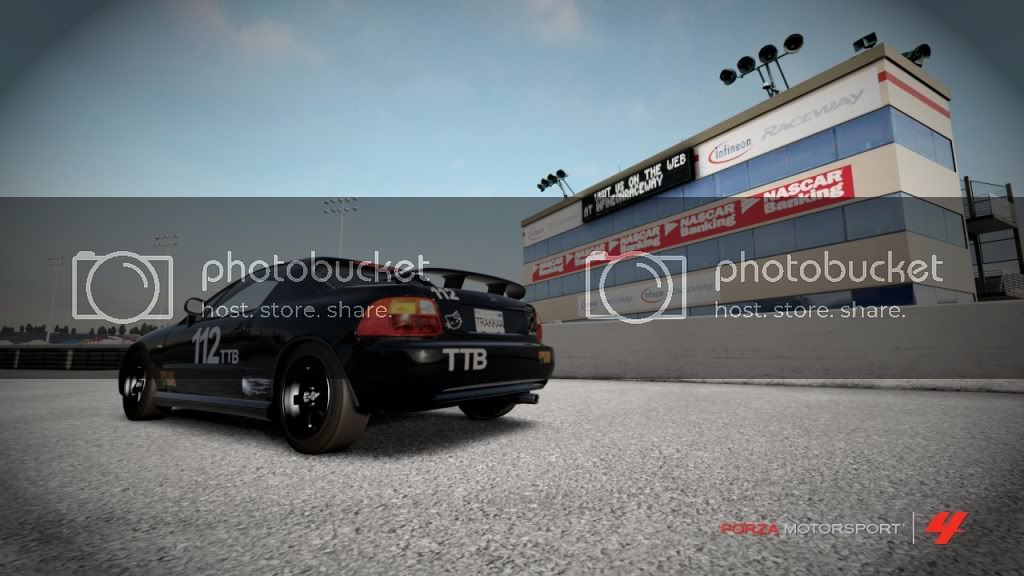

lol.. i just found some pre-made decals from other people.. ie: license plate, hello kitty, nurburg
and yea, i picked Infineon because i knew you'd enjoy that.. lol.. right up your alley
not done w/ it.. few more decals to add
