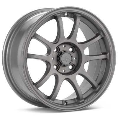

the next thing i want to do is replace the wheels. im going to go with some 15x7" wheels but not sure which. rota slipstreams are an option, and probably the best for a track car since they are light and cheap, but im not sure, they are pretty generic looking (again, racecar, i know lol) but im still undecided. opinions?

15x7 Enkei RPF1 then Falken Azeins.

Rpf1s would be ideal. But since it has the inner radius of a 14" wheel. I'm worried that they won't clear my brake setup. I haven't priced them out in a while either, how much are they?

if youre going for cheap and light then rotas seem to be a decent option, but ive also heard some horror stories about them. and like you said its a track car, so that might not be a great idea.

i also got some new(er) front fenders. they arent perfect, but are MUCH better than my current fenders. im also going up to PA on saturday to pick up some new doors. the main reson for replacing the fenders and doors is to get rid of the rust. mine are in pretty bad shape. im planing on just cleaning the fenders up, rolling them and the rears, and getting a MAACO job on the whole car. its a track car so it doesnt have to be perfect, but nothing wrong with cleaning up the looks while im at it.
these wheels will be next on the list. 15x7 +42, 12.8lbs and best of all $89/ea. :D
