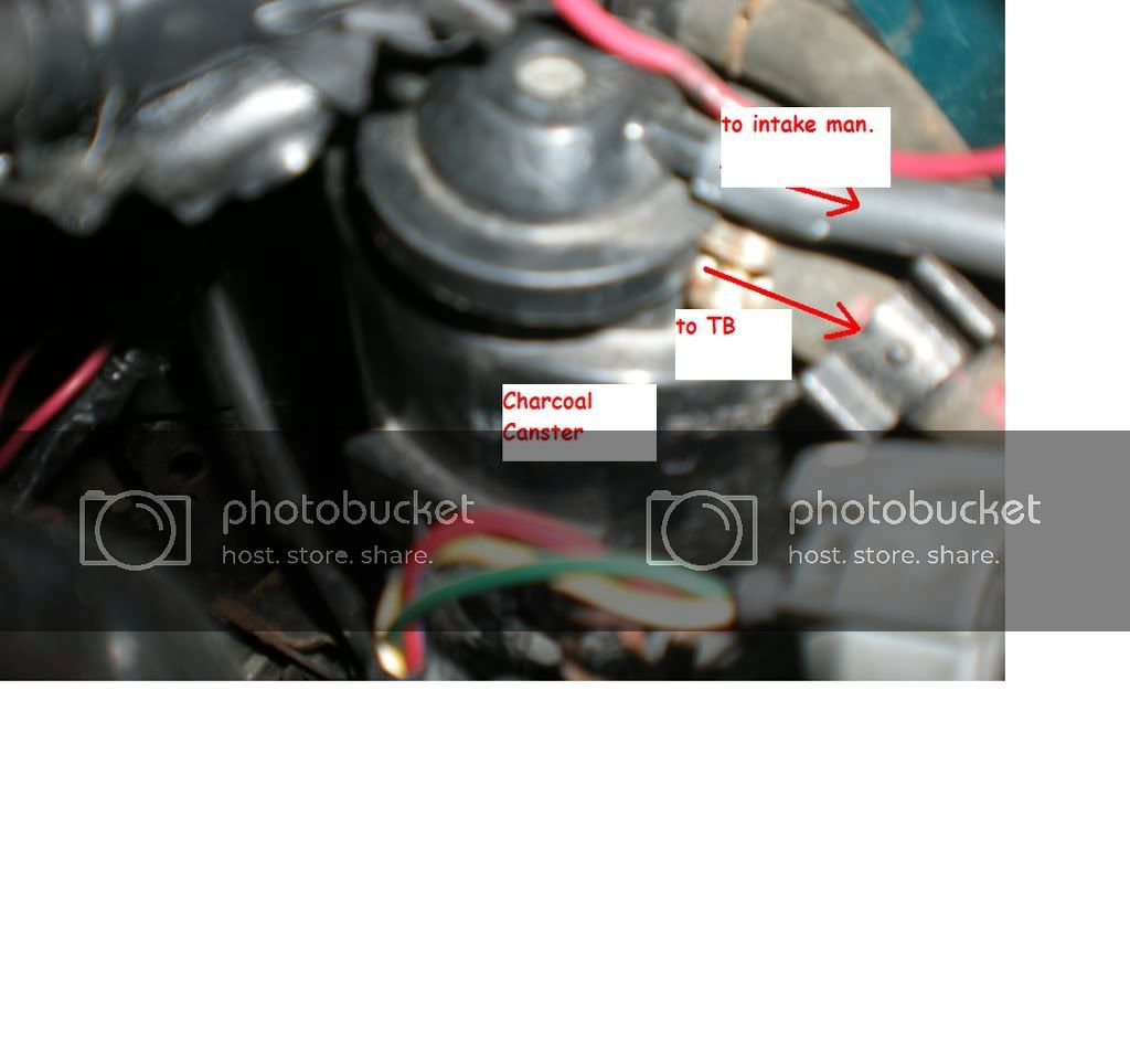

The charcoal canister is a black cylindrical looking thing below the fuel filter and mounted on the firewall. It has a bunch of lines going in and out

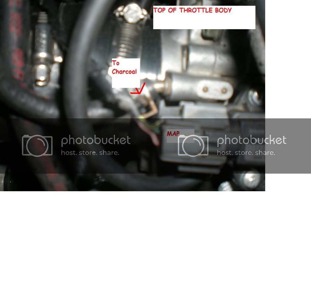

So your saying that the tb doesn't have any vacuum ports? Thats strange. Take a closeup pic or something that would help a ton.
If you're talking about a cylinder below the fuel filter then mine's brown and there's a loose line next to it that was like that before I even bought the car but it drove fine without it I mean it points up and it's not long enough to reach anything. About the thickness of the fuel feed.
And yea the TB doesn't have any vacuum ports I'll take a pic tomorrow morning to show you right before I just throw on my old intake manifold because you've got me semi-convinced now that the MAP sensor's not reading vacuum and that that's the problem.
I'll get you a pic of that mysterious line too.
2. I am assuming that your jdm engine has the map sensor on the top of the throttle body. In this case, after the new engine is in, take that vacuum line off the old map sensor and run it to the vacuum port on the top of the throttle body inlet. This is how the new map sensor gets its vacuum reading.
Soooo...alright...since I'm obviously going to need to at least reuse my old throttle body, which doesn't have an MAP sensor on it, does that mean I can just use the old sensor (or move the new sensor since it's newer) at the firewall and not have to move those vacuum lines?
EDIT: Alright waiting for pics thanks so much.
if you use the old tb, then use the firewall mounted map that came with the car.
I still find it hard to believe that the throttle body doesnt have any vacuum ports. Did it come with the map sensor mounted on it? If so, there has to be a vacuum port.
Yea the map sensor was mounted on it and if there is a vacuum port maybe I'm forgetting but I really don't think it has one on it either way there IS a vacuum port on the old tb that's not on the new one I dunno if there's 2 of them tho.
