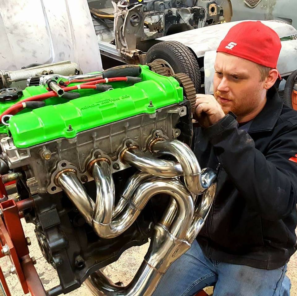

As requested, here are a few pics. Videos are below.
The first couple are from a few years ago after I completed the auto-to-manual swap, full suspension and brake upgrade.
I took a close-up shot if the ALT Lite-Speed 16" rims and the 11.1" Prelude SR-V rotors and ITR calipers (custom painted) with Hawk HP+ in the front and HPS in the rear. I'm using Russell S/S braided brake lines and an ITR 1" master cylinder. The brake fluid is Amsoil high temp race fluid.
Here's the most recent dyno graph. I snapped a pic from the tuner's screen. 158whp and 116wtrq from an NA d16z6. This year is superimposed over last year. You can see the increase in power in the mid-range.
Engine bay.
The combustion chamber of cylinder 2 after the exhaust valve snapped at the neck.
The massive hole in piston #2. The valve is actually in the hole.
The car in action at the track. I use 15" Rotas with BF Goodrich Rival S tires.

I've been a loyal d-series fan for 12 years. I set myself a goal and I achieved it. It just didn't last long... the motor was over-built and a fatal error (keeping OEM valves vs aftermarket) was the cause.
It's time for a change. Time for a new challenge. A few friends are glad to see me finally swap to a B.
