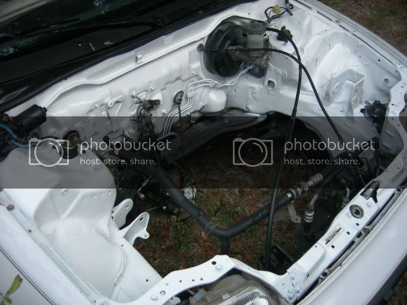

FYI, you could have just run a 4ga from back to front, then used a power distribution block in the front of the car somewhere.
Yeah, I know I could have split it, but I didn't feel like it. I would have taken a couple more dollars and I wanted to keep my cash. Thanks for the idea though.
And vtecsir1, Thanks for the comment, but I'm in college for Aviation Mech, and we've covered everything there is to know about AC and DC circuits. The fact is, yes you cause slightly more resistance by 1. lengthening the wires, and 2. at the solder points(even though soldering is one of the best ways to do it., however, it wouldn't affect such a simple, small circuit as headlight wiring, especially when you only lengthen them less than a foot....
And it's just common sense-
If it did... don't you think more guys who have wiretucks will have problems?
Thanks for the comment, but rest assured there isnt anything wrong with lengthening a couple wires.

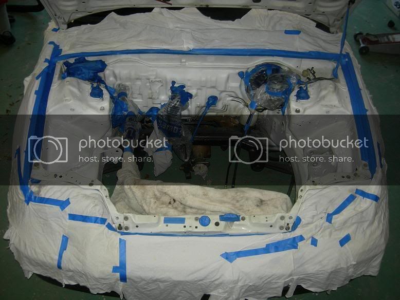

Are those rags you are using to mask everythign off!?!?!
And FYI, NHRA States a battery box when located in the trunk must have:
A. Be secured by at least two 3/16" bolts through the floor of the car.
B. Have a battery cutoff switch on the outside
C. If it is a standard battery, must be located inside of an NHRA Approved Sealed Battery Box. (Not required for Optimas and such). And those battery boxes usually have a vent tube that runs outside the car.
Yeah it's a mixture of rags, shopping bags, and tape. Thats how I roll...
Thanks for the battery information, but I'm not done installing it... it's just sitting there right now. I've just been slacking on it.. I've been focusing on the engine bay.
Thanks again though.
-Andrew

Nice mask job!
Thanks
I've still got to mask off the Xmember's, but then I'll spray it.
I picked up a couple cans of Acryllic Laquer today(white), and since I went with laquer I won't even bother with clearcoat.... since it's got a semi-clear finish anyway.
I'll be out of town this weekend, but plan on spraying the bay Monday morning.

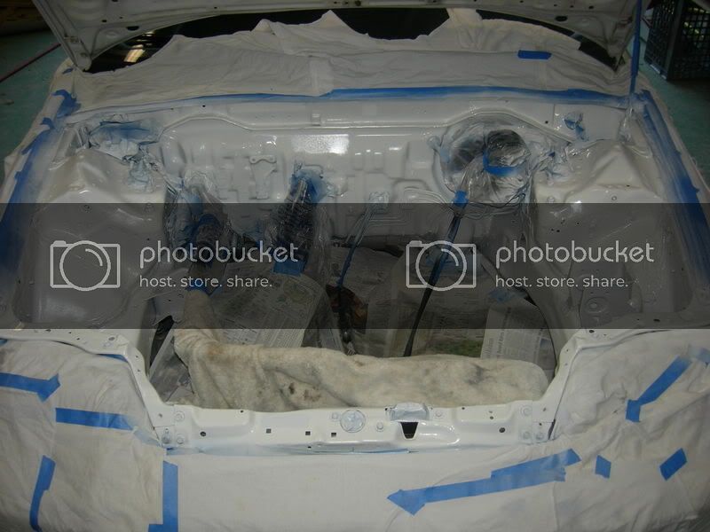

Update 11/2:
Painted the engine bay with white Acrylic Laquer, so it's got a nice, semi-glossy finish. It turned out great!

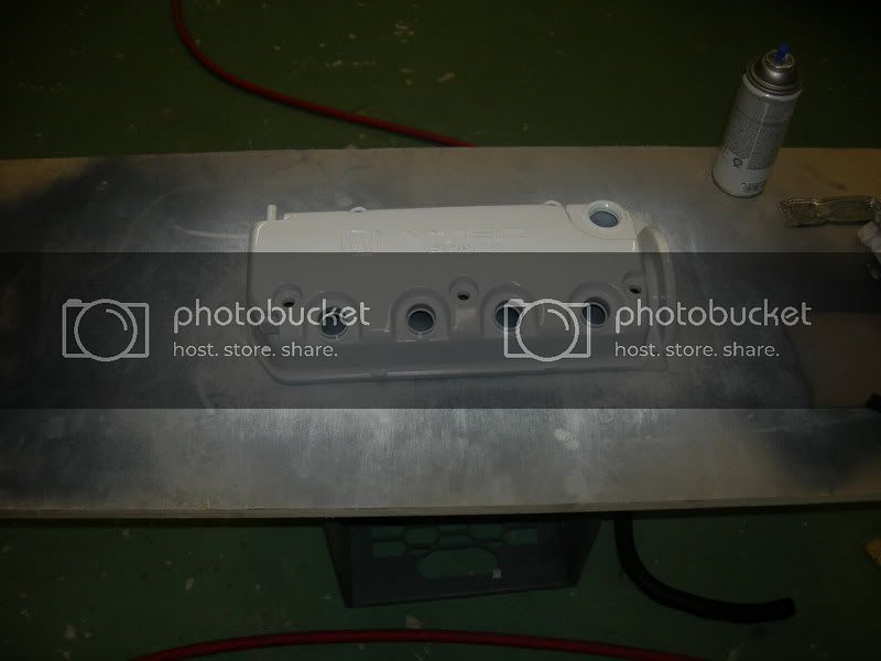

And I also painted my valve cover with the same stuff:
(primered it, wet sand, then paint.)
It looks a little better in person. Maybe when it's on the motor, in the car will you be able to tell it looks so good.
Oh, and I have yet to grind off the lettering. I'll post up another pic once i do.
