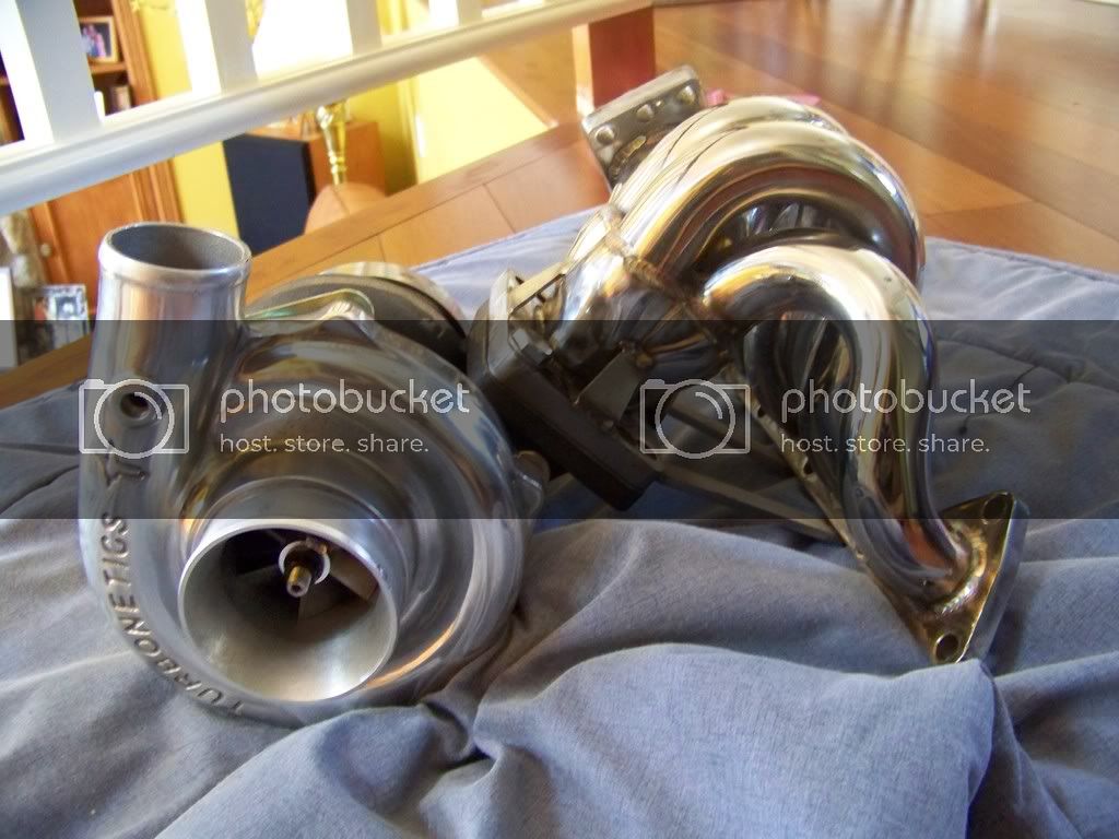

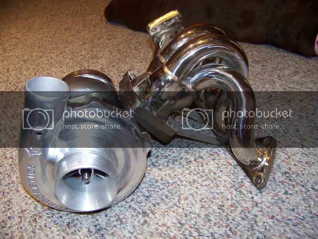

Heres some more pics. Also came across the pic of my hatch at the bottom.. and brought a tear to my eye.. lol I never realized that my car was actually pretty clean.. :p

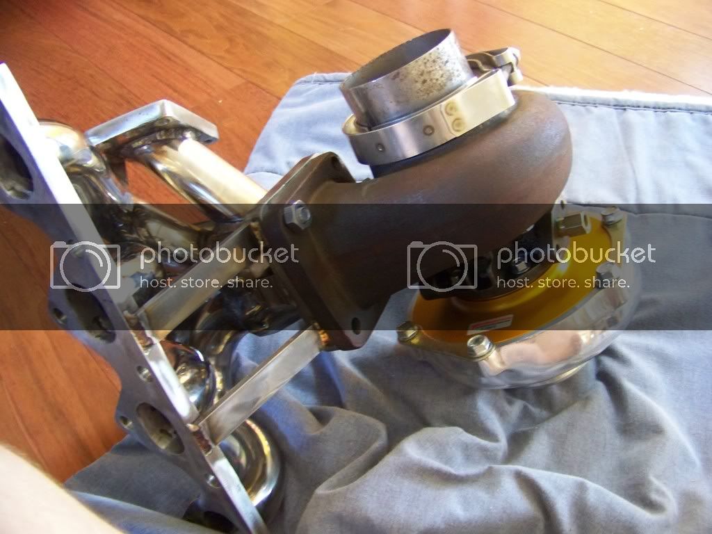

Gay ass ebay mani is all I have for now. I think I'm going to have a buddy of mine that owns a machine shop do some work to it, move wastegate location, check the welds, add more supports, etc. Then it'll be ok for awhile.

Honestly, I'd buy a new manifold now, and see how the ssautochrome one holds up. Then if the ssautochrome manifold works for you, you can sell the new manifold, for minimal losses. But, srsly. Those manifolds aren't even equal length, much less stepped......
Yeah, I'm considering a new manifold right now. Just because I know the design is shotty. I got it for free, though. So I can't really complain. I'm thinking I will probably just get the ssautochrome mani works for a bit, and if it starts to show signs of cracking or it doesn't make any power, I'll yank it and buy a new mani. Anyone have suggestions for a reasonable t4 manifold somewhere on the net? It needs to be equal length, and of decent quality.

Are you sure you want to take a chance on the SS manifold, Matt? The things they make are known to be CRAP!
As long as it's braced, it will function just fine. It won't make as much power as an equal length ramhorn, but it will work better than a log as long as it doesn't crack or drop weld boogers through his turbine wheel. Seriously, have a look inside the runners, make sure there's nothing sticking out that might break off and destroy that turbo. It might be a good idea to heat cycle that thing a few times before putting the snail on.

And yes, I am re-considering the manifold. Its the only weak part of the turbo system as of right now.
Klyph- Thanks for the tip man. I didn't even think about that. But now I'm thinking I'll try that. I have checked inside the runners, all appears to be well. But I cant really see everywhere so I dunno what to do about that.
